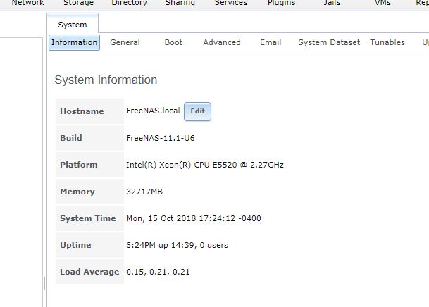

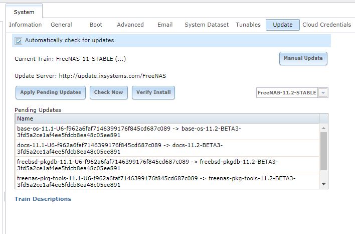

Ok, I have signed onto the "new train" of 11.2-STABLE and have restarted just like it told me to right after it downloaded it. Nothing happened. It restarts and just states waiting to apply changes. No matter what I do, 11.2 does not show up on the boot screen or anything. Am I missing something? Isn't it as easy as "select new train" and then apply updates...it downs and installs and I reboot? I'm thoroughly confused at this. Anyone else have this issue or know what I am doing wrong? I really want to get to 11.2 as PLEX plugin for 11.1 just flat out doesn't work anymore. Will NOT start and is overwhelmingly unsatisfactory. ANY AND ALL HELP WOULD BE FABULOUS! Thank you in advance!

11.2 is still in BETA. The naming is based on the FreeBSD 11.2-STABLE. We all know this was a bad choice on iXsystems part. They know it too now. Look into setting up your own Plex iocage based jail. You can have it fully updated. Its may be a bit more work but if you follow the guides it should not be to hard.

Did you actually press the 'apply pending update' button? All you have described is just downloading the update on the new train, but it won't apply it until you tell it to. If you do apply it, expect half an hour of nothing happening and a couple of reboots - a bit like Windows. Apologies if I am talking nonsense.

Yeah, that was NOT my experience. I did the "apply updates" and then it said it would install upon rebooting. It just waited for me to reboot. I waited a day...it did nothing.

No...no appologies needed. It had the updates applied. I hit it. It just asked me to reboot...I did...it did nothing. In the boot options, it didn't even show 11.2. Just the original, default and my current running version like normal. Surprised me for sure.
