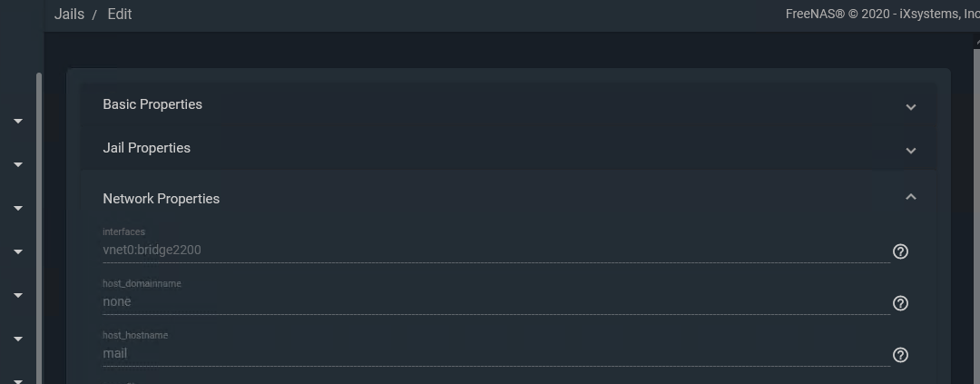

Update was ok in general.
FreeNAS use lagg, VLANs, Jails over VLAN, VM over VLAN.
On Jails: NextCloud, MailServer (Dovecot,. Postfix, RoundCube)
After update to TrueNAS jail version OS leaved on 11.X version.
Detected problem:
  • user can't sent email with attachments: session closed
  • user can't store to IMAP folder sent emails : connection closed
  • NextCloud client can't sync files: process stop at 112K.
  • WebMail RoundCube server can't save attachments.
MTU unchanged, 1500 by default.
Jail have checked DHCP, VNET, BFD, allow_raw_sockets, vnet_default_interface - vnet:bridge2200
System inerface bridge2200 have member VLAN2200 interface.
After return to previous boot snapshot with FreeNAS 11.3, all now work perfectly.
How detect problem ?
On TrueNAS 12 better, want to back to 12 but after resolve troubles:)
