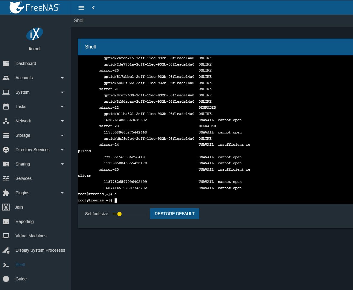

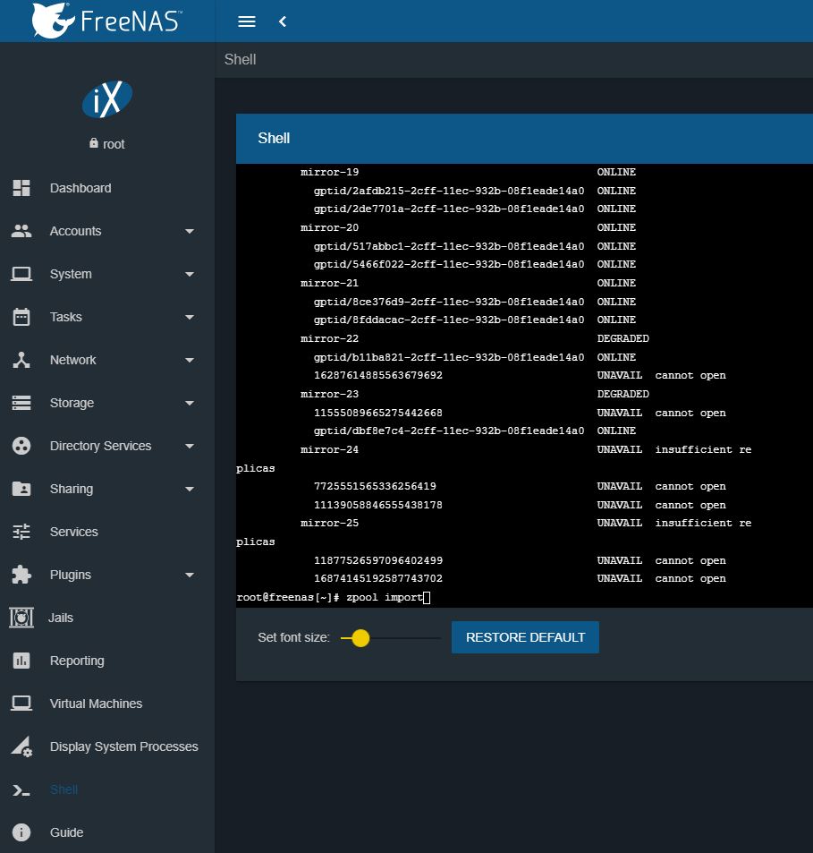

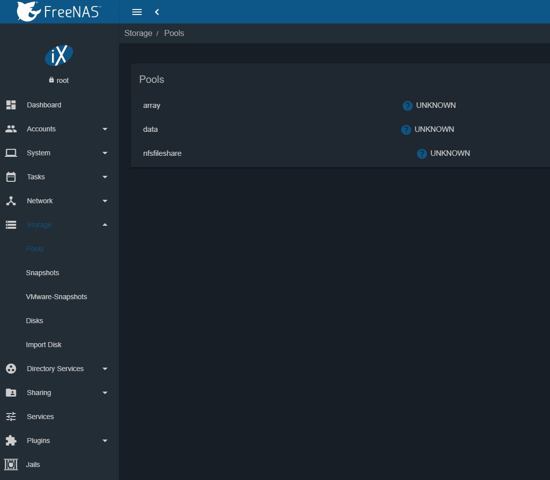

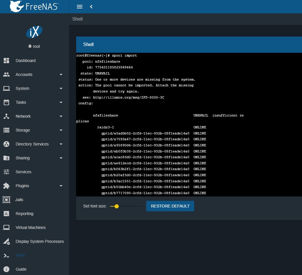

Dear Team,
Firstly, i'm not familiar with FreeNAS and need your assistance ASAP as there is a big issue in our system.
It seems that Pools are not active and when i want to import pools with zpool import commandç i have seen some mirrors are unavailable and has Unsufficient Replicas Error.
I really need your assistance. I have attached a screenshot of shell. Sorry i don't even know how to copy the codes from Shell. :oops:
Ver: FreeNAS-11.2-U7
Please ask me if you need to have further information.

First - do you have a backup?
Other than that I can't help you as I have no idea what hardware you have (other than a boatload of disks)
However as you have lost several disks at once I would be looking at cabling / power / backplanes rather than disk failure (not that several disks can't fail at once)

The action required here is simple... you must reconnect at least one drive each from mirrors 24 and 25 or you won't be getting anything back without a recovery tool (and even with a tool, only some of it would be recoverable).
Your pool is a very odd structure. One very wide RAIDZ3 VDEV and 7 mirrors in the same pool... are those mirrors special VDEVs?

My suspicion, based on very little evidence is that the pool started as a wide pool and its been expanded by mirrors over time. This has now come to bite the OP in a big way potentially (I still suspect the issue is his non-existent hardware)
Not much we can help with though as I suspect that the info he has given us is incomplete anyway.

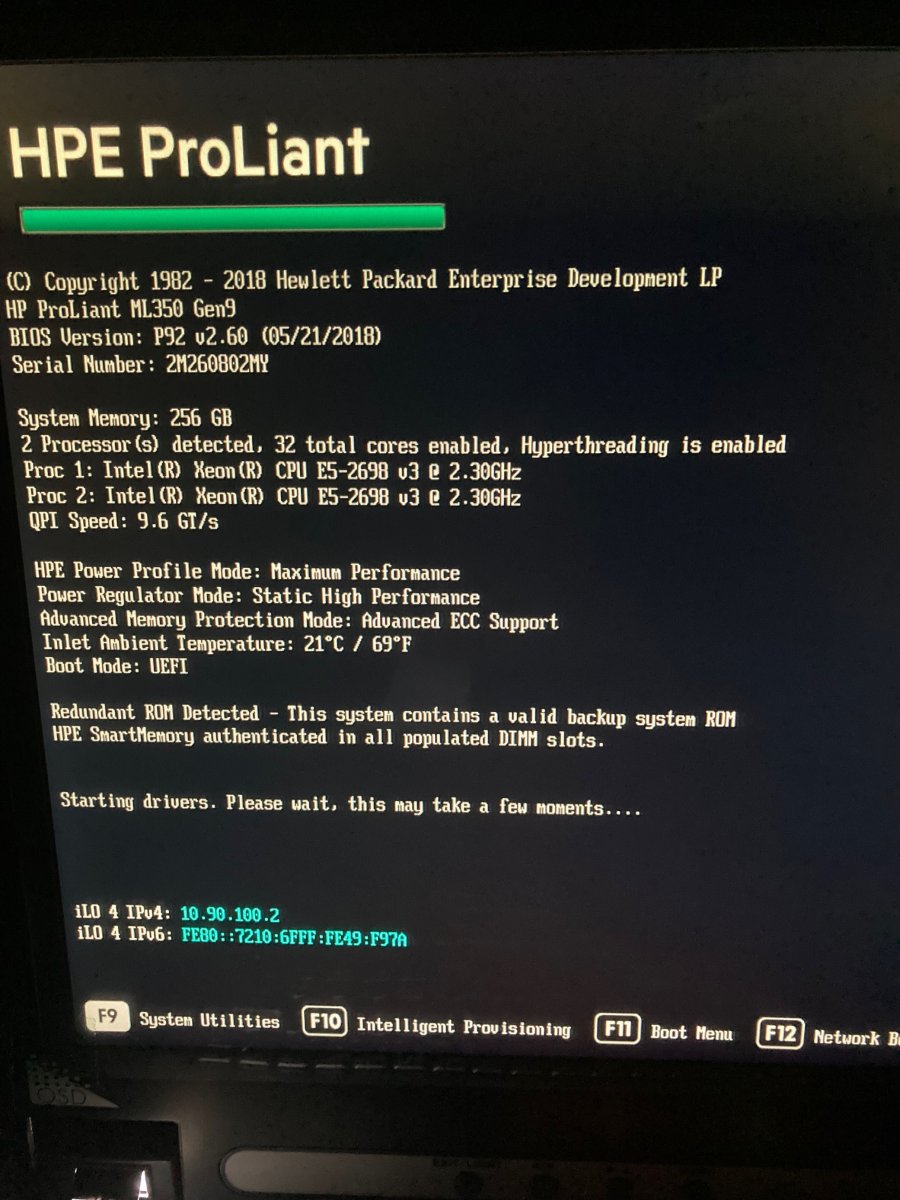

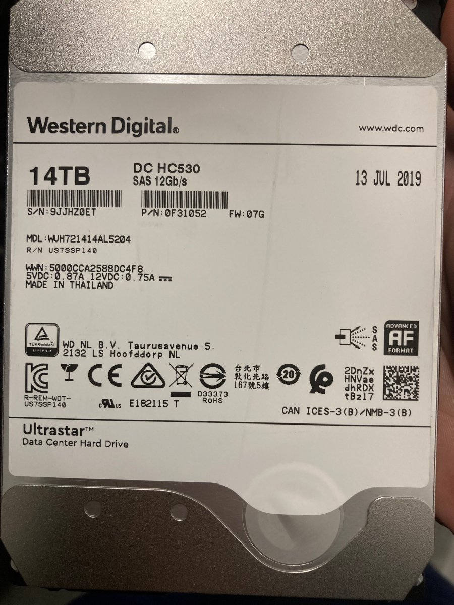

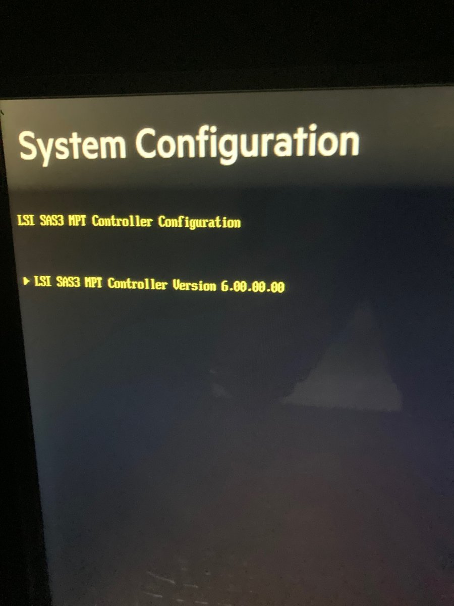

Please see the attachments which give more information about the system.
Server:HP ProLiant ML350 Gen9
Each Disk: 14 TB SAS 12Gb/s - Western Digital
LSI SAS3 MPT Controller
60/60 storage is full so there is no space to move any disk.

That's running MPT SAS3 version 6 firmware? Yikes. Try updating it to version 16, except you probably need some directions on how to do that, hmm. This won't fix any truly broken drives, but maybe we'll luck out and it hasn't actually failed unrecoverably, and maybe it is even just a controller communication issue. There could be value in powering off the host, letting it rest a minute or two, and then powering it back on. On the other hand, sometimes that causes old drives to die... so, well, hard to say which is the right call.
If you can boot into FreeNAS, we need to be able to identify the failed disks and then query them to check their status using smartctl.
There is also the option to run something like solnet-array-test v2, which, if the NAS has Internet connectivity, you can get from the command line with
# fetch ftp://snarchive.sol.net/incoming/solnet-array-test-v2.sh
which is a nondestructive read test shell script designed to work on a large number of drives.

The drives, based on a sample of one aren't that old (2019)
Its difficult to know what to do here given the scale of the issue and the scale of the issue if the data is borked or gets borked during troubleshooting
OP - if you click on storage/disks how many disks can you see vs how many are in the machine. Hopefully the numbers are the same. Also can you see the serial numbers against the disks. You may have to note each serial number against its physical location which should allow location of the "failed" disks and see if there is anything common to the fails.

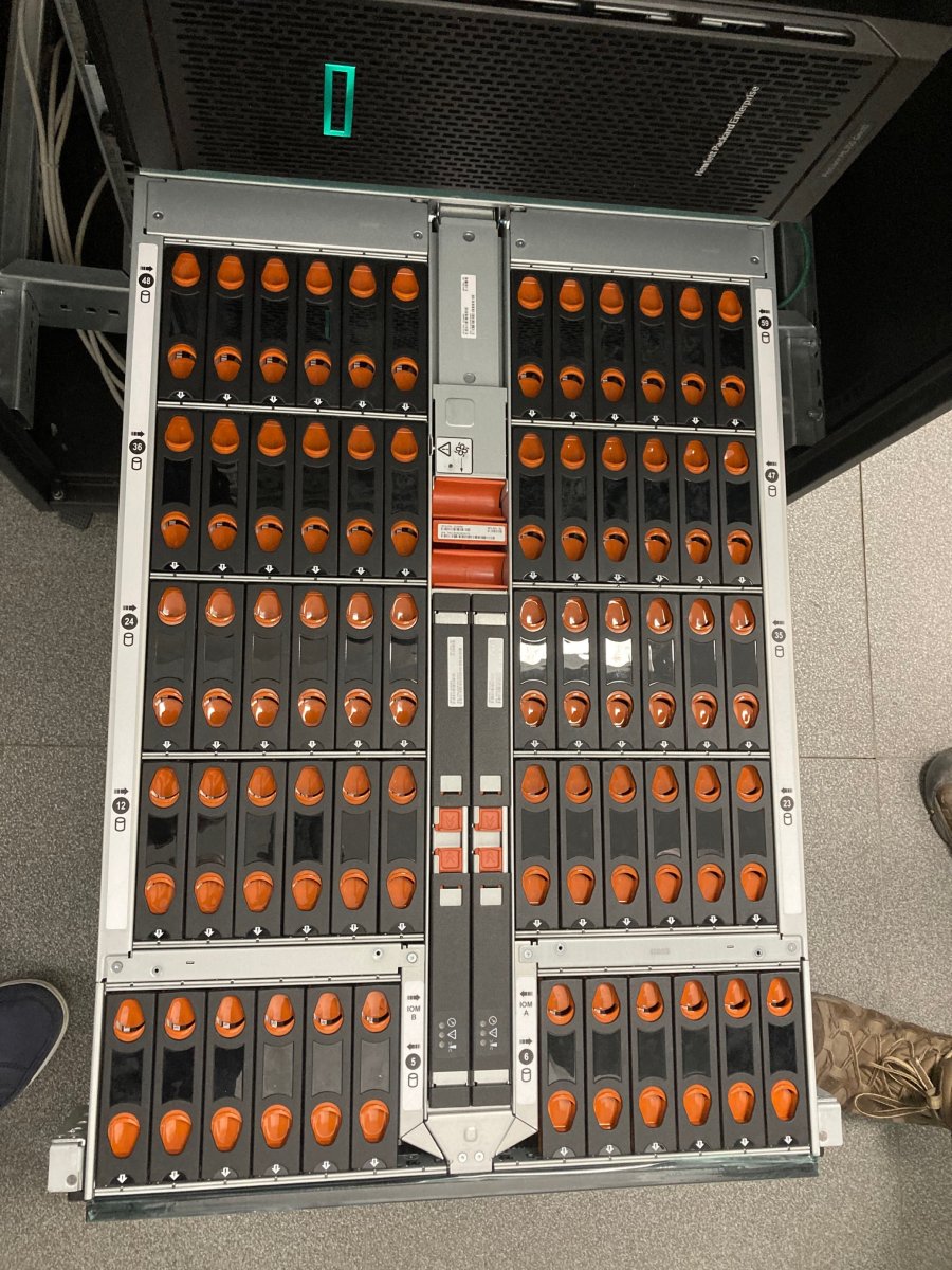

BTW - I am not familiar with the hardware. Is that just a disk shelf with SAS Expander with cabling to the server above that supplies CPU, Memory and NICs or is that the whole thing? If it is just a shelf, how many cables from the HBA to the shelf?
Until I saw that last picture I hadn't got my head around the scale of the problem. I suspect that tracing cabling is going to be difficult.
Is the ML350 Under Maintenance?

I don't think we are looking at seven failed disks. Two mirrors failing at the same time are required to arrive where we are, even if each mirror has a pre existing failure already. Having two simultaneous failures at these specific positions, on top of previous quite specific coincidence required, not very likely. I think we are looking for some common component failure.

I agree but finding it is going to be a ballache though as (for example) I don't see any stickies on that box saying what serial numbers are where
