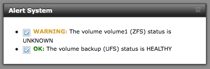

I recently upgraded to 9.2 - no other changes made since then and the system has been running fine for about a week, but today had a yellow blinking light on the Alert icon, after clicking it it told me that the status of volume1 (RaidZ1) is UNKNOWN.

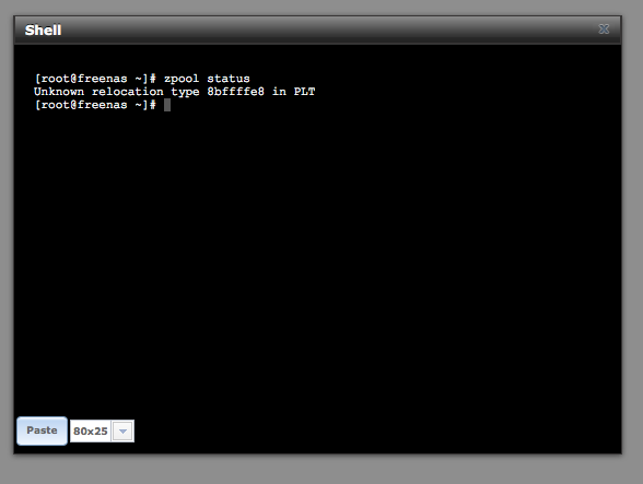

When I dropped into the Shell and typed "zpool status" or "zpool -v volume1" i get the following response each time:
"Unknown relocation type 8bffffe8 in PLT"
I've googled and searched all over the manual but can't figure out what this means. The server and all it's functions seem to running just fine and the system is responsive.

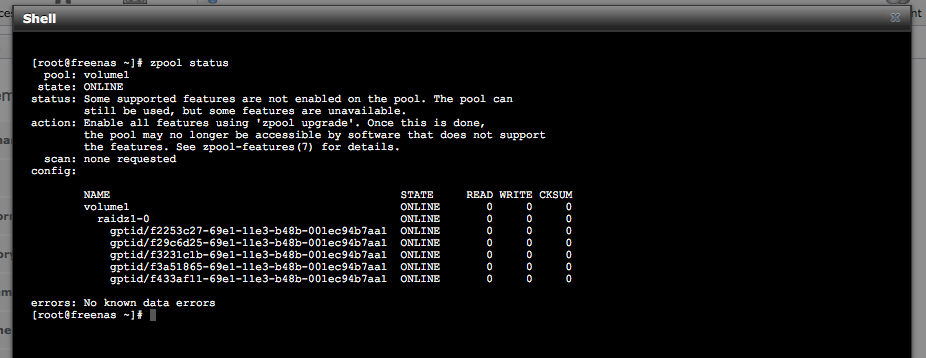

I decided to reboot the server and after the reboot it came up with the Alert icon GREEN and indicating the ZFS volume is now HEALTHY
I was able to run the spool status command too and it said there are no errors but some ZFS features are not in use and I should upgrade ZFS. here is the screen shot of that.
Any ideas/thoughts/comments ?

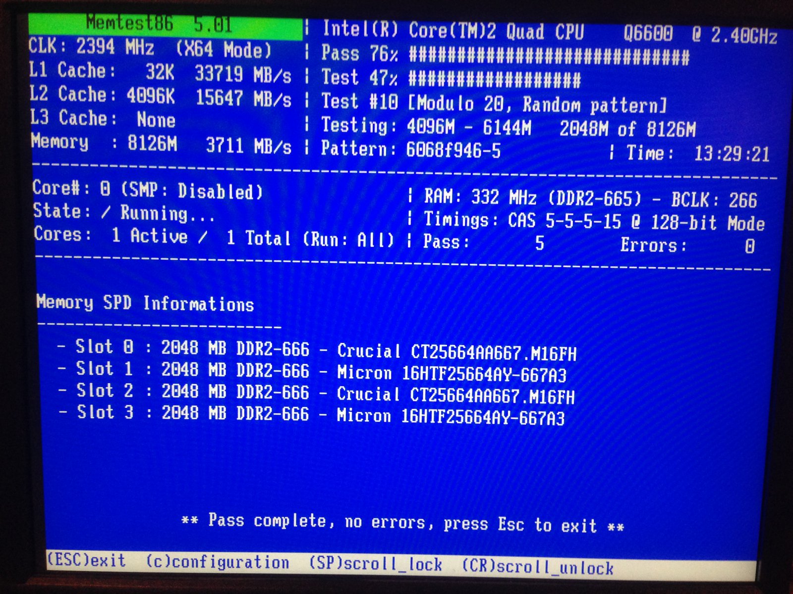

Ran 5 passes with the memtest and zero errors
I think I'll try and replace the USB stick next

Ok, so you probably have a bad USB stick. Get a new one, install FreeNAS on it and upload your config file. You should be back in business after that. If the issues continue it's possible your USB controller is broken or you have a motherboard issue.
And it is now safe to scrub your pool, but I'd wait until you think this issue is resolved for your own sanity. ;)
