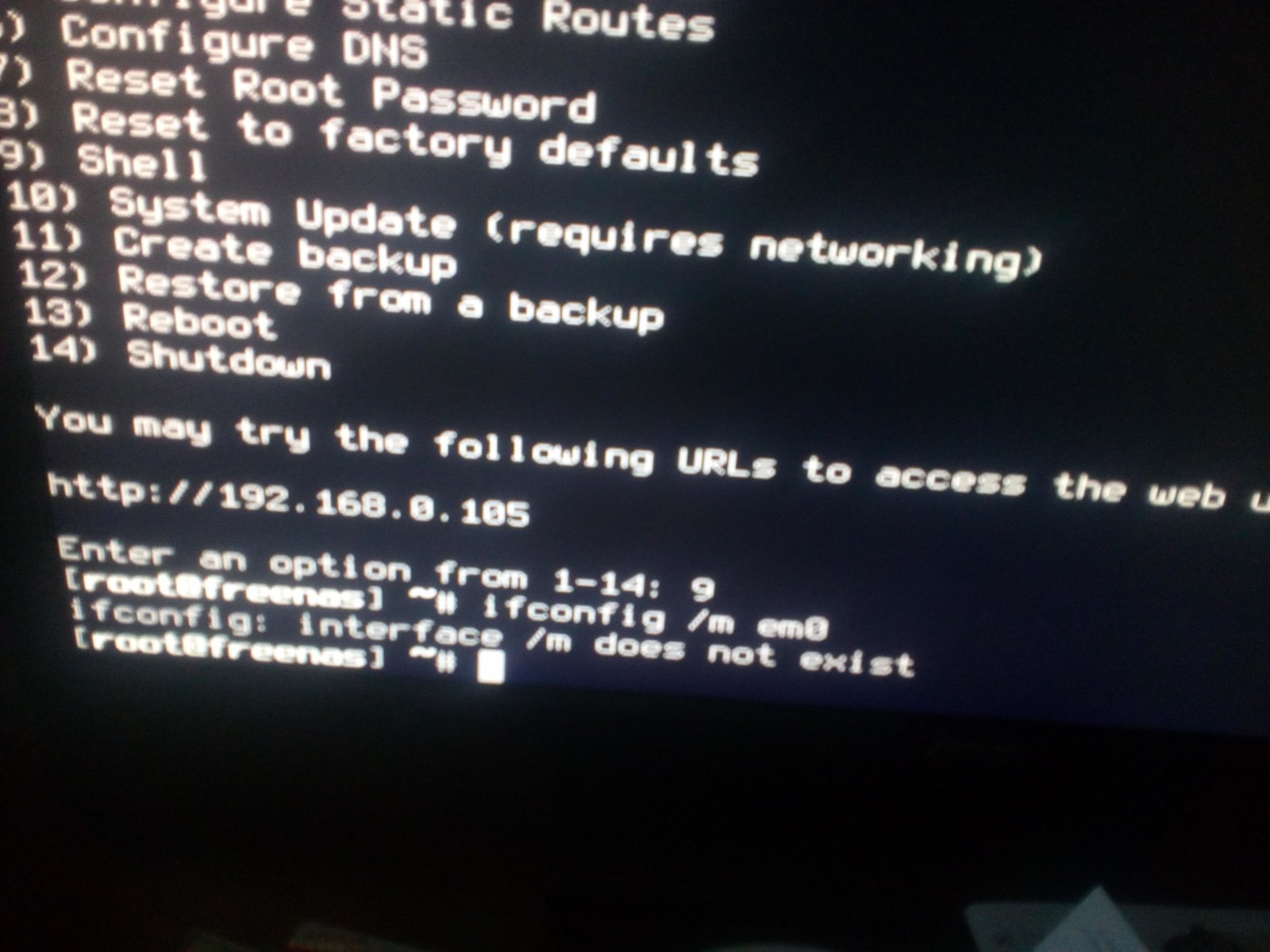

Ernie411
Jun 22, 2016
86
Then i'm getting ifconfig: interface /m not exist.

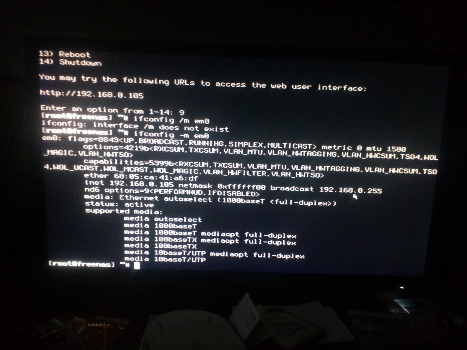

Ernie411
Jun 22, 2016
86
Sorry, my bad! I figured it out. This is the correct outcome.
Spearfoot
He of the long foot
May 13, 2015
2,478
Can't see all of the output; part of the screen is cropped. But I do see WOL_UCAST, WOL_MCAST, and WOL_MAGIC, which is encouraging.

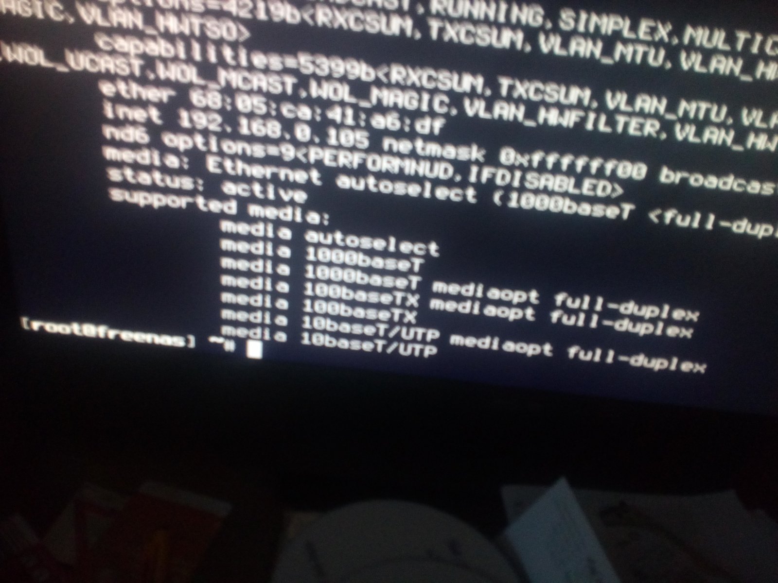

Let's see if this is a better picture
Spearfoot
He of the long foot
May 13, 2015
2,478
Yes, that's better. The results show that your NIC supports WOL; that's what the WOL_UCAST, WOL_MCAST, and WOL_MAGIC flags indicate.

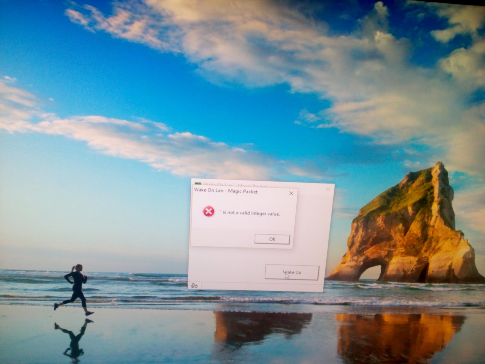

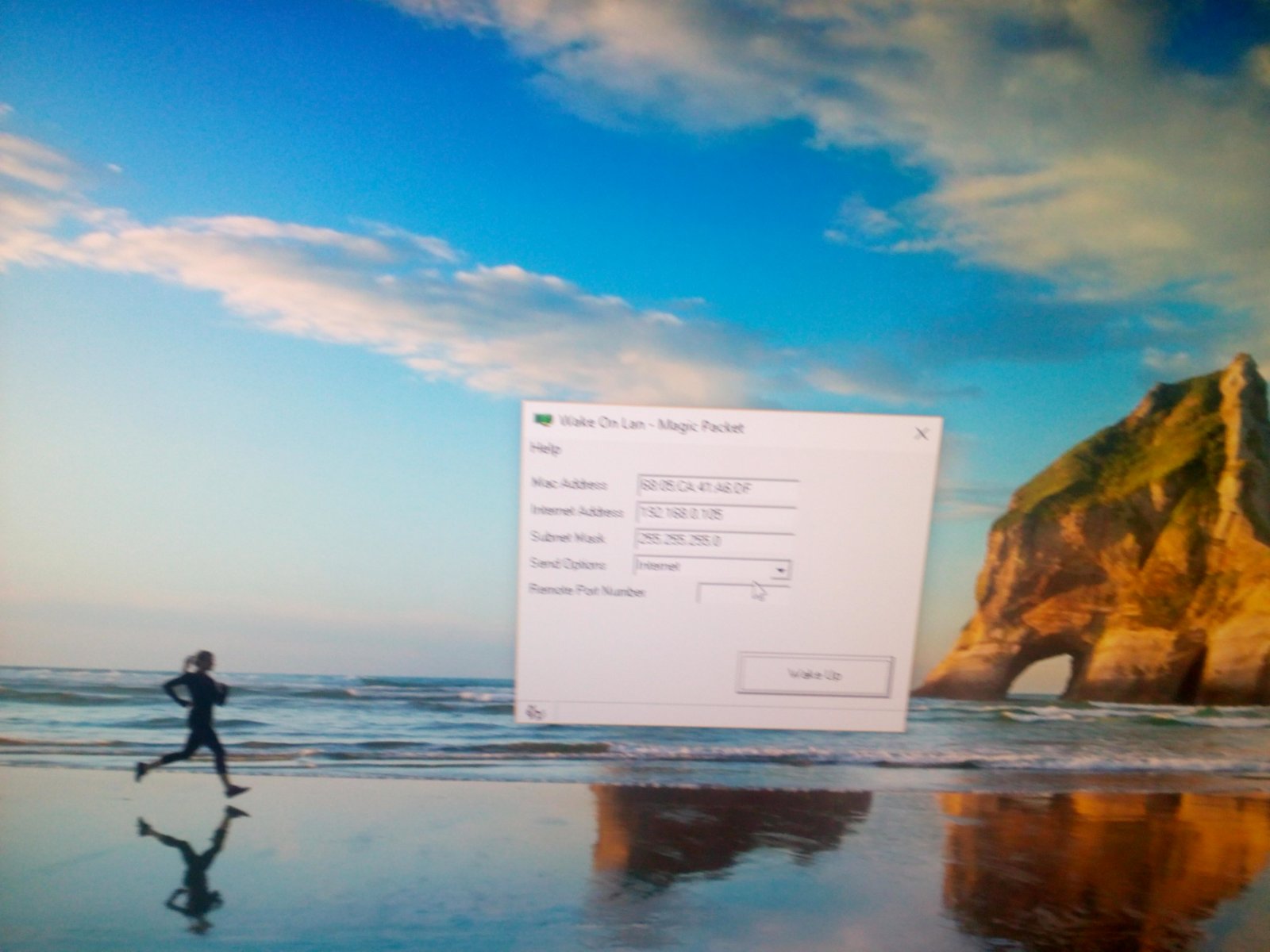

I have one more question for you.
In WakeonLanGUI i am getting an error.
See photo.
What can be done about it?
I hope that the photo is a bit visible.
See photo.
Perhaps its complaining about the magic packet value you've specified?
