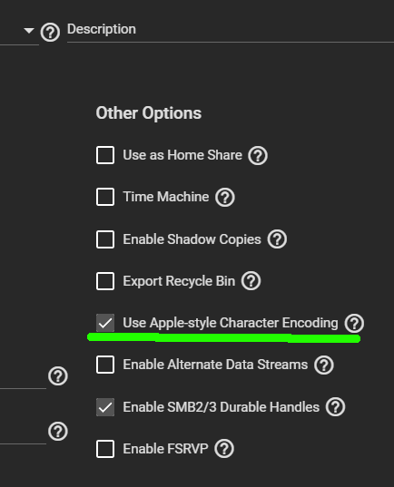

Stromkompressor
Mar 13, 2023
18
After I enable "Use Apple-style Character Encoding" I can't mount the share anymore. dmesg says
[ 5358.508569] CIFS: Attempting to mount \\192.168.2.12\svens-dateien
[ 5358.553355] CIFS: VFS: parse_server_interfaces: malformed interface info
Disabling it doesn't make it work again. I have to recreate the share (which takes 10 seconds). Do I have to delete all files, then enable the option, and then copy all the data into the dataset again?
