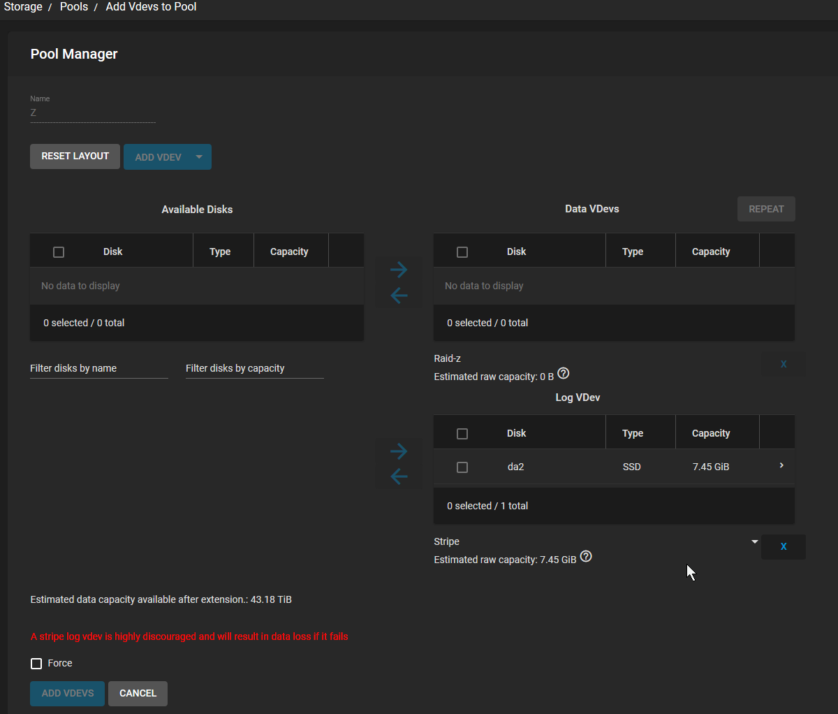

First off I use Truenas as a way to present an iSCSI datastore to ESXi.
Because of this I was told it's best to set my pool to always sync. Obviously this can cause some performance issues.
So in the past I've used a LOG device (1x intel 3700? ssd) and a UPS, it was specifically made to only show up as 10GB out of 100GB.
This seemed to work fine but I never really had a disaster even to know if I'd lose data.
Recently I migrated all my data to a larger pool and now I wanted to add the LOG device to that pool. I was greeted with a warning that I was only adding on device and it could result in dataloss.
So my question here is... what even would need to happen for me to lose data in this config? Would I need to lose my LOG device and have the powercut out on the Truenas box at the same time? Or would just having my LOG device die cause data loss on it's own?

Typically, that error message only appears if you added an ordinary vdev to your pool, instead of a log vdev, as this creates a stripe.

Adding it under log and still would need to do the force option.
Power loss, kernel panic, HBA suddenly dying, failure of an external SAS cable to a JBOD shelf; basically anything that causes your pool to suddenly become unavailable. This has to happen in concert with the failed LOG vdev.
Of course, a failed LOG vdev alone will also cause the same effect as enabling sync=always without one, that being a significant loss in performance for sync write workloads. For ESXi hosts hitting it over iSCSI this could result in VMs becoming extremely slow and/or the OS and applications running on them to be perceived as "not responding." Whether that matters to you is up to your workload.
