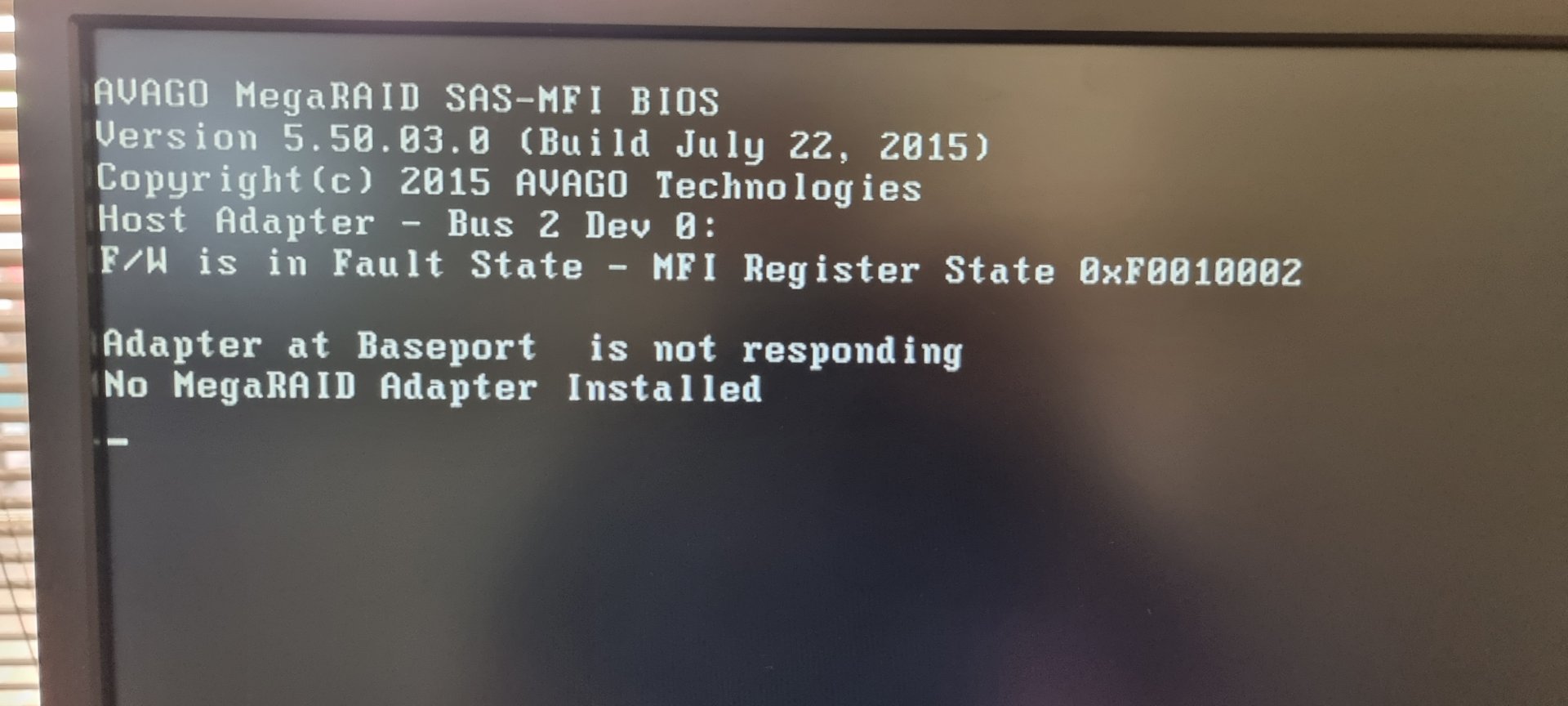

The error I get is shown in the attached image
Not much the forum will be able to suggest as re-attaching the megaraid card (making sure it's properly seated in the slot) will only result in the unsupported use of a megaraid card.
I don't know if that card can be flashed into IT mode (you can look it up), but that would require a backup and rebuild of your pool with ZFS this time.
