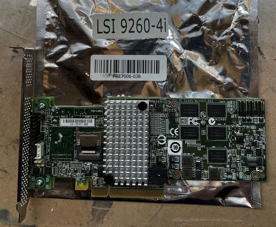

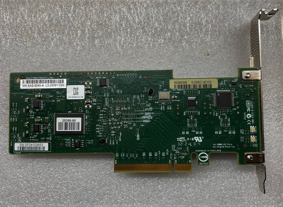

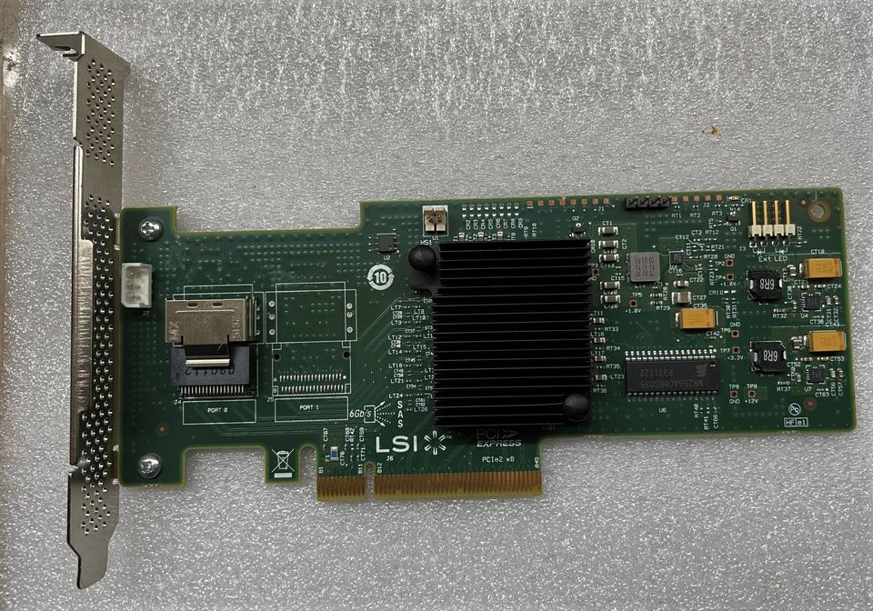

I have a HP proliant DL320 G6 server with P410i controller that dont support HBA mode.So I found two controller LSI SAS 9260-4i MegaRAID Controller and LSI MR MegaRAID 9240-4i SAS Controller on a marketplace for good price.
Someone can confirm me that I can put these card in it mode and have hba mode with this card and use it with Truenas without issue.
Thanks you
No luck on the 9260, but the 9240 can be crossflashed.
jgreco
Resident Grinch
May 29, 2011
18,680
Neither of these will work. See the article at
The 9240 has the potential to be crossflashed if you are able to find the correct files on LSI/Avago/Broadcom's website, but some folks have had problems, so you might want to find the files BEFORE you invest in a 9240.
Or just skip the hassle and get someone that is either already flashed or did start out life as an HBA.
