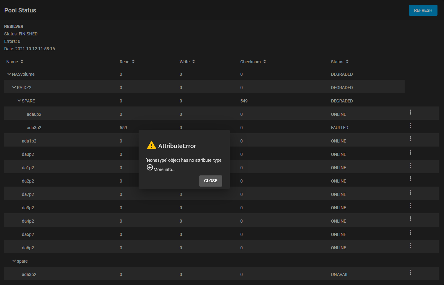

This morning drive ada0p2 went bad so my hot spare, ada3p2 took over. I then replaced ada0p2 with a new drive and resilvered. Now the hot spare is still showing up in my pool and is showing up as Status=faulted. When the hot spare had taken over it had a status of online, not faulted. I tried detaching the hot spare but I am getting an error 'AttributeError: 'NoneType' object has no attribute 'type'
Does anyone know how I can get my pool out of a degraded state? Any help would be much appreciated. The full error log when trying to detach the hot spare is below:

ultimaterez
Dec 21, 2021
I'll bump this thread - I am currently experiencing this same issue. I have restarted multiple times and tried to remove both of the hot spares (they are both currently in use) but I get the same error.
