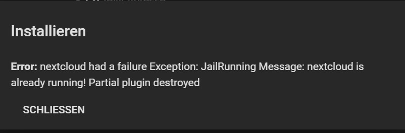

Hello all,
I have the following problem: I had uninstalled the Nextcloud plugin on my TrueNAS system and then wanted to reinstall it.
But now I can't install it anymore because I get the following error message: Error: nextcloud had a failure Exception: JailRunning Message: nextcloud is already running! Partial plugin destroyed
Has anyone had this problem before? How did you solve it? Is it possible to stop nextcloud with a shell command? If so, which command?
I would be very grateful! Sorry, I'm very new to NAS and I'm not really fit with command lines.
9,700
iocage list
Is there a jail called nextcloud in that list?
If so:
iocage stop nextcloud
iocage destroy nextcloud
then install your plugin.

Thanks for your reply and ideas! Unfortunately the jail name nextcloud was removed during installation. So it is no longer listed.
