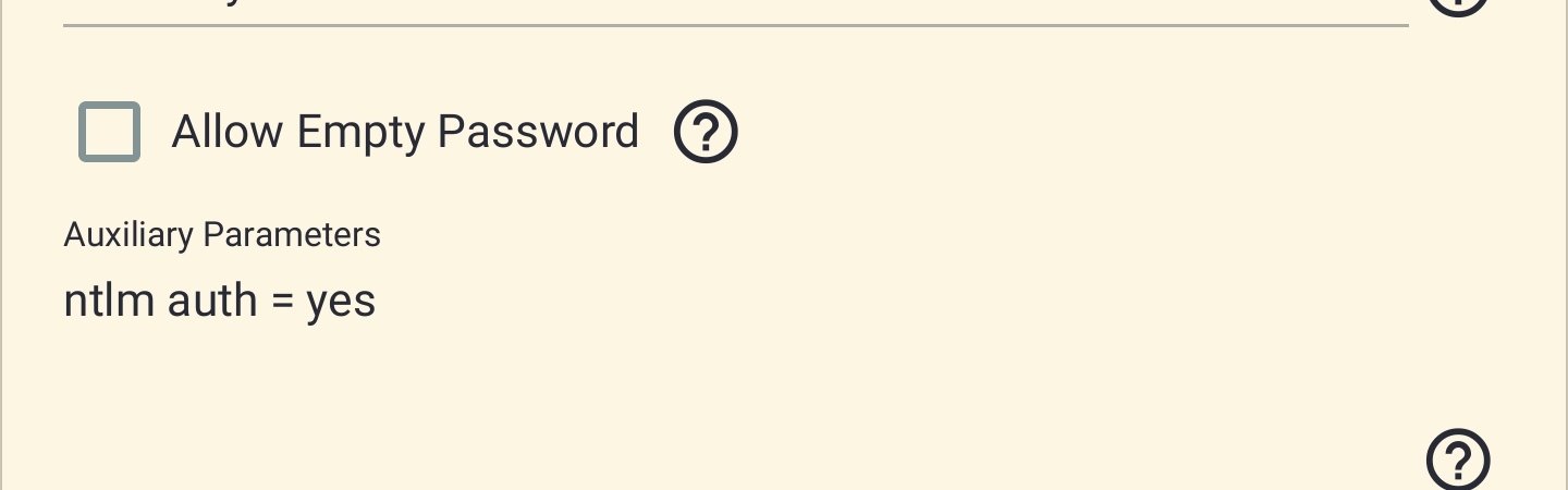

Hey what error message are you getting if any ? - because I ran into this issue as well (not being able to connect to smb share). I'm not sure if this solution can work for you - under services > smb I added "ntlm auth = yes" under auxiliary parameters and it worked like a charm .. and make sure your typing in the smb share properly.
Hopefully this works for you.
