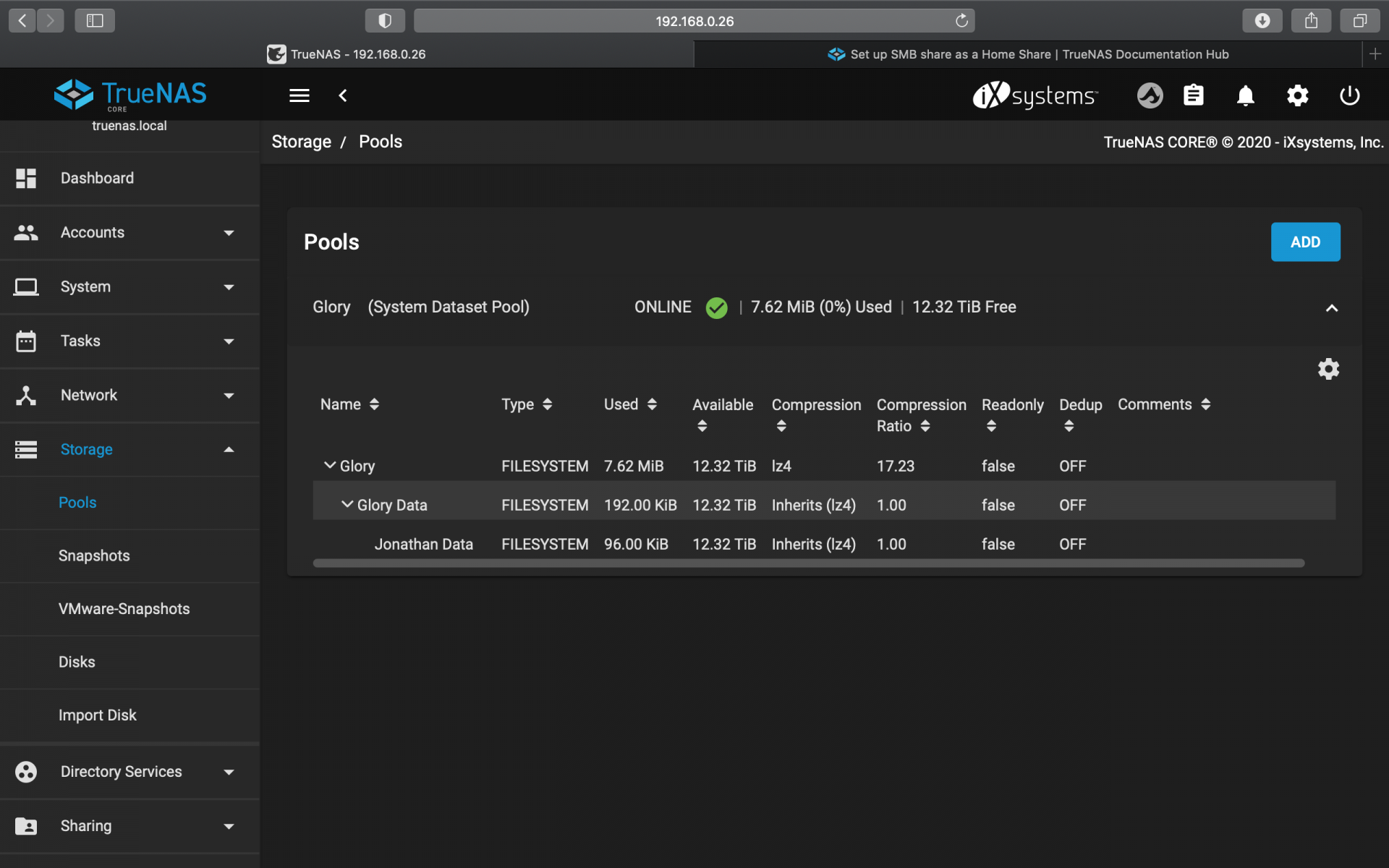

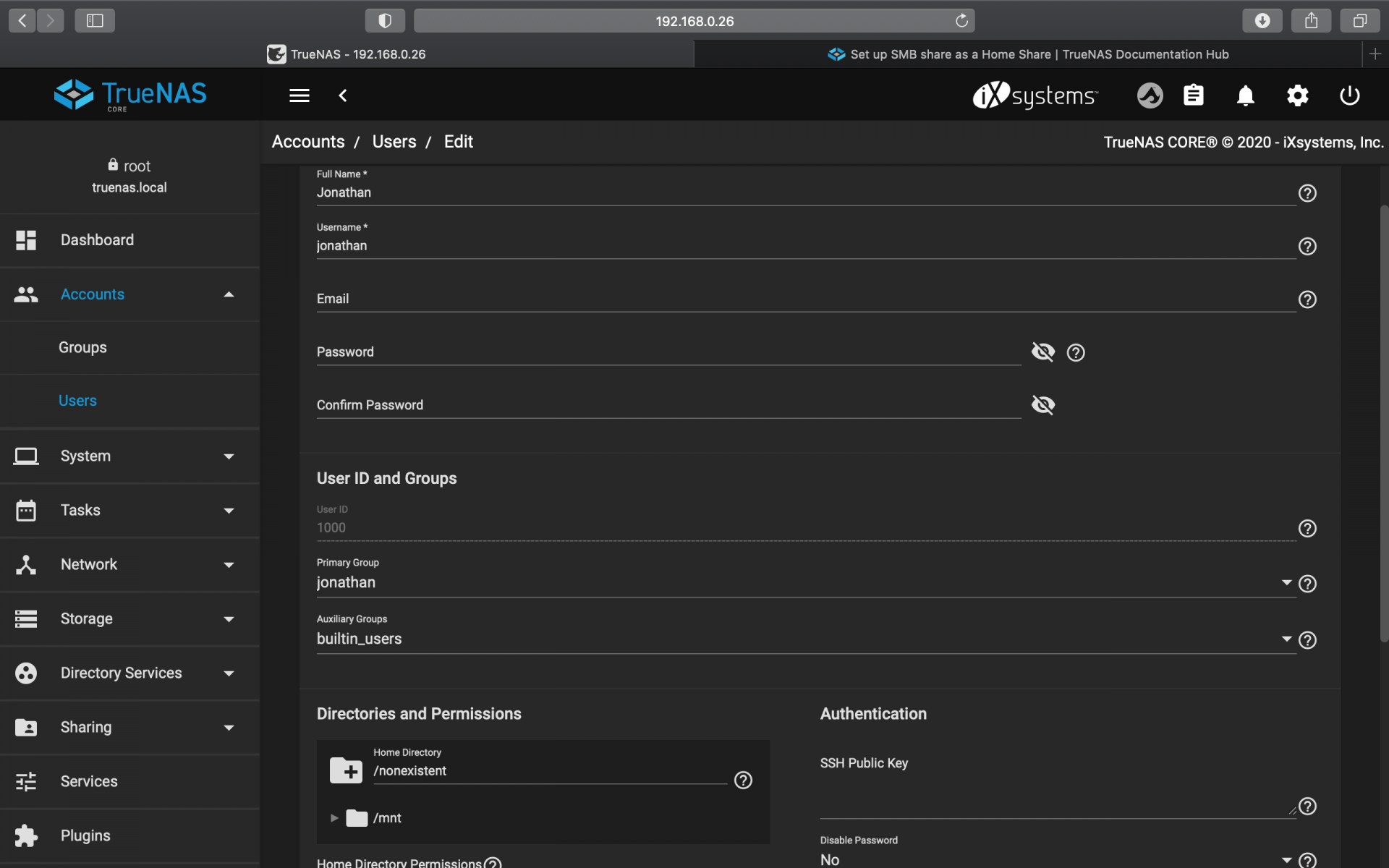

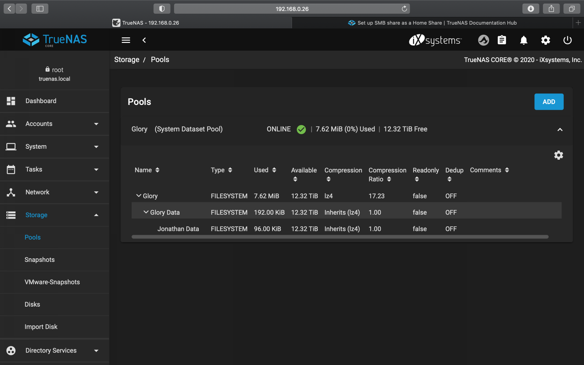

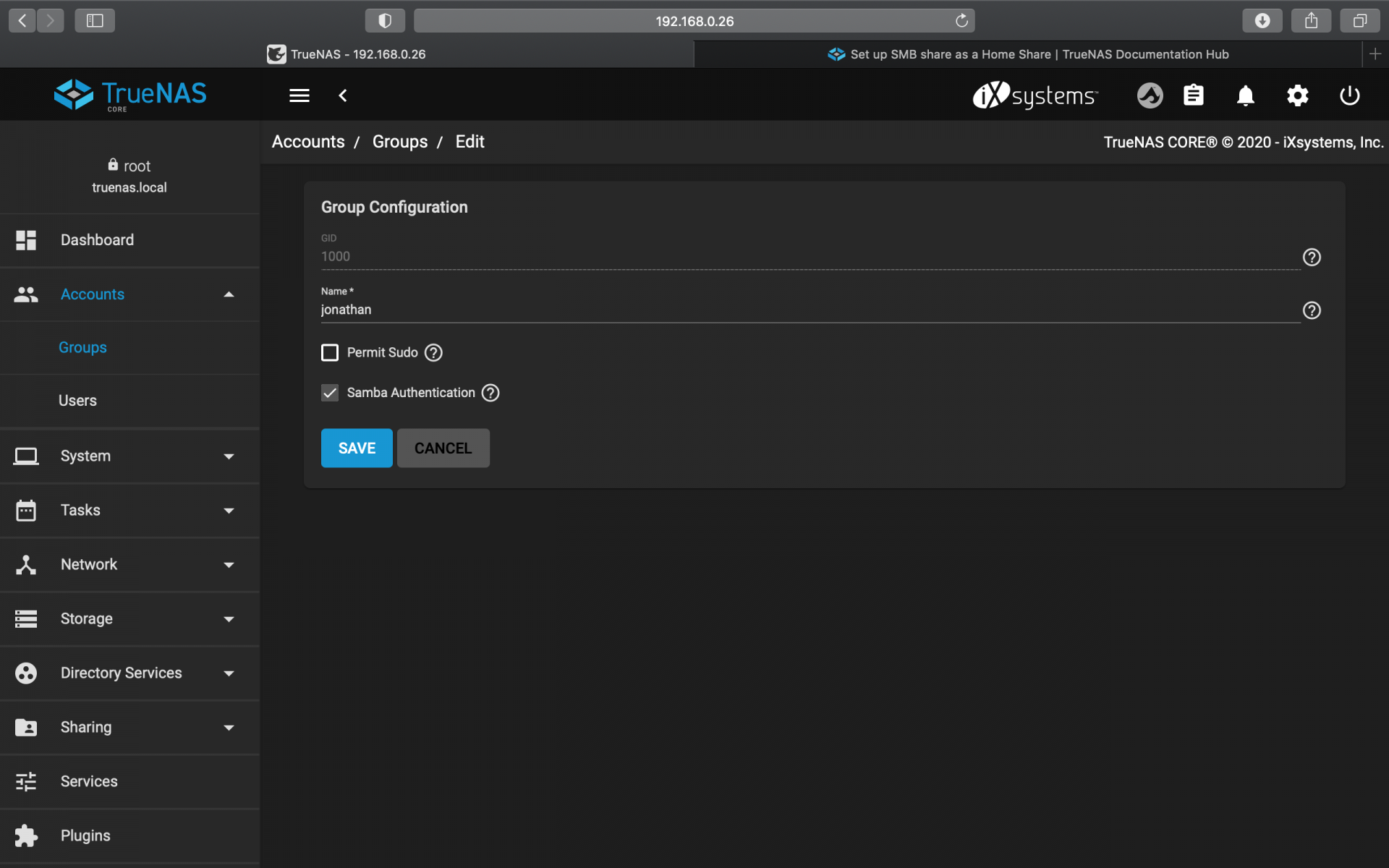

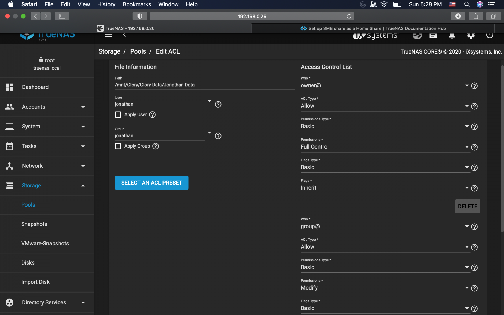

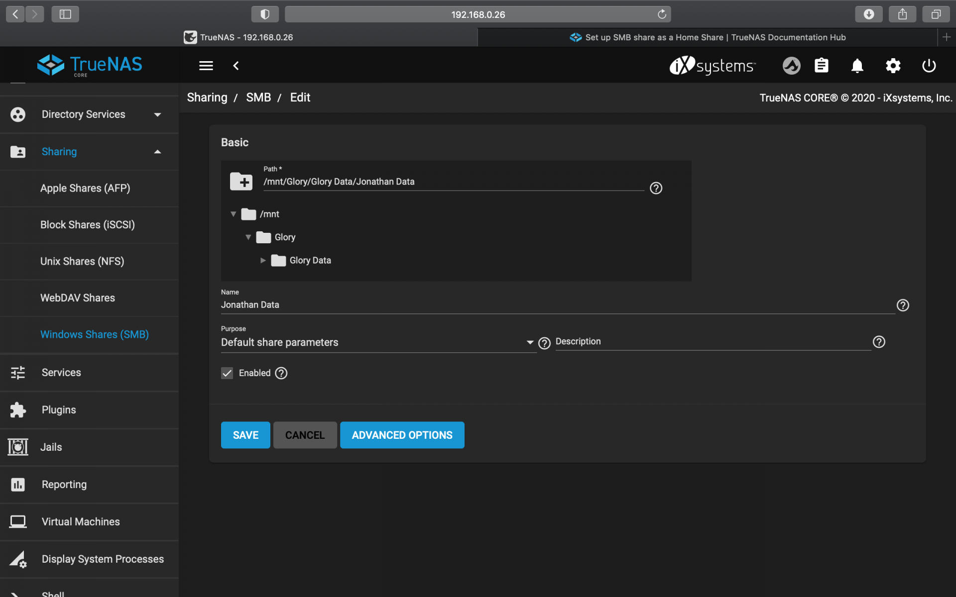

Hi everyone, I'm new to Truenas and I just did my first installation which went smoothly until I had to mount the share to access on my machines. When I'm attempting to mount the smb share on my Mac by entering in my credentials, I getting an error message saying that it can't connect to the server. Funny enough if I enter in the credentials incorrectly I don't get the error message the window the shakes showing that it can't authenticate. It seems like it's recognizing my credentials at the very least, but I can't connect. The same issue is occurring in Windows where I can't connect. Here are some screenshots from my system, I would greatly appreciate any guidance. Thank you

I am sure you missed a step. Here are links to a couple videos that step through the process. You should probably watch a couple of them to familiarize yourself with the steps.
