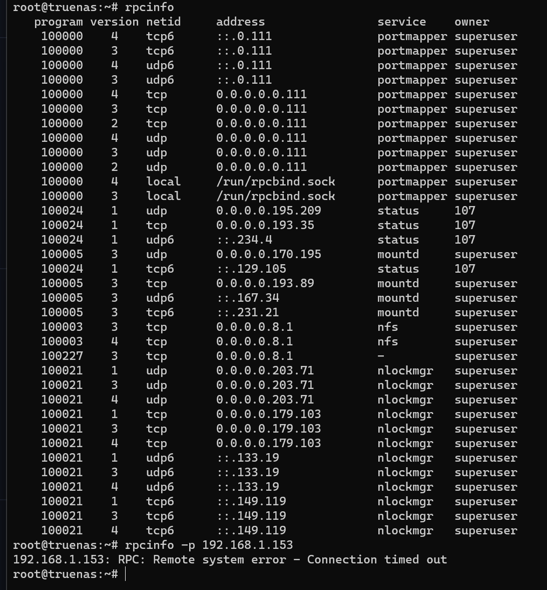

  • When I run 'showmount -e' from the client (LXC container on Proxmox) using the IP of my ParrotOS VM or TrueNAS CORE VM, the NFS share is immediately displayed. But when I do the same for my TrueNAS Scale VM, it takes about two minutes before the NFS shares appear.
  • Running 'rcpinfo -p' on my ParrotOS and CORE VMs shows the expected result of NFS on port 2049. However, when I try the same for the Scale VM, I receive the message "RPC: Remote system error - Connection timed out."

Maybe you mean on TNS that rpcinfo -p times out locally? Which would tend to imply rpcbind not running? I was assuming you were running rpcinfo -p tnsvm from the remotes t check.
If rpcbind isn't operational on TNS, then on the remotes try specifying port 2049 as part of the mount. Doesn't
Look like you have an option for specifying a port to show mount.

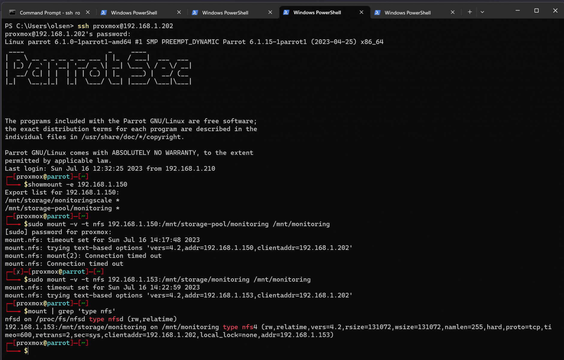

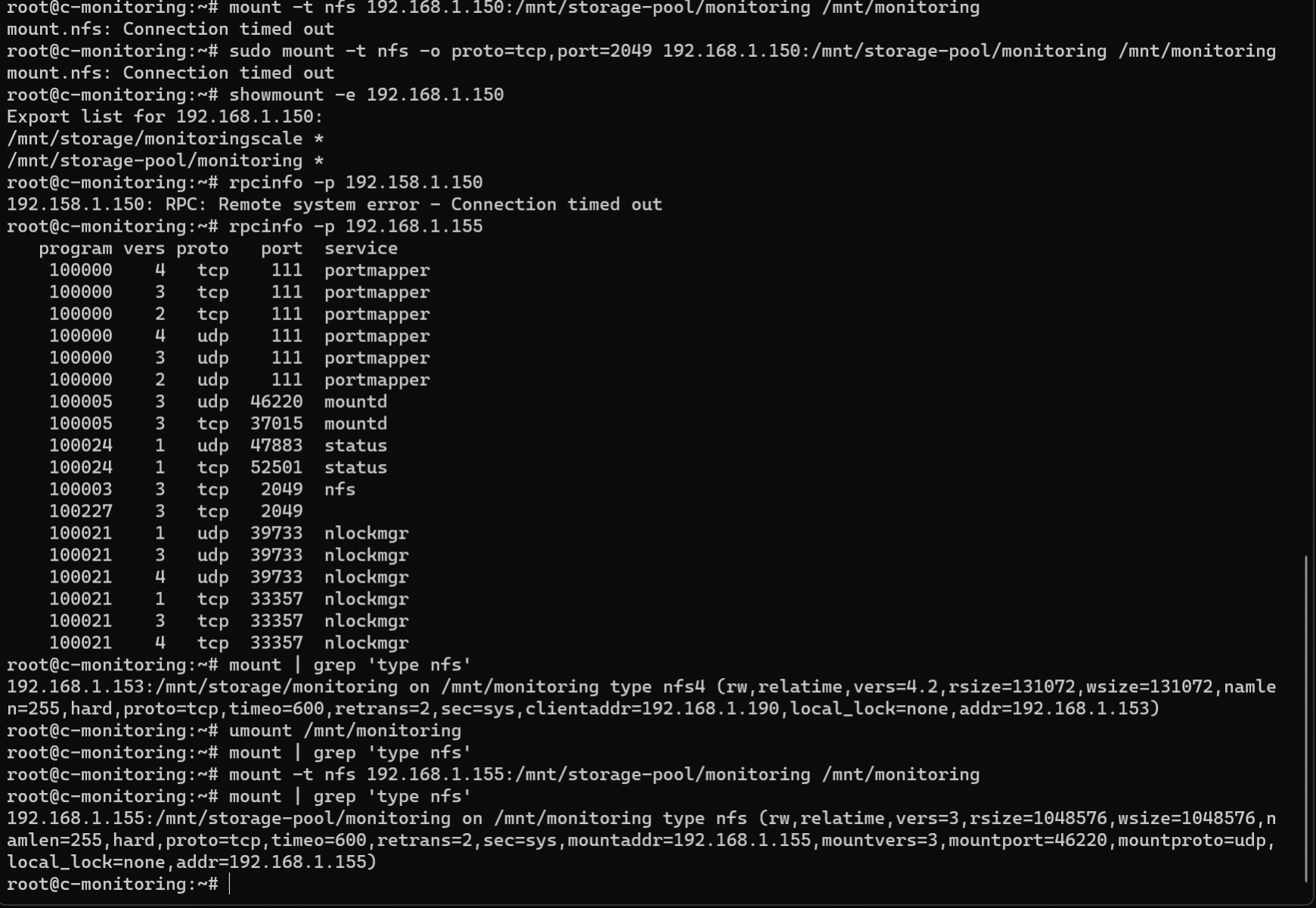

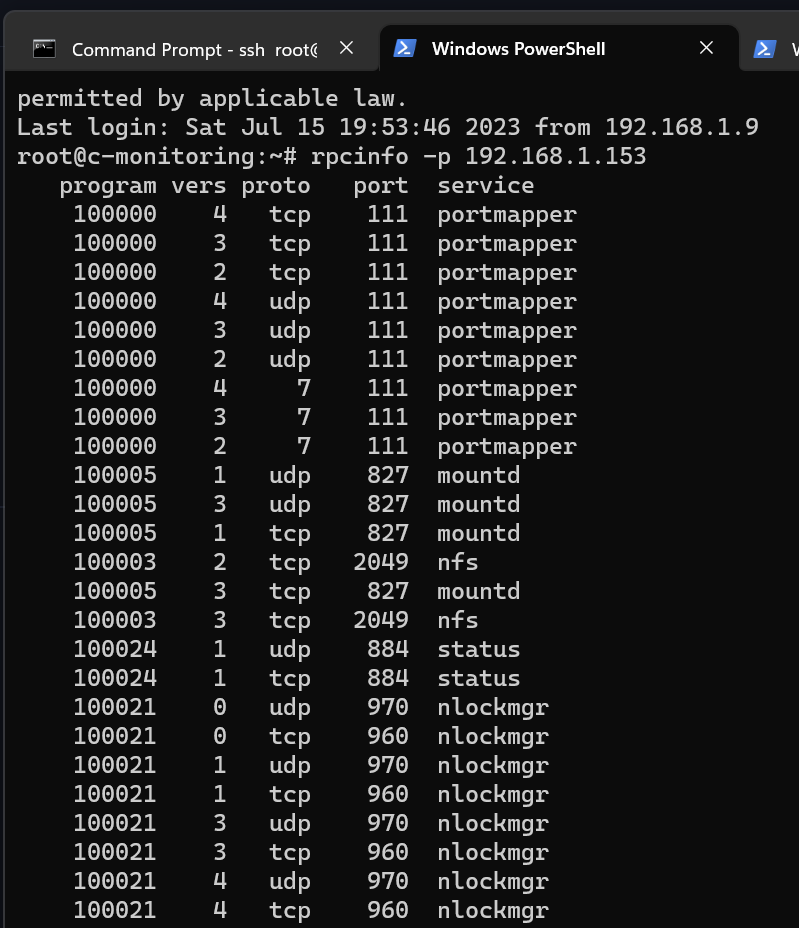

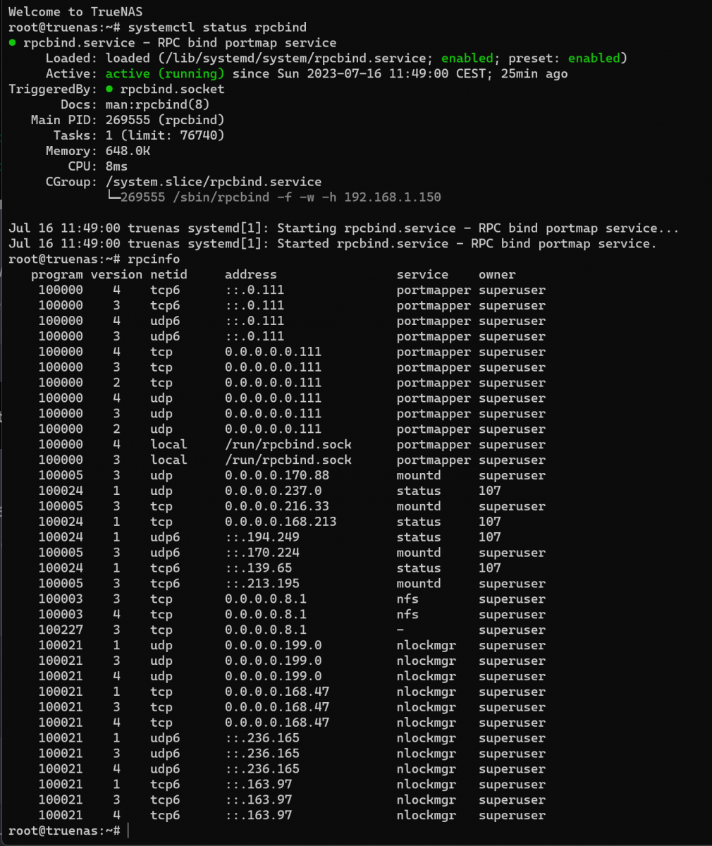

Yeah, running showmount -e from the LXC container to TNS eventually works, but it takes about 2 minutes to show the output. Interestingly, when I run showmount -e from my ParrotOS (VM) terminal, the output is instant. Though my LXC container and ParrotOS VM can't mount the NFS share from the TNS VM, they can see the output related to showmount.
I decided to try using TCPdump on TNS to investigate further. Pings are returned successfully, and I can see a few packages related to showmount coming from another client. However, there are no signs of any packages coming through while trying to mount a share from a client.
I checked the messages and syslogs, and after analyzing them with chatGPT, it seems that there are no issues with the NFS server or its services. The services appear to have started up successfully, and there are no error messages indicating any problems with NFS.

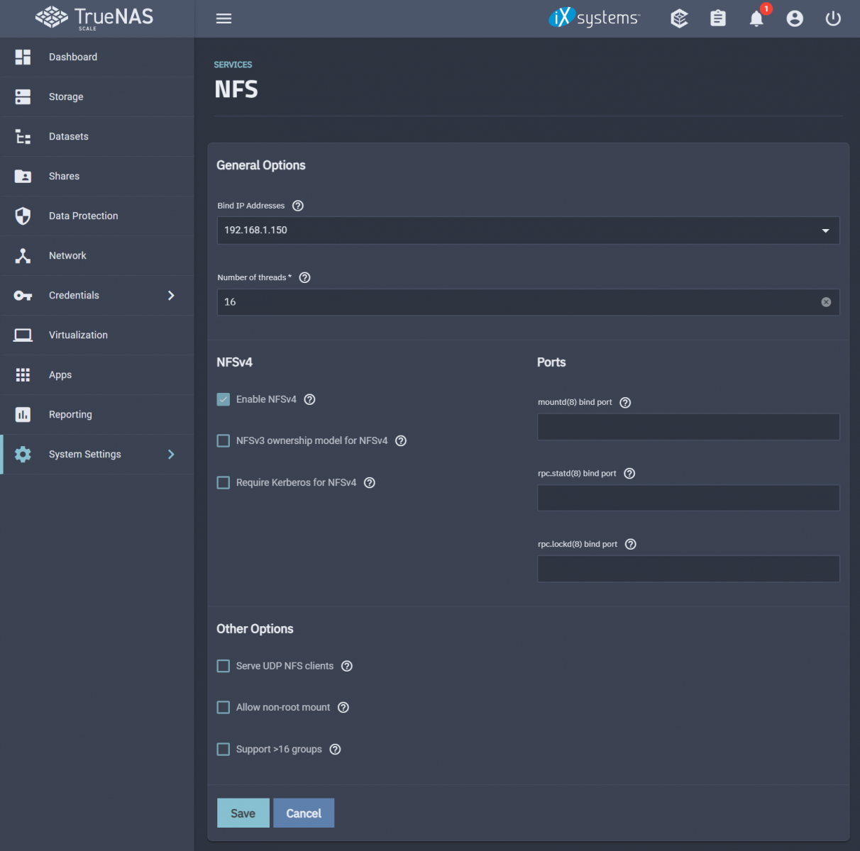

It's puzzling that both my TNS and TNC have vanilla installs with minimal customization. The only script I have on my TNS is the one that keeps me logged in, but apart from that, there haven't been any significant changes.
Screenshot 2023-07-16 142320.png Screenshot 2023-07-16 121519.png Screenshot 2023-07-16 115128.png Screenshot 2023-07-16 115032.png Screenshot 2023-07-16 114952.png Screenshot 2023-07-16 114808.png Screenshot 2023-07-16 114745.png Screenshot 2023-07-16 114655.png

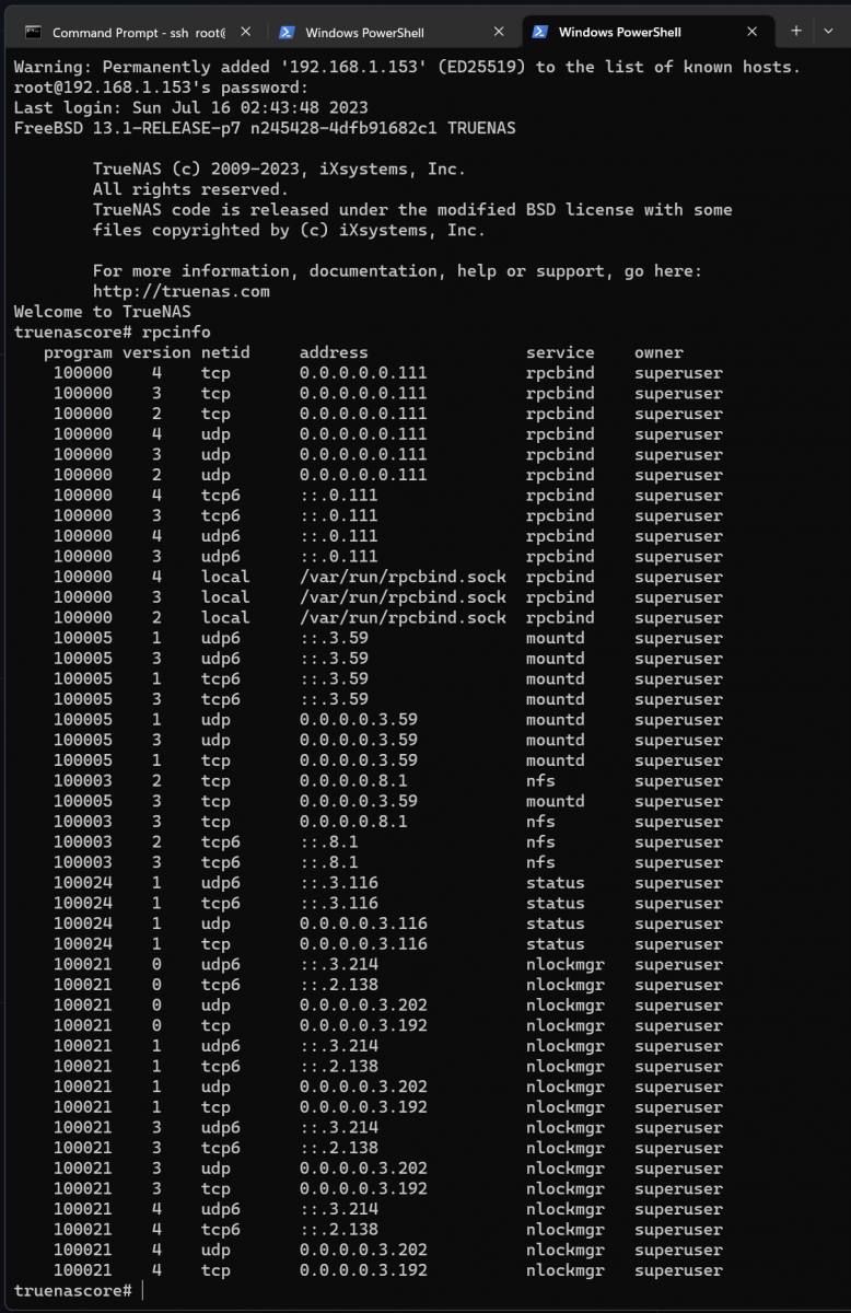

So, just to go by the process of elimination, I spun up a new TNS VM and created an NFS share similar to the one I'm trying to connect to on my other TNS. The LXC container connects to it just fine.
I tried to go over most, if not all, the settings, and for the most part, they look identical. I disabled the "keep-alive-login-script" as well, but it made no difference.
I might just do a fresh install. Having a TNS with broken NFS sharing capabilities is not great going forward.

Try mount -t nfs4 like parrot did, even though you said -t nfs, it tried vers=4.2
I don't know why truenas is reporting port numbers as two byes in the address, took me a little while to understand that .8.1 is normally :2049
Still don't know why rpcinfo -p is getting lost.
Mount delay might be trying nfs vers=3 via portmapper, then eventually getting to trying vers=4.x directly without portmapper response.
