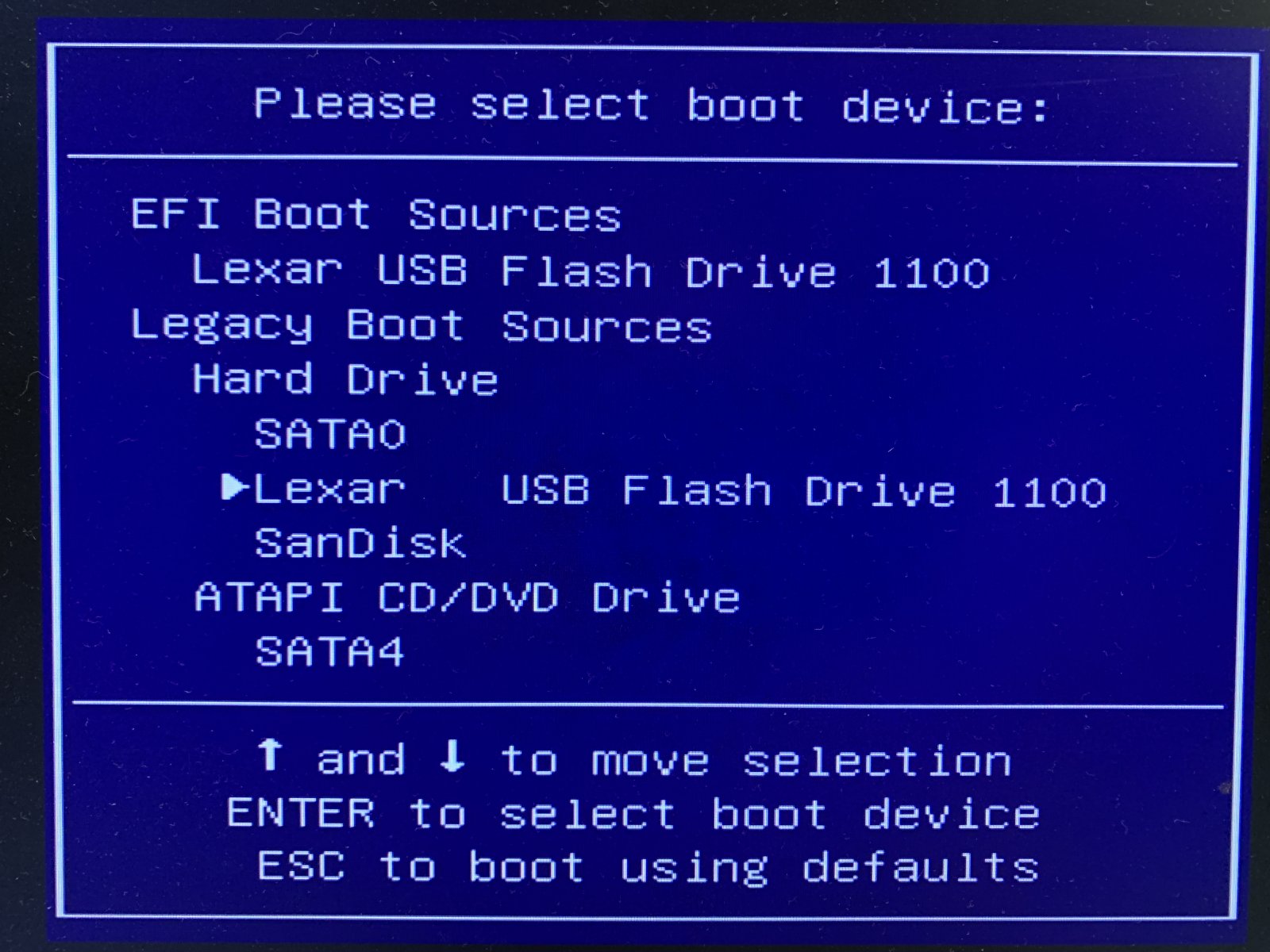

Update. After a couple of days of wirking on it, this change has lead to a successful installation and boot of TrueNAS Core. phew.
Attached is an image of the boot device selection screen showing the same USB stick in both EFI and Legacy (BIOS) boot lists. Only the later option would continue past the "Mask..." install line.

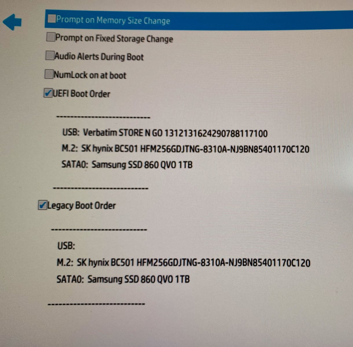

Check this screenshot: UEFI recognises the USB boot image but Legacy not. UEFI is always freezing the kernal loading after the masks are shown ... (whichever version of BSD or FreeNAS I use). I have the feeling i'm close but I need you help guys!

dlobel
Feb 19, 2021
32
Ok, so I'm a step further. I've tested the UEFI boot USB on a mac and I'm able to install FreeNAS. So the problem is the BIOS on my HP PC.
When i boot in UEFI mode, it always freezes at the same point. Could it be incompatible hardware? Its a notmal x86 i5 core with 8GB ram and two harddrivers (1x NVME and 1x SSD)
Bugstar
Feb 24, 2021
5
I'm not familiar with the UEFI/BIOS environment that you're using, but...
I have the option to enable/disable storage devices in either EFI (pre-UEFI I believe) or Legacy BIOS. Enabling USB Harddrive in Legacy BIOS allowed it to be selected in the Boot Options menu.
Again, I had to 'manually' select the boot device from the Legacy BIOS list in the Boot Options Menu otherwise it would default to EFI boot devices first. There's seemingly no way to change the Boot Device Order to use Legacy BIOS devices first.
