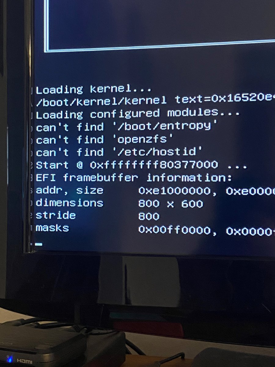

Very new to this so sorry if it pisses people off.
Trying to install truenas 12 1.1u and as soon as i select 1 on the install menu it sarts to run and gives me the errors seen in the picture.
Any help would be appreciated

Your boot media is corrupt. Try downloading the ISO again, and checking the checksums, before burning it to another thumb drive.

I have exact the same problem. Downloaded diverse ISO’s of TrueNas and FreeNas. DD and used Rufus to write to USB. Used 4 different usb sticks, from new to old. 2, 16 and 32 GB. Nothing works. Still got stuck at the same point as chasen64. After loading masks. Booting Legacy on, secure off. Nothing works...

Then the problem is likely your hardware is incompatible with the BTX bootloader. Try installing 11.1 first, which uses GRUB. Then once you've achieved a working installation, upgrade within the system to 12.0-U2.

Hello Samuel, I've tried to install FreeNAS 9, 11 and 12. All have exact the same problem. Install freezes after masks messages. Just checked the SHA256 checksum and those were correct. Tried the install on several USB sticks. Still same result. Because I have an HP prodesk 400 (thin PC) I dont have a CD drive, so i'm stuck to the use of usb sticks.
Any more help would be appriciated!

Are you using USB2 sticks in USB2 ports? USB3 ports and sticks won't work. On the back of the ProDesk 400, there are USB ports labeled with SS (SuperSpeed). Don't use those ports.
It's likely HP's done proprietary things to the UEFI BIOS to prevent installation of 3rd party OSs. The datasheet says these are optimized for Windows 10.
