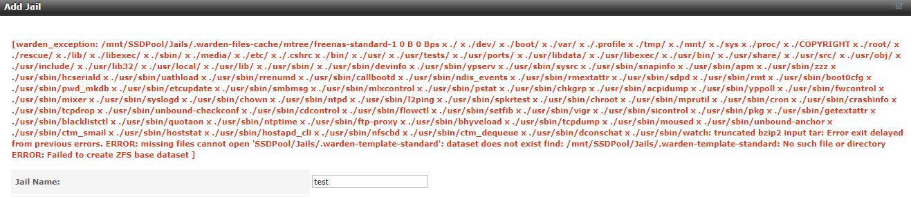

Also here is what creating a jail looks like:
Apr 9, 2015
1,258
Says "Dataset does not exist" in the error.....
Go check your settings for the jail and correct it. Probably should start with /mnt/xxxxxxx
MikeyG
Dec 8, 2017
442
What settings? The only place I see to specify location is under Jails -> Configuration and that information is correct. In the example I posted, I had created a new dataset at /mnt/SSDPool/Jails and pointed the jail configuration to it. .warden-template-standard did not already exist, but I thought it was created automatically. In the past, I have never had to create any templates in order to create jails.
