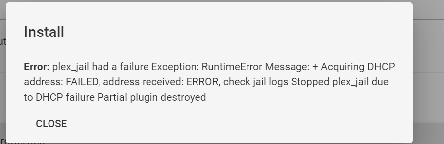

Hello, I'm searching for help here after a full morning spent on how to solve this issue. I'm a newbie so I hope it will be a stupid misconfiguration.
I have a Dell R720 and after a new installation of Truenas there isn't any trouble except when I try to install plex:
I tried without DHCP assigning an unused static ip (out of the DHCP range of my Fritzbox) but it doesn't works.

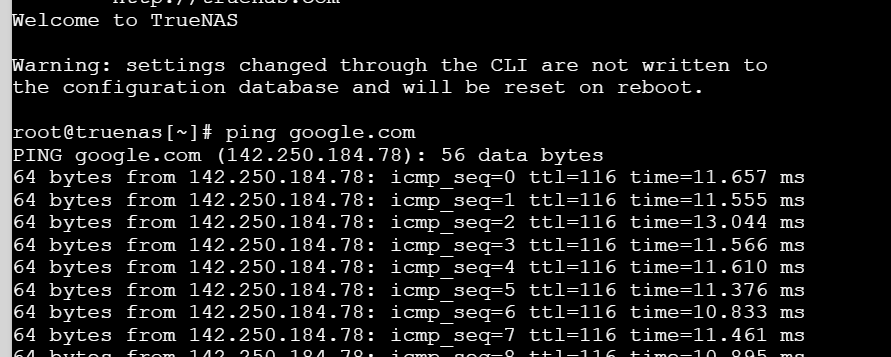

The server is correctly connected to the internet:
I'm having this issue even with the installation of other plugins.
Thank you for your support.
