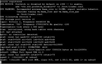

Hello,
I need to install FreeNas 8 on an old HP Proliant DL360 G3 server. I booted the FreeNAS-8.0-RELEASE-i386.iso but after a while the machine hangs completly. So it's impossible to complete the installation. A screenshot is attached.
Can sombody help me? Sorry for my english.

Yes, after disabling USB it hangs after:
md0: Preload image...
Uwe

mordek
Oct 14, 2011
Ive also got same problem. My hardware is HP DL380 G3. The hangs are at the same moments.

** SOLVED ** Unable to install HP DL380 G3
Hello again
I just solved the problem with installation.
I used Version 8.0.3 of FreeNAS via iLO Virtual CDROM Remote Installation to do the installation. This was stopping always at the usb devices and the machine hangs.
The trick is to disable in the BIOS the Virtual Media in Advanced Options and to boot FreeNAS Installation without ACPI.
Then the installation starts on the DL380.
After FreeBSD is installed you need to disable the HP PCI USB Controller in the BIOS so that FreeNAS will boot on this Hardware.
