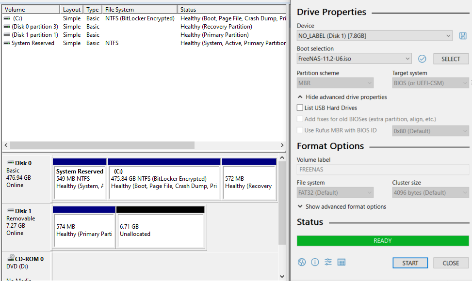

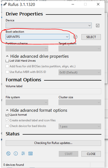

As stated in the original post I have used Etcher and I get the exact same result as Rufus... Grabbed another USB, and another laptop today...same result... Please see the screenshot below...

I can set it to "UEFI:NTFS" but the moment I pick my ISO it grays everything out and I get the same result
1. before doing this use diskpart and clean command, so that the USB has no leftover partitions.
2. Then do what you did>choose UEFI:NTFS then only choose the ISO
3. Still cannot then after step 1 use diskpart to change partition table from MBR to GPT
Looking at your screenshot above it was still done in MBR.
(i am doing some migration t4 could not risk otherwise i will do one and screenshot)
