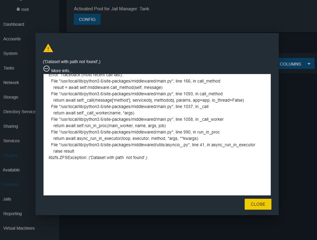

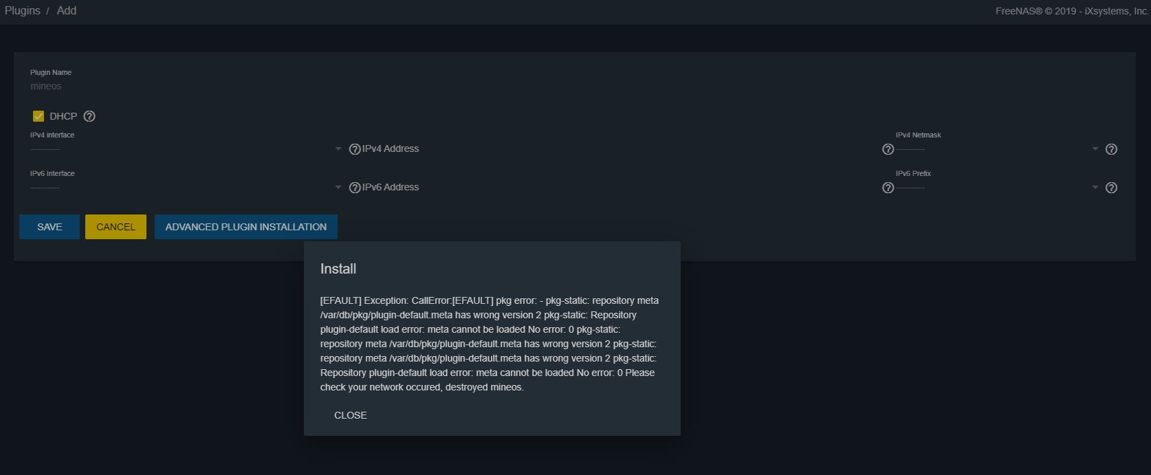

FreeNas Stable 11.2-8 Feb 14 working fine so far. All of a sudden the MineOS won't let me access it via web browser which my kids use. OK. Check everything, nothing has changed in the Jail. So I look to see if FreeNas 11.2 needs an update. Everything is updated. Still can't access it and nothing has changed on my router. OK. Backup the servers, and decide to reinstall the MineOS from scratch. Nope Link broken.
OK. Freenas has moved on from 11.2 plugin support apparently. Lets upgrade to 11.3. Upgrade to 11.3. Now I can't access my jails UI or plugin UI at ALL. Keep getting this error. Great.
OK. Rollback to older version 11.2 should fix? Nope. Can't access anything at all. Plex. Nope. MineOS. Nope. Can't even access the data on the storage pool.
I lost everything here. So no. Its not OK. There is no way an OS with millions of users can be totally broken like this with by clicking an upgrade button.
May you have fun toiling through ssh code line by line diagnosing problems that FreeNas decided were working a little too smoothly and needed to break, but normal people don't.
Oh and here's another perfectly working plugin that FreeNas decided to break all on its own. And as you can see by the pageviews and comments, its not just me and cartesio.
Its too bad, FreeNas WAS pretty good, its just lost site of its core function that it sells. STABILITY
