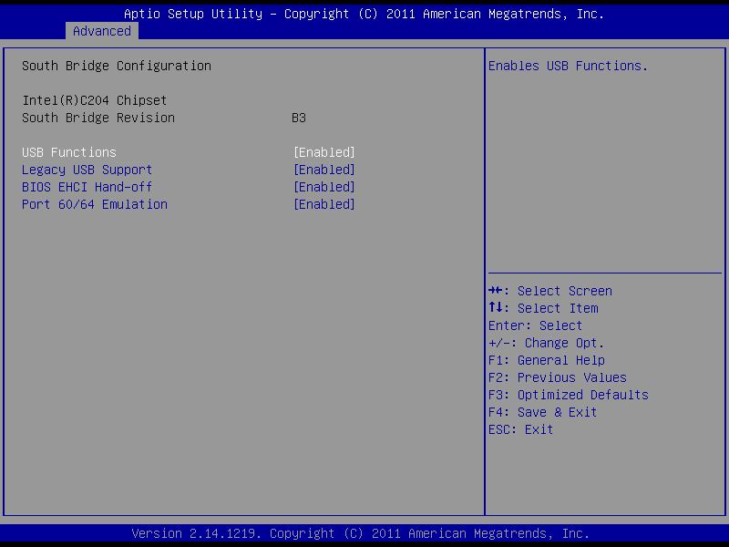

Also as mentioned in the other thread, I had a look at the X9CSM-F bios, and "Legacy USB Support" is Enabled.
