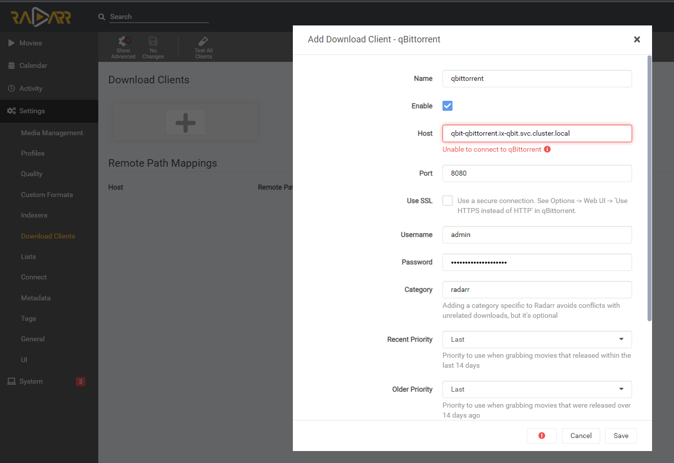

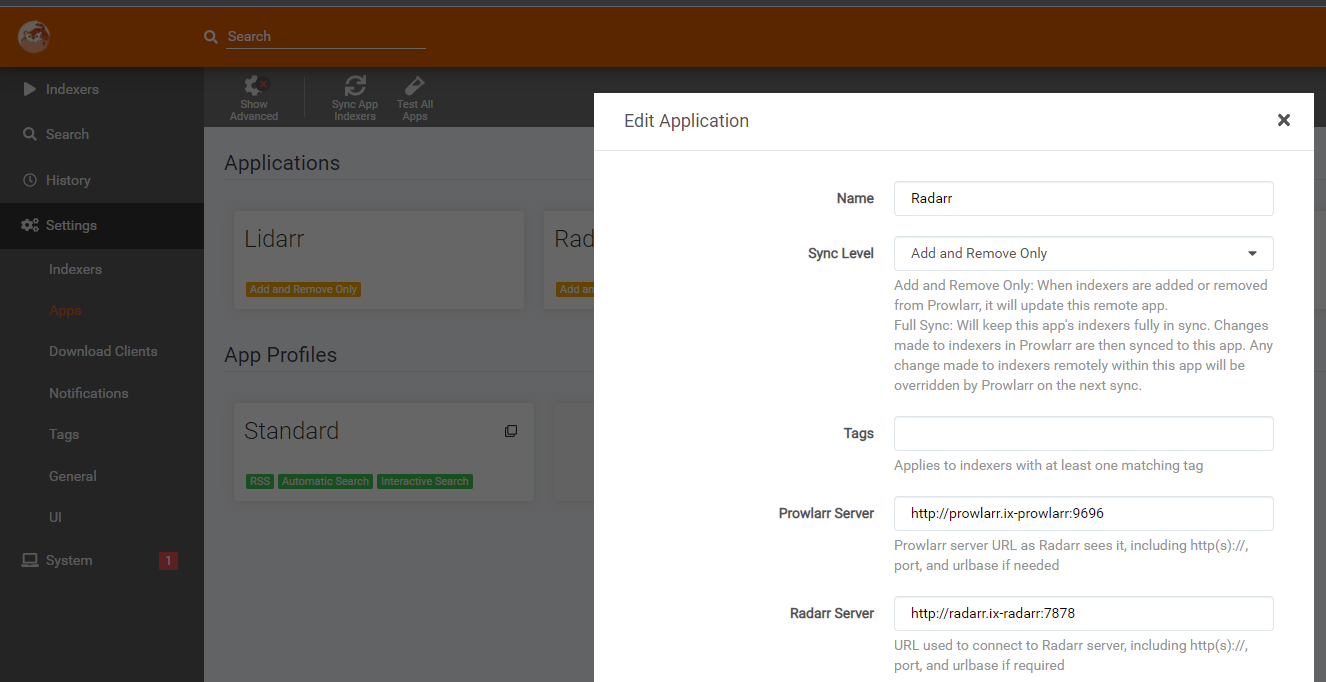

Hello,
for some reason I am not able to setup qBittorrent with sonarr or radarr through the internal dns name.
I am using OpenVPN in the qBittorrent Application:

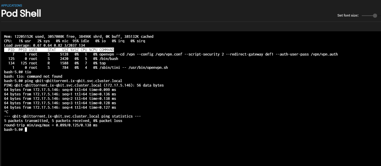

from the ovpn pod I am able to ping the name: qbit-qbittorrent.ix-qbit.svc.cluster.local

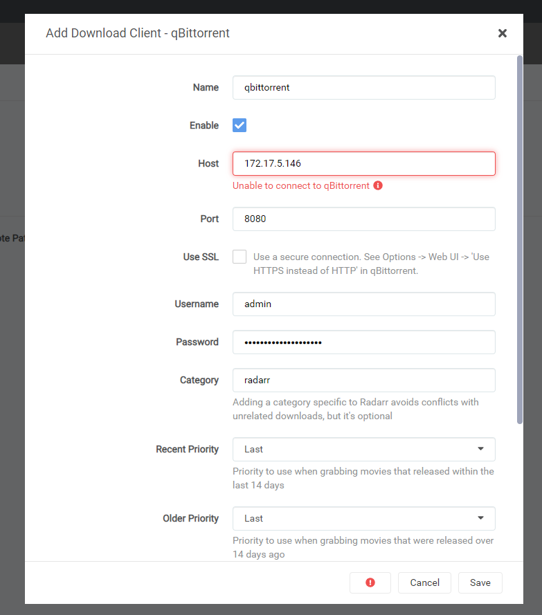

It is also not working through the internal ip:
My Application is named qbit:
I was following the guide from @truecharts
In the other pods I do not have ping so I cant try to reach them through the Kubernetes network
Setting up Prowlarr with Sonarr & Radarr is working without problems:

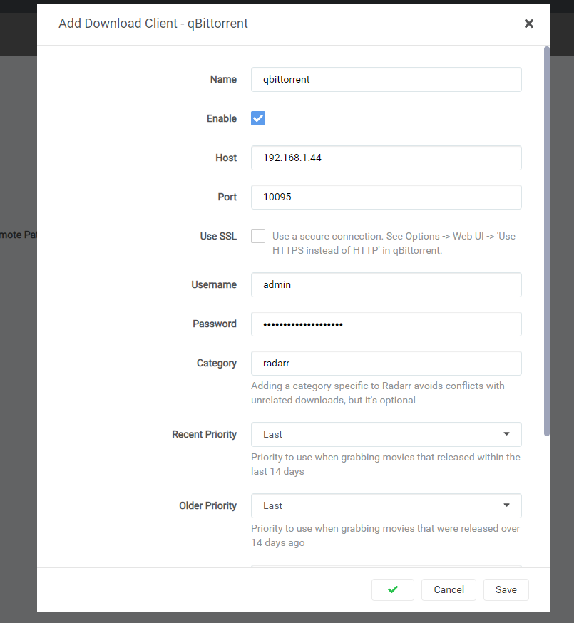

But when I am using it through the NAS IP with the exposed port it is working:
Did anyone encounter this error?

from the ovpn pod I am able to ping the name: qbit-qbittorrent.ix-qbit.svc.cluster.local View attachment 53542

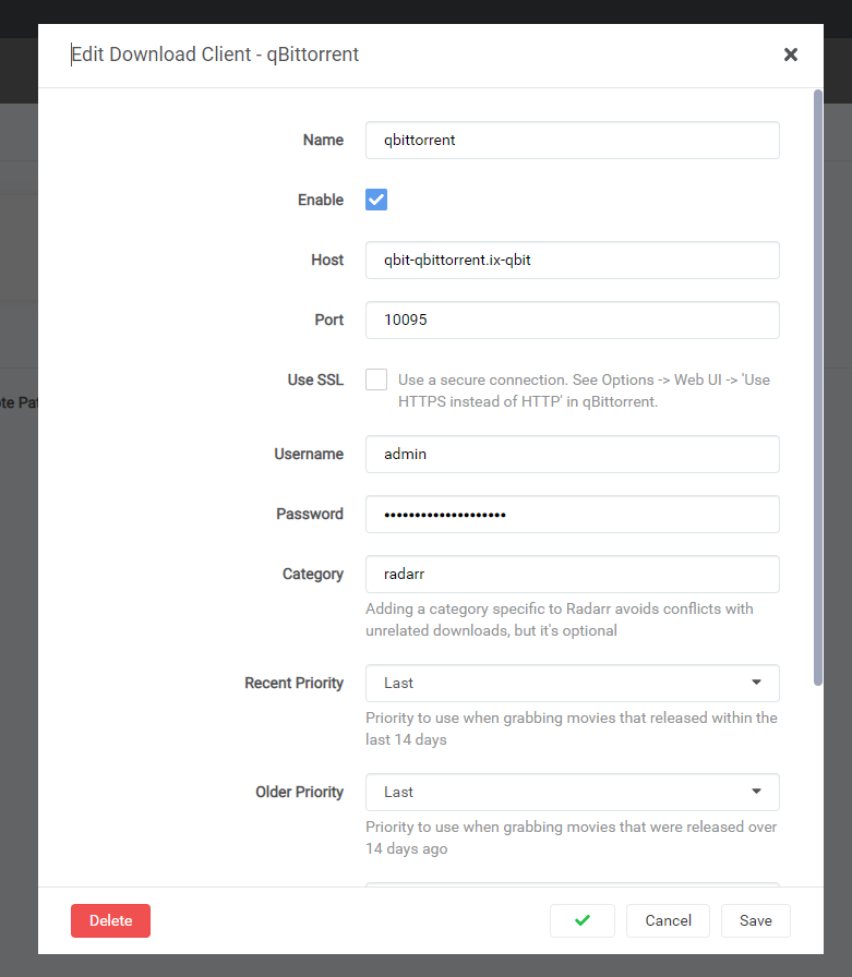

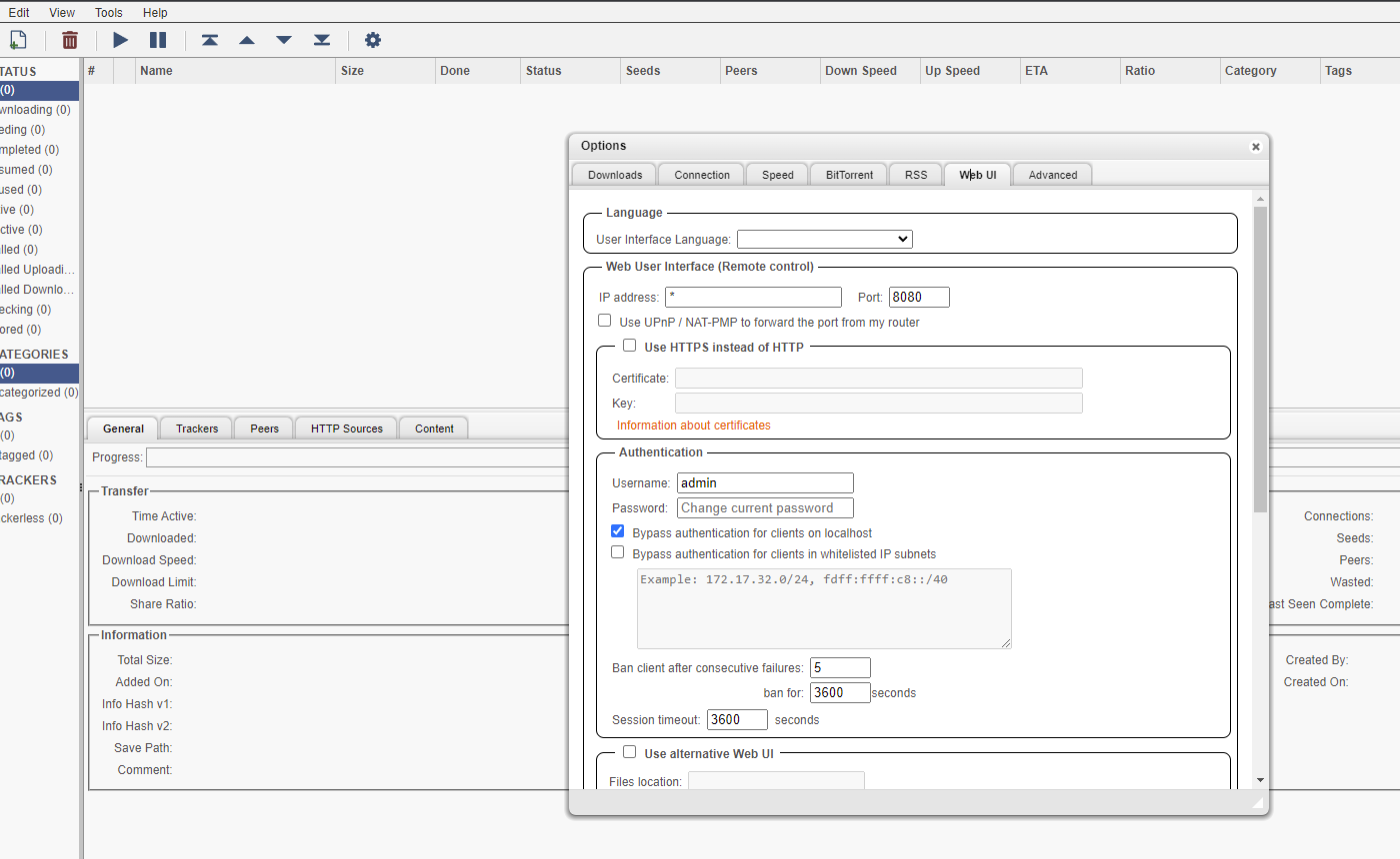

The big problem was my thinking.
I thought the port internally in the kubernetes network should be 8080 as configured in the qbittorrent application but it is using the same port as in the existing configuration which is 10095 in my case.
