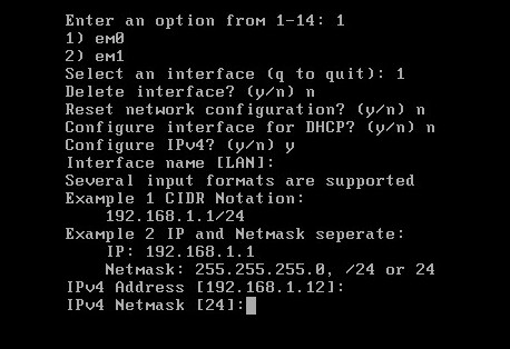

When you select '1' from the console menu, it lists the network interfaces and prompts you to identify the one you want to configure by entering its number. Assuming you have at least one network interface, you should then see a series of questions (much like the how-to you referenced) which let you enter the configuration settings. To specify a static IP address, you must first answer 'n' when asked if you want to configure DHCP.
Does your system list any network interfaces when you select '1' the console menu?
For example, here is what my test system looks like. I have two network interfaces (em0 and em1):
