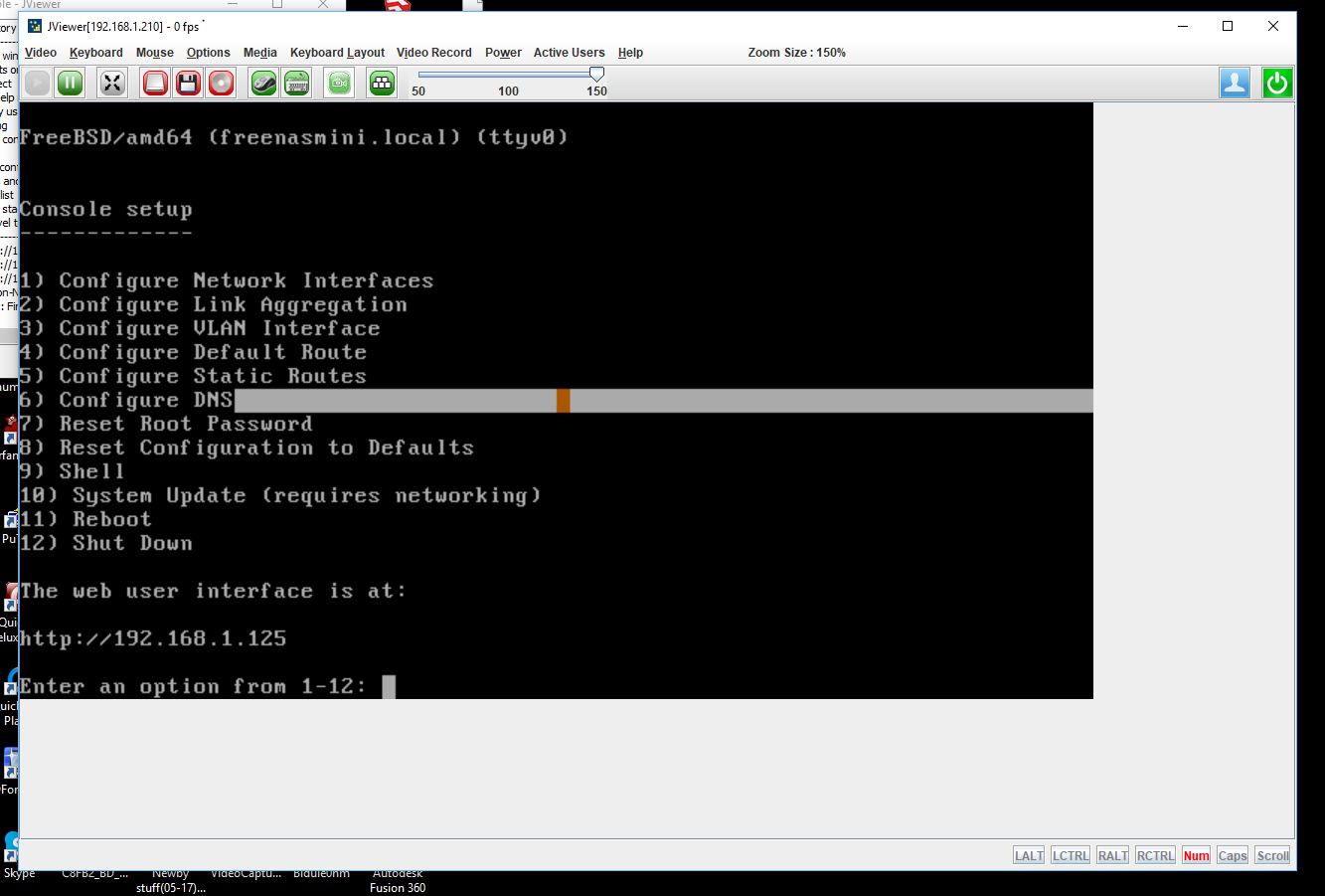

As soon as you are ready to make a trial run, from your laptop client (BTW I'm in windowze-land and don't know how Ubuntu behaves) open up the IPMI screen, click on "Remote Control" and select "Console Redirection", then press the "Java Console" button. Then will have some interaction with Java (maybe even requesting updates to it) but hopefully you will arrive at a point where you have the FreeNAS console window which will contain the web GUI interface IP address... if FreeNAS has indeed booted up successfully.
If it's not there it's likely that your boot device was not selected in BIOS. In that case, leave the console window open and go back to the "Remote Control" tab, but this time select "Server Power Control" and select "Reset Server" radio button (the default) and hit "Perform Action".
Watch the console window as the server reboots and when prompted access the BIOS to adjust the boot order as necessary. Once that is done the server should boot up successfully and the console screen should appear, and you can find the GUI address for FreeNAS.
Once you access it you can capture the MAC addresses and set up the IP's - and you should be good to go.
Let us know how you get on.
I don't really think you need a "Good Luck" wish now as you are so close, but I'll give you one anyway - "Good Luck!" - just in case.
EDIT: Here's a screenshot of what you'll see under "Remote Control, Console Redirection":
