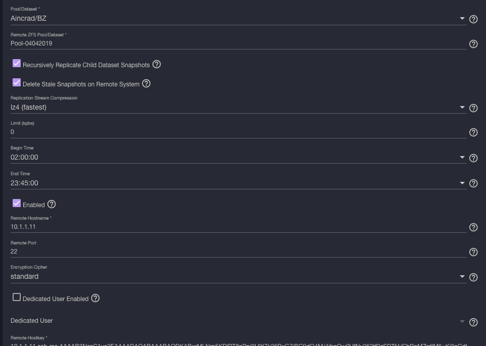

The configuration you're using for the replication job... all details. I guess the compression and encryption would be the most interesting points as this can be the bottleneck.

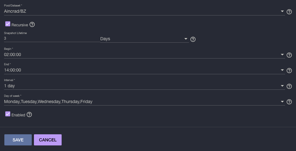

Perhaps it'd be best if I provide a screenshot of the configuration, then.

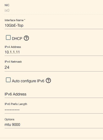

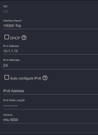

The first things I would look at would be the config of the replication job and the network configuration... perhaps some component isn't handling the jumbo frames and you have re-tries on every frame.
I've confirmed that the network switch is configured for jumbo frames, as are both FreeNAS units.
Let me know if there's any other information I can provide that would be of help. Thank you!

Ok, so you are snapshotting every day and keeping those snaps for 3 days. I'm still thinking that maybe your replication is chasing its tail and the snapshots are expiring before its up-to-date. I'd be tempted to keep your day snapshots for a week or better still two weeks and see if that sorts things out.

I would also consider turning off the compression, since you're not trying to save bandwidth here.
You could think about how acceptable it would be for you to not use encryption (seems to be a LAN thing, so how "shared" is your LAN?). Set it to none if you can.

As per your info, 3 days lifespan for replication is your issue.
As pointed out by @Johnny Fartpants, the snapshots don't live long enough on the source server to be found and compared to on the remote server.
Not a bad idea. Done.

If you can see the graph showing a sawtooth like shape, then it means replication starts from scratch, meaning that the data will be sent over again.
We're a post-production house. We have projects that are often several terabytes in size, and we're juggling a hundred of them at any one time. When a project is done, we offload it to LTO so as to reclaim storage space.
If I extend the lifespan of the snapshots, a project that we remove from the FreeNAS won't actually be able to reclaim the space it occupied until the snapshots have expired.
Then I would maybe consider assigning each project its own dataset.
This is more maintenance on your part, but it will allow you to increase snapshot lifespan and when the project is completed and replication has been finalized, you can then destroy the dataset on the source. ZFS will then free all the blocks locked by the snapshot for that dataset.
The benefit, from having a dataset per project, means that you can recover or replicate projects as needed as opposed to replicating an entire pool just to recover a few files.
This is still debatable in your case, but should open some options.
To which I ask, why is it replicating so slowly?
Well, it all depends what you define slow.
Is it the actual transfer of about 335MBs that is the issue or the fact incremental replication seem to take as long as the first replication?
The answer to your questions are be found within my answers.
In your case, if you are dealing with TBlike files over 100 projects, assuming those files are modified, then you might end up with huge block changes. But that I don't really believe to be the case as your pool is half full. But then again, just for the sake of understanding the issue, it is possible you are making continuous changes to the various project files and those change are being locks up to 3 days every 5 minutes, at the same time, because the lifespan of your snapshots are only 3 days, every minute past the deadline the corresponding snapshot will be destroyed and the blocks freed if they are not locked by another snapshot.
So it is conceivable that what couls have been a simple incremental replication which should be of a reduced size, it is possible the amount of data locked by the newer snapshots will still require a huge amount of data to be transmitted.
You can verify this by running an incremental replication with the -vvv options, but for that you need to run through CLI. I don't know if the replication done throught the GUI shows you the expected amount of data to be sent out.
To monitor traffic, your original approach is not relevant.
What you want is using Netdata (under services) to monitor metrics within the last 24 hours. You want to be able to monitor dataset capaciy usage as well as network activity over those periods. This will give you more useful information than the network bandwidth under the dashboard.
You can aslo look at the RRD from the old GUI, much better than the new Angular based GUI.
