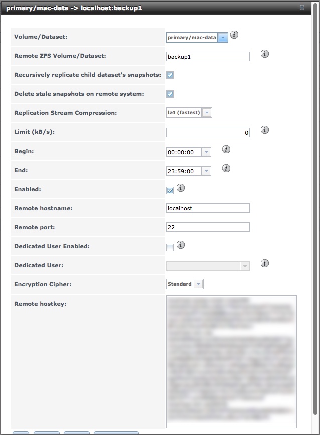

Browsing the volumes in the web gui, it appears the backup used space (602.3GiB) is very close to the source dataset size (602.1GiB). I have daily snapshots setup on the zvol, and here is my replication config:

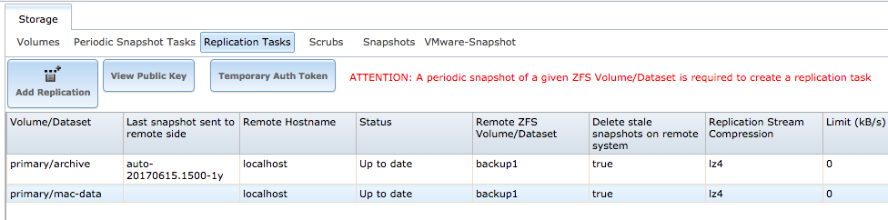

Thanks for the info. Mine shows "Up-To-Date" but the "Last snapshot sent to remote side" is blank:
Is this what you are seeing and believe it is a bug as you reported it?
Are you also having this problem with a zvol or regular dataset?
Thanks again!

When I reported the bug I was using a dataset. It looks like my "Last snapshot sent to remote side" was populated (according to my screenshots)
According to the bug ticket it looks like the issue is scheduled to be resolved in 11.0-u1
