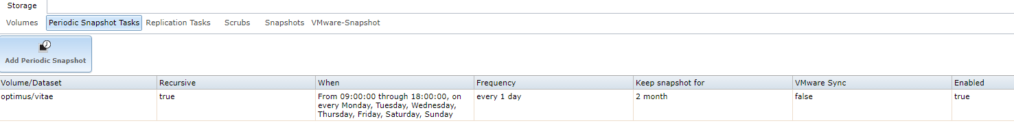

I set the snapshots to expire in 2 months and replication to occur daily. So, I don't think they are expiring before replication...

Attached are screenshots of replication and snapshot tasks.
