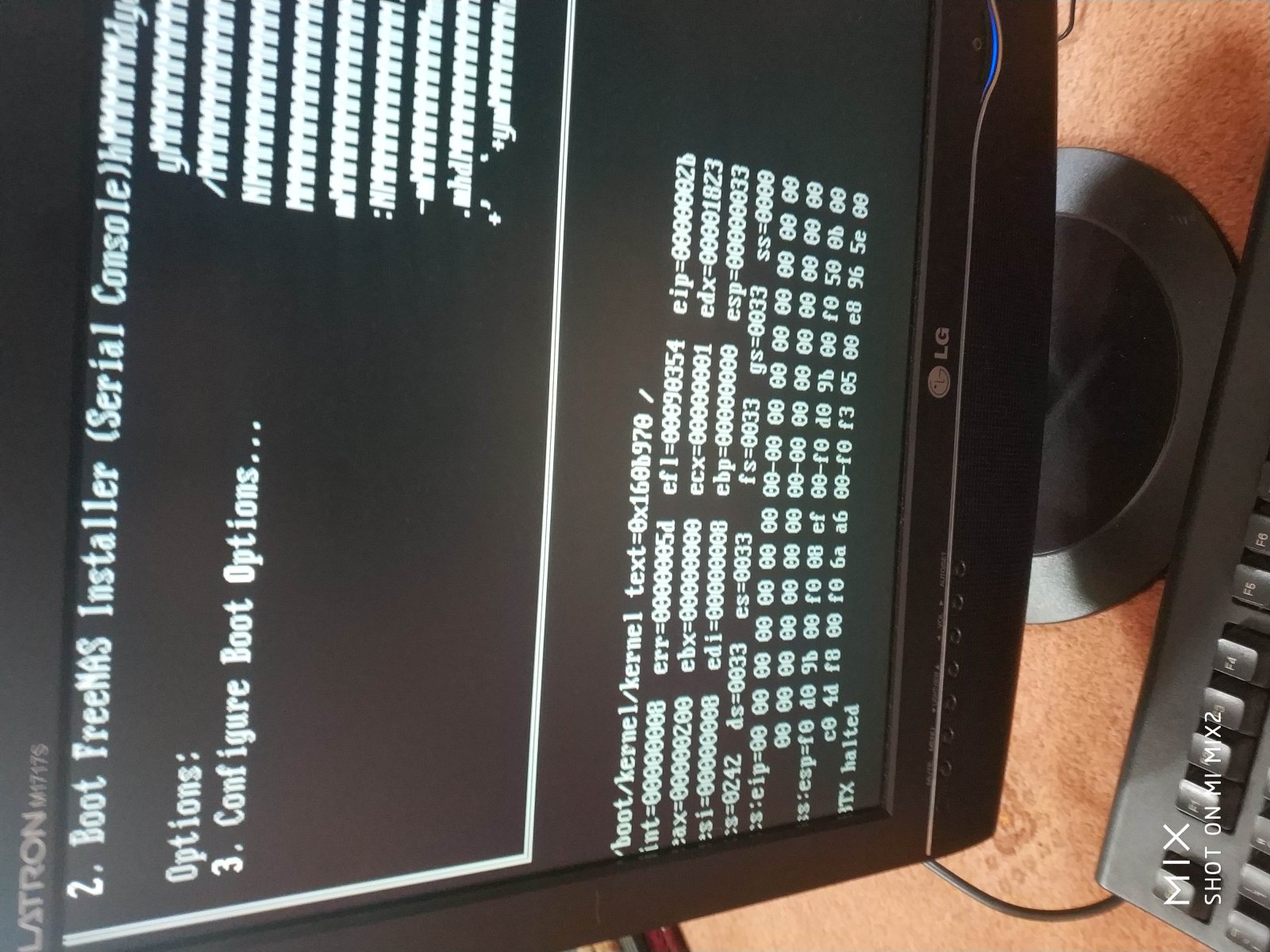

Hi All
non production home box in HP gen 8 everything was showing optimal so decided to upgrade using the gui
on reboot it never came back just losts of hex data and then system halts
diags in the ddm pass so doing a reload now what post install config will I need to do to pull the drives 2 x 3Gb mirror back into the management inc jails
arden
Aug 15, 2014
17
Ok when trying to boot latest from usb get the same is there an issue with hp gen 8 ?
arden
Aug 15, 2014
17
I ended up doing an install and rolled it back to 11.1 not lost any data but did loose a ddm when a cycled the power my guess it was on the way out anyway
found some other posts saying the BTX error is due to 11.2 not liking the B120i raid card in the gen8 microserver
