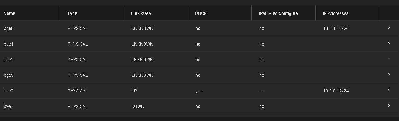

I have a 10.0.0.x IP on the main interface of this system but I also need servers from 10.1.1..x network to have access.
How can I safely do this since the server is in production so I cannot afford to make a mistake and taking down the shares.

If you have an unused interface on the server you can hook this up to the new network, but otherwise just route the traffic to your current interface

Is the second network connected to the same "wire" or reachable via a router? What are the netmasks/prefix lengths of those networks?

All of the networks are on the same switch but have different gateways. They don't need to talk together but when/if they do, that is done via firewall.
So in this case, if I can add a new network on a free interface, I can give machines in the 10.1.1.1 range access to a share on the TN host.

I understand that you cannot add network gear due to power constraints. But why run two separate networks at all if everything is connected to the same broadcast domain, anyway?
Not that you cannot have two interfaces use DHCP. And using static configuration is very much recommended.
I suggest you first go to Network > Global Configuration and statically configure the default gateway and DNS configuration for the network you already have. Then you can change the configuration for bxe0 to a static address.
Once that works you can either add the second address and network to bxe0 or to some other interface if you prefer.

Anyhow, yes, I see why you mention DHCP. I completely forgot about that and didn't even notice it in the image I shared.
This server was configured at another location then dropped off to its new location with DHCP enabled.
The IP is static in that the DHCP server knows about the MAC so assigns the same IP all the time.

First set your default gateway and DNS server, then change your IP address to static, then add your second IP address.
What precisely do you expect? There is no other method but using the UI one step at a time.
The interfaces will toggle (down-up) for a second, but NFS in general is stateless and clients will reconnect or not even notice.

I did as you suggested.
I added a static route, 10.0.0.0.24 and 10.0.0.1 gw.
When I saved it, everything went dark, I lost access to the GUI and all of the clients lost nfs access.
Now I'm on the remote console, removing the static and having to reboot to see what happens.
If that comes back, then I'll have to check the clients since they might need a reboot if they weren't able to reconnect.
I'll update when done but this is what I was trying to avoid by asking plenty of questions before doing anything.
Update: Clients were able to re-connect.

I told you to set the default gateway, not to add a static route for a /24.
To move from DHCP to static configuration:
1. In Network > General Configuration set default gateway and DNS server statically and save.
2. In Network > Interfaces > <your interface> remove DHCP and set the IP address.
