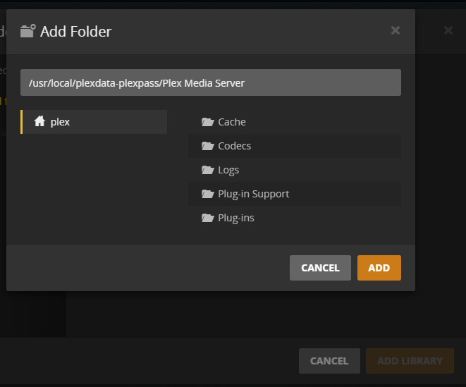

I was able to install plex using your guide. I have mounted 2 datasets into the jail to import my media
I have an issue where the plex doe not show the root directory of the jail(as shown in the attachment)
I have set the Plex to run as media and the dataset is on media permission
I remember it use to have a root directory where i chose the mounted folder ( it was " \")
Just to clarify my situation, since Freenas corral support has been dropped i am moving back to Freenas 9.10
My current version is FreeNAS-11-MASTER-201704270409 (1631dde)
Your looks funny, is your screen size strange? I have attached a screen shot of what it should look like. You can just manually change the path at the top and type in whatever you want. You can't just mount something to / you have to give it a empty folder to mount to.
I also see your didn't learn your lesson from corral. Why are you running the nighties? You are going to have to rebuild at some point if you run the nighty builds.
