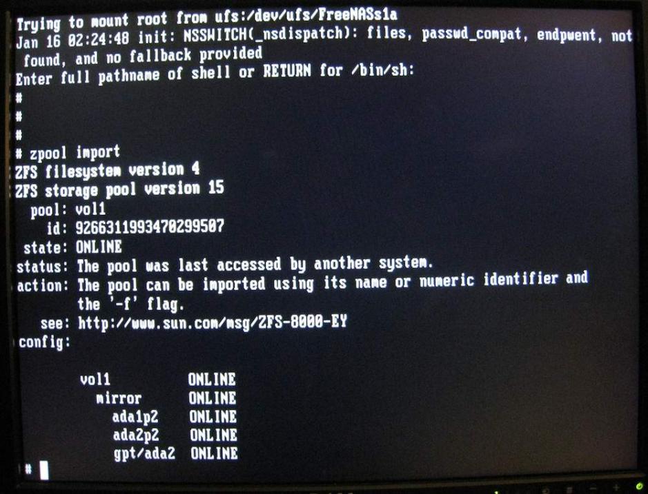

I setup FreeNAS on a new system that I built and created a volume (ZFS mirror) with 3 1TB drives. I created several ZFS datasets and transferred a large amount of data from my old NAS box to the new system. Initially everything was working fine. About a month later, while transferring a large file to my desktop over the network, the FreeNAS box froze and became unresponsive. The only thing I could do was to power cycle the machine. Now, whenever I try to mount the volume, I get a kernel panic.
Example:

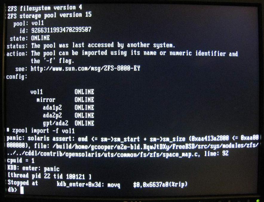

If I boot FreeNAS in single user mode and run zpool import, I get the output in screen_01.jpg.
But when I try zpool import -f vol1, the system crashes. See screen_02.jpg.
I've also tried to mount the volume using FreeBSD, mfsbsd, OpenSolaris, and Ubuntu, but I always get the same result. The output of zpool import makes me think that the volume is OK, so it's frustrating that I'm unable to mount it. Is there something that I'm missing? I'm fairly new to ZFS, so any help would be greatly appreciated.

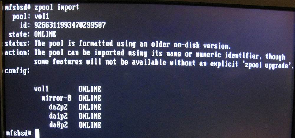

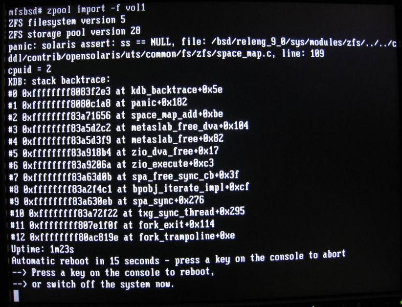

Hi protosd,
Thanks for the reply. I tried to import the volume with mfsbsd. They system still crashes, but with a different error (see attached screenshots). Any other ideas?

I tried both
# zpool import -nfF vol1
and
# zpool import -nfFX vol1
Both resulted in the same crash/message as before - "panic: solaris assert: ss == NULL..."
