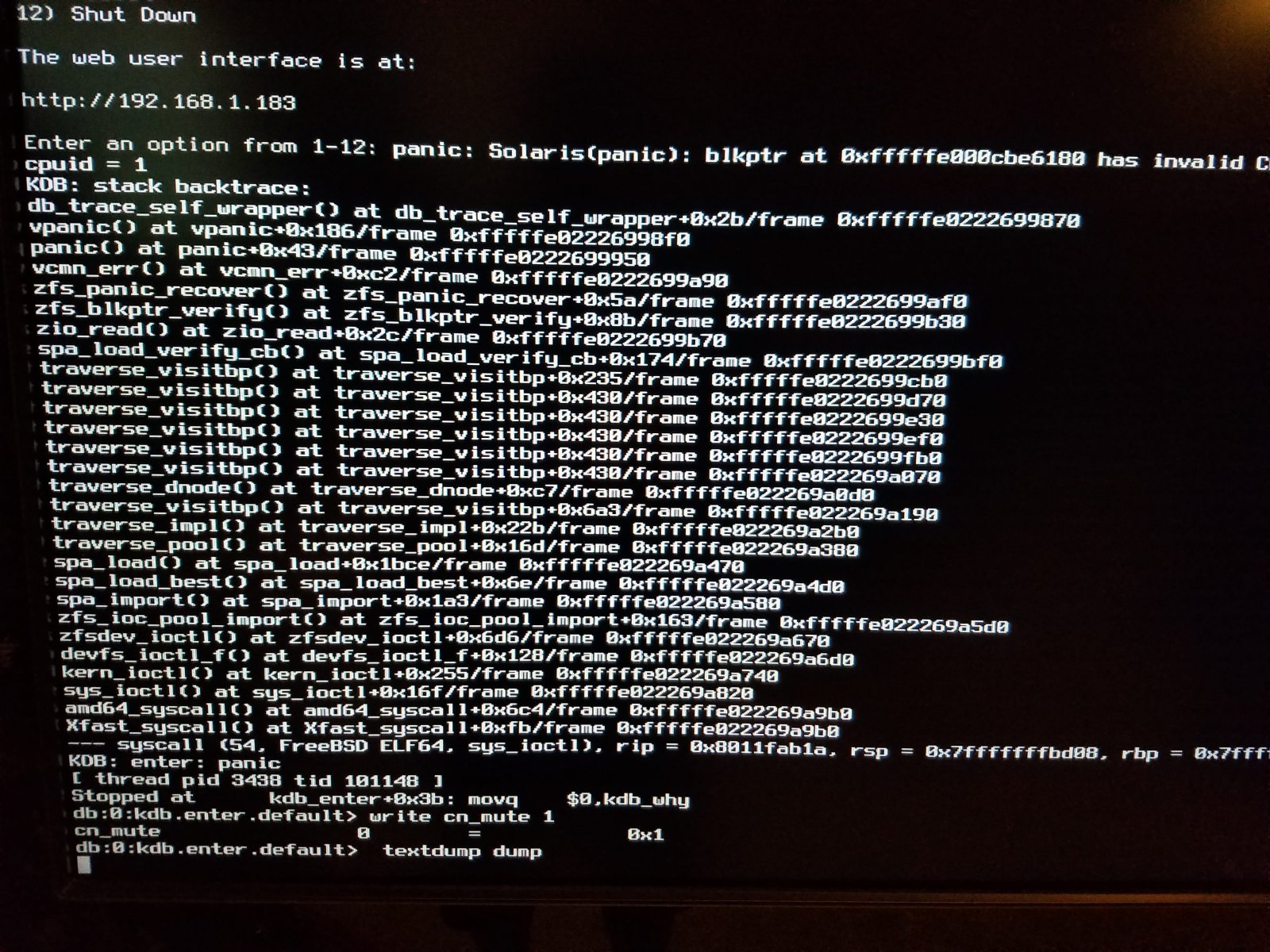

Hi Everyone,
I'm hoping you can help. I've used these forums for almost all of my FreeNAS questions. I very much appreciate your replies to others' problems. This is my first post and I am a relative noob--sorry everyone.
I upgraded to FreeNAS 11 recently and the system seemed to be working fine. After a couple weeks though, the system wouldn't boot--it would get hung up and result in being frozen at KDB: Enter: Panic. So I did a fresh install of FreeNAS 11, and it starts fine.
However, when I go to import volume, I see my ZFS pool in step 1 (it's not encrypted), but when I proceed to step 2, the system fails--giving me the same "KDB: Enter: Panic" error. I get the same error when I run the zpool import -f command. System has error KDB: enter: panic.
I've tested my RAM with Memtest86--no errors. I also tried to see (probably like a noob) if it was one of the drives. I unplugged one at a time, resetting system each time, and then tried to import volume each time. Same error every time with just three of the four drives connected.

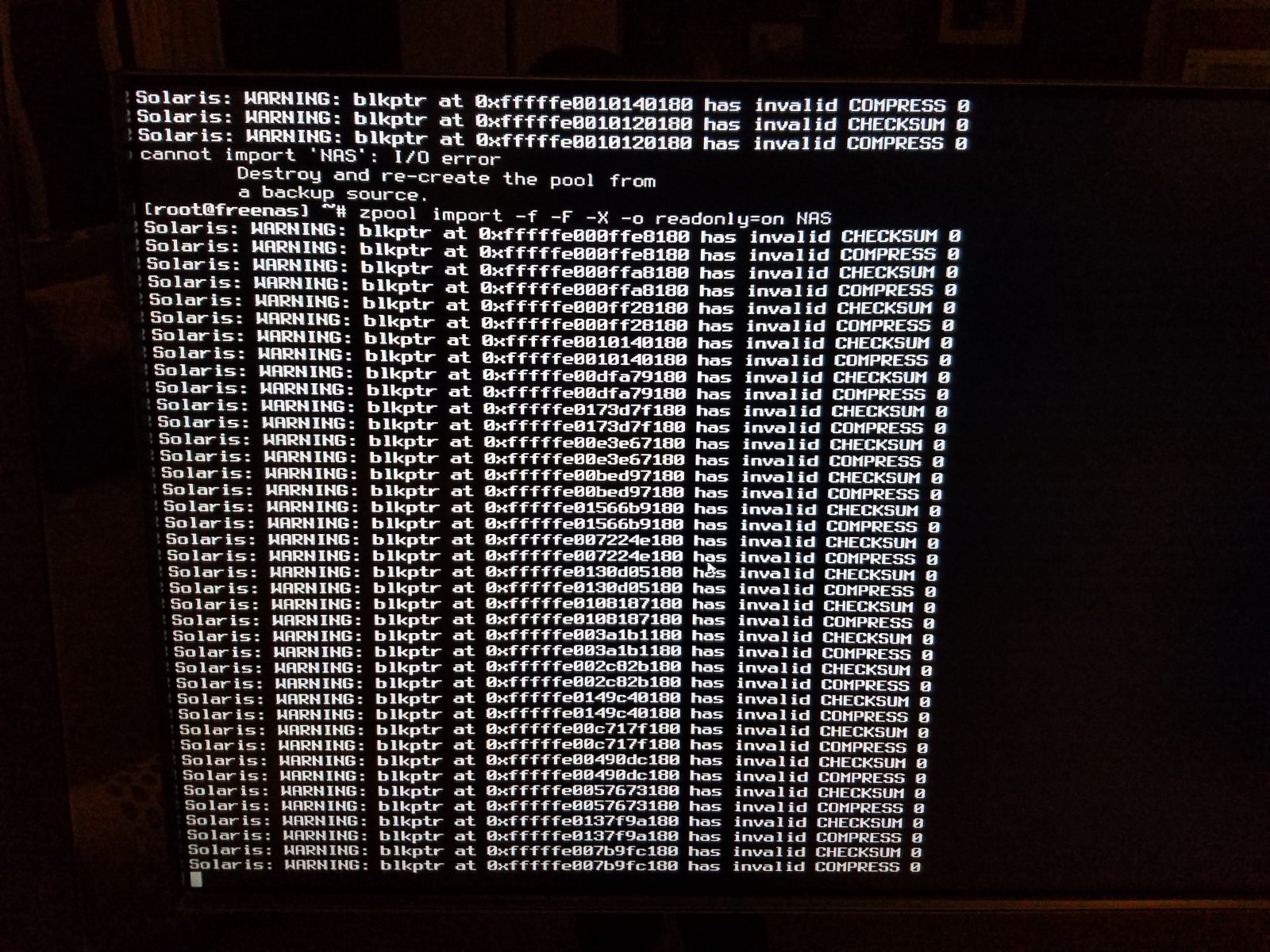

Update: I've been running the command (thanks to a recommendation from rs225)
 zpool import -f -F -X -o readonly=on zpoolname
. It has been running for days. I am getting errors, but it seems to be doing something. I wish there was a way to see what is going on or know what is happening--sad noob world.
See screenshot.
