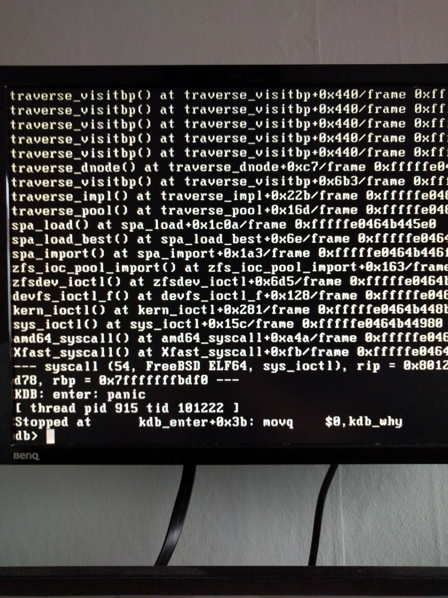

Greetings. A little while ago I decided to build a FreeNAS box. Its got the required specs, and it worked for a little while. Then it didnt. I dont know why, could be improper shut-down? Either way, I got it up and running again (with a new FreeNAS installation and new USB-drive), but I couldnt retrieve the files (I did get to the GUI though), and now it wont boot at all. Included is a screenshot of where it crashes during boot-up. I have come to understand that I dont have the sufficient knowledge of NAS systems to run FreeNAS, as I seem to run into issues with it. If someone can help out, or point me in the right direction to log onto the NAS Id be supremely happy.
D
dlavigne
Guest
That looks like a bad USB stick. What size and model of stick are you using?

You also need to tell us the steps that were taken to try and access the files.
sizetwo
Jan 11, 2018
16
Well - initially I got similar errors. I reinstalled FreeNAS on a new USB drive and got it to boot up again. When I was in the GUI I could see that there was a filesystem (Im sorry I dont have the proper terminology) on there, consisting of the apx. 5 TB of data on the NAS. I was reading the forums on how to access the data again, but I couldnt within FreeNAS. I gave up and let it just sit for a while, turned off. I thought I would give it one more shot, which is what Im doing now. Would it help to reinstall the USB drive with a clean version of FreeNAS to make it boot up again perhaps?

Ok I got it to boot after doing a reinstall. I am in the logged onto the system, and I remember trying the "Import Volume" function without success last time, as thats what I found when I searched for a solution last time. Since I probably did something wrong I wont try it again. Any pointers on how to proceed? I dont believe I have an encrypted ZFS volume.

I tried using the "import volume" function in the GUI, and could see the box reboot during step 2 of this process. Then FreeNAS crashing at the same point as in the original image uploaded here. So thats probably what happened last time... So that probably means I have to reinstall once more to the USB disk, and I guess I cant use the "Import volume" function? Brrrr.. Frustrating to deal with stuff that I dont quite understand ;)

Checked - I have 16GB of memory, thought I had 8. Sorry. Intel I5-3570 CPU @3.4 GHz. DDR3 16384 MB. So hardware wise I guess I should be fine.
If you read my comment above, what happens when I choose Storage > Import Volume is that the box restarts, and then it wont boot again. Stops at the screen posted in my first post on top here... Then I have to reinstall FreeNAS again onto my USB drive...

Try zpool import -f 10617402812746887365 followed by a reboot.
sizetwo
Jan 11, 2018
16
Done. It did reboot on its own, and started up again. It did seem to give some error messages while rebooting, though, but started up. Not quite sure what the normal boot-routine looks like. Im back in the GUI now but I cant see any volumes under "Storage". To me nothing looks different from before I tried it. I cant find a good way to output the "messages" log file here if that can help clear up whats happening ... or if I am missing something completely.
