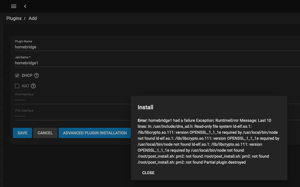

I'm new to TrueNAS, I'm trying to do a fair amount with it from the get go and I'm going to use an old computer to host a number of things;
  • Wordpress Sandbox for web development
  • SAB downloader
  • Plex Host
  • some other project types as well.
For some reason I've run into loads of issues try to get started, including not being able to install apps and flip flopping between letting me create jails and then not giving me and SSL permissions.
I'm also getting VNET issues which I can't seem to figure out.
I've just installed the latest update but still no dice. Can anyone help me with the installing of apps?
I get as far as 50% -ffmpeg and then it fails with this alert.
Would appreciate the help.

Welcome to the forums!
I think you need to do some reading - TrueNAS requires 8GB ram minimum. Based on the paucity of info you provided, I can't hazard a guess at other issues you may have. Find the docs on the masthead at at https://www.truenas.com/docs/
Please read the Forum Rules (in RED on the masthead) or https://www.truenas.com/community/threads/forum-rules.45124/ , supply the info. and likely someone that knows the AMD platforms will give you some advice.
Good luck.

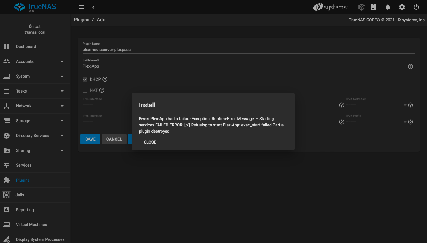

This appears to be the same issue I am having. My machine is running 128GB of ECC RAM so its not a lack of resources. Tried a reboot and upgrade to 12.0 u7. I get to 75% and then this message shows.

@jgreco Why are you avoiding my questions? I'm getting the same issue.
Tried to create a test jail today and it failed again, on both of my machines with PLENTY of resources. Both using dual Xeon processors.
Alecmascot
Mar 18, 2014
1,177
Trace back shows "read-only filesystem" ?

Oct 22, 2019
3,641
Does your iocage dataset have "Exec=off" and/or "ReadOnly=on" by any chance?
zfs list -o name,exec,readonly nameofpool/iocage
Oct 22, 2019
3,641
An alternative approach (which is what I personally use), is to manually create the jail and install Plex, rather than use the "Plugins" method.
  1. Create a new jail, either through Basic or Advanced creation
    • Name it plex
    • I prefer Basejail (instead of Clone Jail), but to each their own
    • Select the matching release based on your "uname -r" output (Likely to be 12.2-RELEASE)
    • Enable DHCP, which should also automatically enable VNET and Berkeley Packet Filter
    • Make sure NAT is disabled
    • The rest of the options can be left at their defaults (They can always be changed later)
  2. Add your mount points for this jail (such as the dataset(s) / folder(s) where your media will reside)
  3. Enter the jail's console
    • Code:
      iocage console -f plex
  4. Install and configure Plex (you might be prompted for first-time commands)
    • Code:
      pkg update
      pkg upgrade
      pkg install plexmediaserver
      pkg install ffmpeg
      sysrc plexmediaserver_enable=YES
  5. Exit and restart the jail
  6. Try to access the Plex Web GUI via its IP address (optionally through app.plex.tv)
  7. You're likely going to need to modify the permissions on the media dataset(s) / folder(s), either via ACL or standard Unix permissions. At minimum, the user "plex" or group "plex" (UID/GID: 972) needs read access on the files, and read/exec access on the folders. Since no such user currently exists in your server (only the jail), you need to add a user named "plex" as UID/GID 972, via Accounts -> Users
Some of the above steps are not unique to the manual jail creation method. In fact, Steps #2, #6, and #7 are still required if using the "Plugin" method, anyways.
