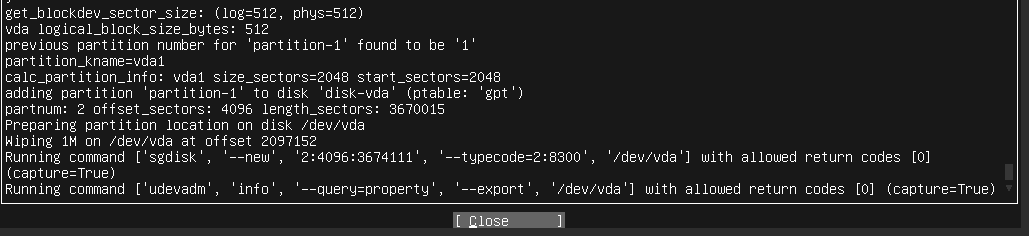

Just installed 22.02.3 release. Cannot get Ubuntu 20.04 or 22.04 to install into a VM. Is there anything special I need to do? I've tried using VirtIO for both storage and network, nothing will allow the installation to complete. Keeps getting stuck at various points, commonly during simple disk prepare/partitioning.

For the Ubuntu VM there's no error really, it just hangs at various places like partitioning or the initial fetching of packages at the beginning of the install. Trying to do anything within the installer from that point does nothing. I once got a screen that it crashed and asked to send to Canonical so I did. I actually let it sit, while at lunch, nothing changed in over an hour and I just powered it off and deleted it.

I just tried again with Ubuntu 22.04 and it hangs/clocks on "configuring partition: partition-1"

It seems like Ubuntu is trying to use a physical drive.....not accepting a logical volume.
My guess is Debian would work fine... can you check with Ubuntu forums on their "drive requirements"? (found this here.. https://ostechnix.com/install-ubuntu-desktop/ )
Can you document specifically how you set-up the VM and the options you chose... perhaps someone will see where there is an alternative approach.

UPDATE
Played around more. Finally got Ubuntu 22.04 to install under TrueNAS Scale as a VM. I did ensure that I used Legacy BIOS and VirtIO if that was an option presented from the VM configuration.
I think the one thing that might have made it successful was I "pre-created" a z-vol and in the VM configuration setup pointed to that device then the disk partitioning worked so the Ubuntu installer worked. Seems if you allow TrueNAS Scale to create the z-vol as part of the VM configuration it messes up the Ubuntu installer for some reason.
