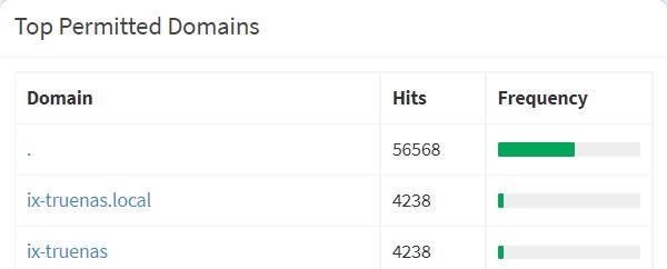

Recently I have created bridge on truenas scale with option -syncpeer to enable multicast for my homeassistance VM.
Now I see 65000+ requests per day from truenas ip (see screenshot). Homeassistance VM has different ip and i didn't see that behaviour when I was running it on dedicated hardware. Also "ix-truenas" isn't what I set form my host name. Have no idea where it coming from...
It doesn't look like normal behaviour too me.

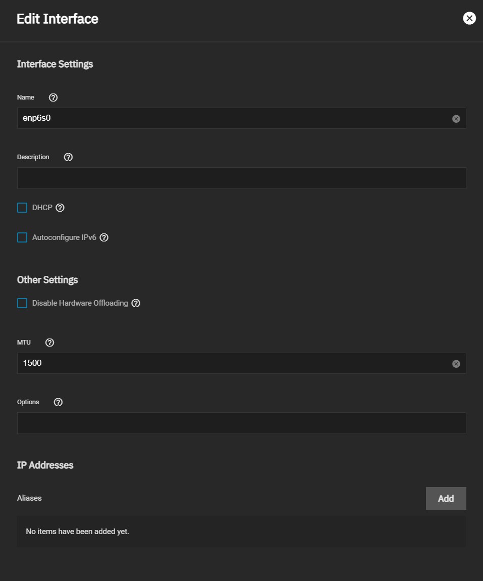

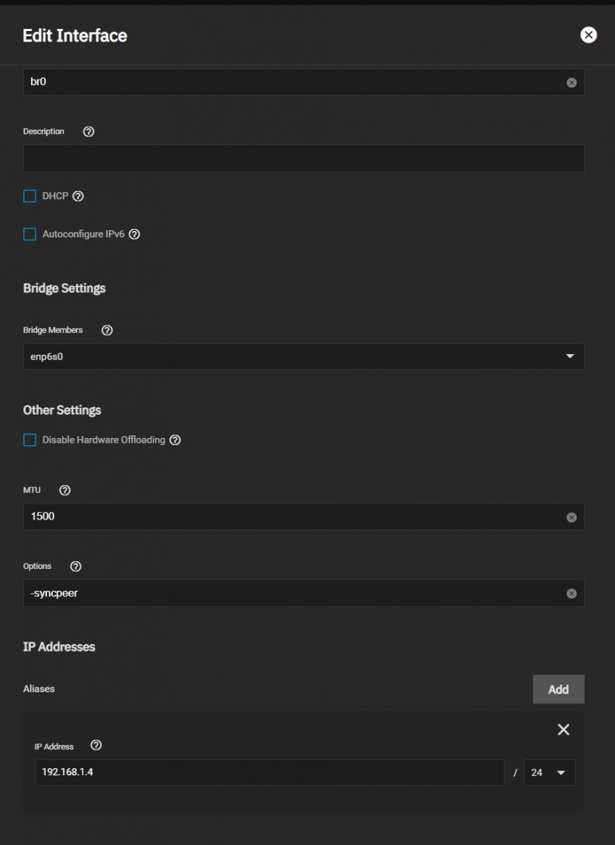

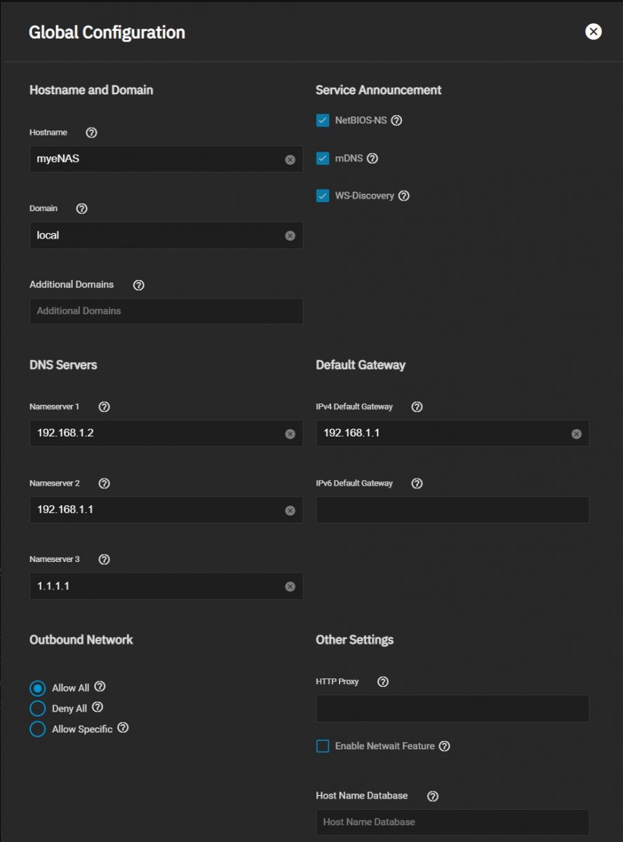

Added screenshots of my network settings.

tried with out -syncpeer - not much difference. ns request still going out just every 2 sec ish.. instead of every 1 sec.
