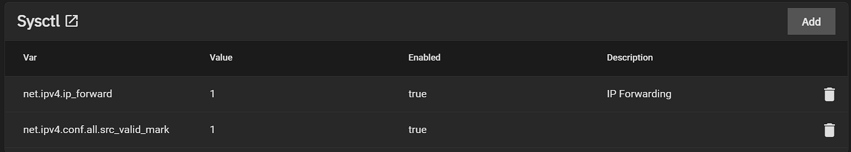

Maybe add the following in System -> Advanced -> Sysctl

I already had the net.ip4.ip_forward command set, i haven't set the 2nd cmd in your screenshot however. I will give it a go.

Thaks for suggestion but your 2nd command "net.ipv4.conf.all.src_valid_mark" value = to 1 has completely broke my LAN, i can no longer access the TrueNAS itself on IP 192.168.225.250 let alone do DNS lookups on the Pihole DNS docker container running on it. I will now need to reset the NIC via console access.

Ignore the above reply, it didn't break anything it turns out. Still unable to ping pihole IP from OpenVPN client though unfortunately.
Oh well, I use Wireguard personally so figured it might help, good luck with this, someone should help

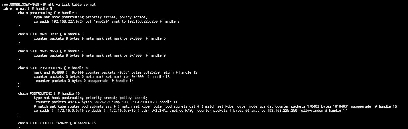

Because my TrueNAS Scale box is on my local LAN (192.168.225.250) in 192.168.225.0/24 subnet and the PiHole docker is also allocated a static IP (192.168.225.251) in this same local subnet, i'm thinking i may need to do an extra route from OpenVPN subnet 192.168.227.0/24 through the kubernetes routing as can be seen in above screenshot?
I'm clutching at straws here but i'm thinking even though piHole is on local LAN, as far as a OpenVPN client is concerned it cannot just access the PiHole docker (192.168.225.251) as if it was a local LAN device even with the postrouting below set which can be seen in above screenshot:
#!/usr/sbin/nft -f
table ip nat {
        chain postrouting {
                type nat hook postrouting priority srcnat; policy accept;
                ip saddr 192.168.227.0/24 oif "enp2s0" snat to 192.168.225.250
As there's actually a Kubernetes networking stack between the TrueNAS itself 192.168.225.250 and the piHole docker running on it - 192.168.225.251.
I think i need to somehow link these up with a specific static route. Once again open to help with this as network routing is not my strong suit.
