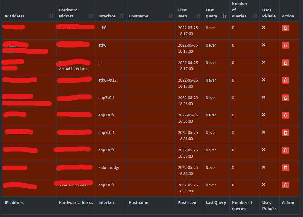

hello, I installed pihole on my truenas scale install today and everything went well. but the problem I am having is that after I switch my network dns to be piehole I no longer have any internet. I'm using a new asus router and i when I set the wan dns to the nas ip i don't get internet and when i set the lan dhcp dns to the server it doesn't block any adds. Would someone know what I am doing wrong here?

It seems nothing on my network is using pihole and when I set the dns manually on my pc the internet won't work anymore when i point it to my pihole server. I set up the default docker app in scale, am I supposed to do something in pihole?
