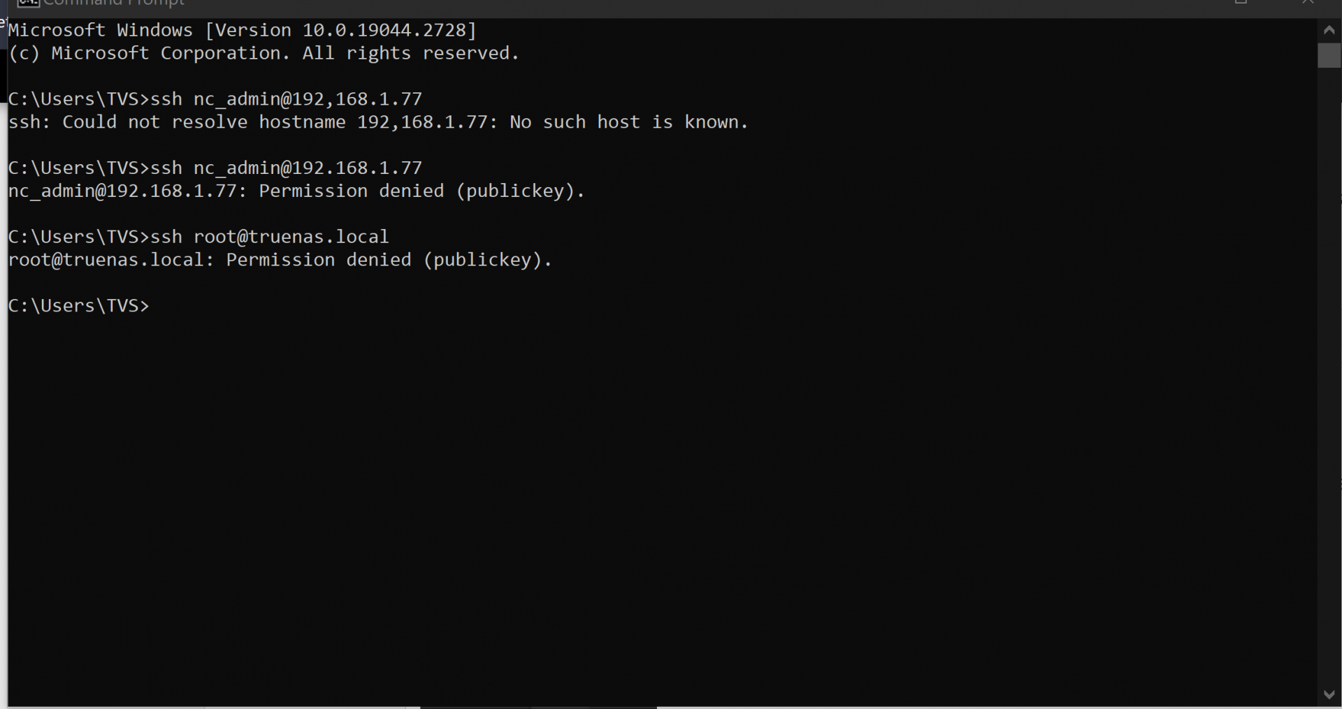

I ran into this issue as well, but have not figured out how to get it to work yet. I'm still learning Shell and SSH stuff so trying to figure out how to get where I need to go to enter the code to disable maintenance mode. Did you run in the internal shell within the app or go to Command Prompt and enter in something? Looking for step by step instructions from the beginning please:).

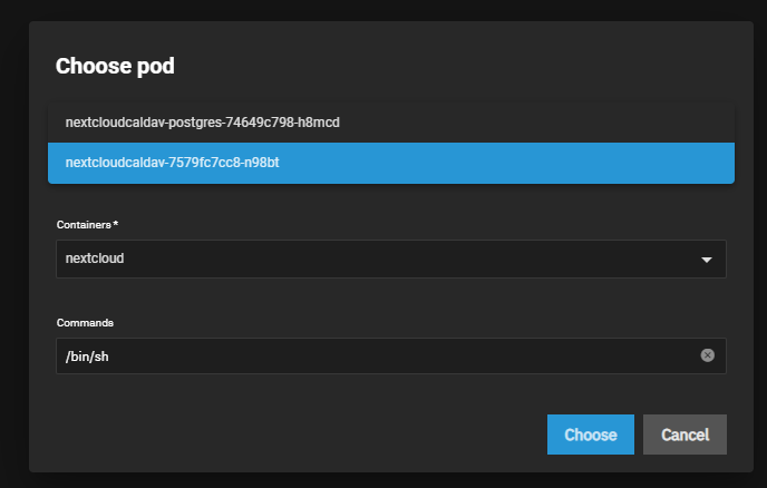

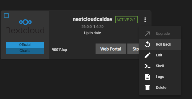

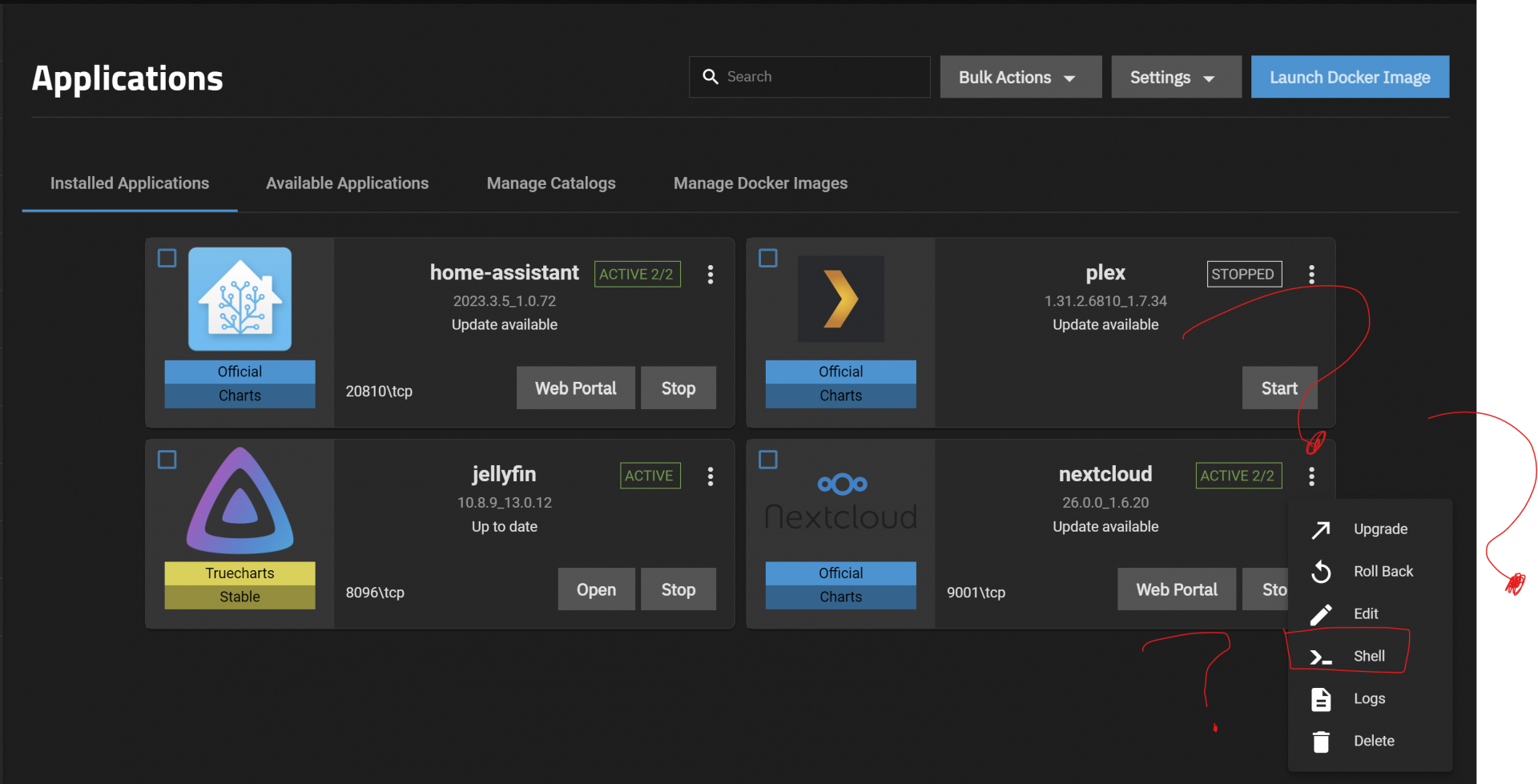

From the Apps menu, I ran a Shell session from within the NextCloud application.
I selected the Nextcloud container, not the postgres database.
Then I typed the following commands in sequence:
su su -m www-data -c 'php /var/www/html/occ maintenance:mode --off'
Logged back into Nextcloud's web UI and was then greeted with the button for continuing with the upgrade. That got me back up and running again.
