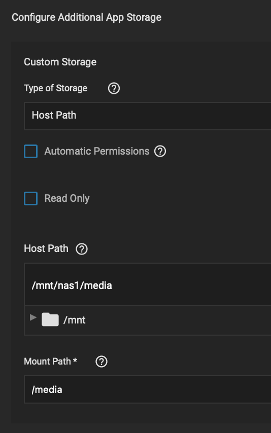

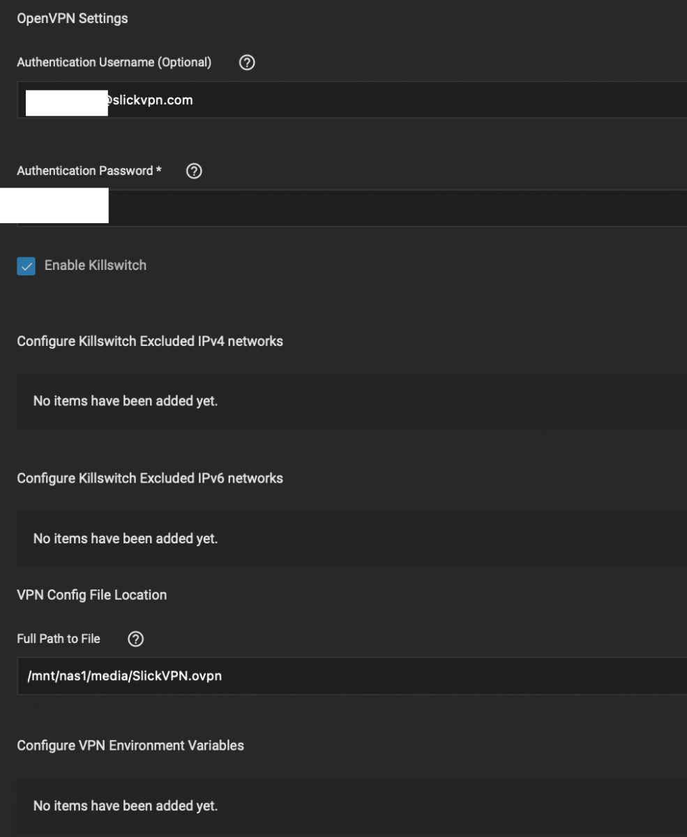

I have two k3s apps that use openvpn, sabnzbd and transmission. Both apps work fine when I configure openvpn however when I configure a local disk to store downloads from my NAS the mount will not work but the app still runs, I see no errors. If I remove the openvpn configuration then the local files mount as expected.
It seems I cannot use both openvpn and mount local files from my NAS on either of these apps, only the vpn mount will work and I do not see any local files mounted.
I have tried using other openvpn config mount paths, same results.
Has/Can anyone else see this issue?

I assume you mean a local dataset on ZFS....... not disks?
Which software version?
linit
Aug 25, 2018
9
Yes, ZFS. I am using TrueNAS-SCALE-22.02.4. I may have a work around, it seems openvpn mounts to /vpn. If I change my ZFS mounts for these apps to use this mountpoint, I can mount the ZFS volume(i.e. mount to /vpn/media). I should be able to mount to other mount points like /meda or /mnt, etc but cannot.
