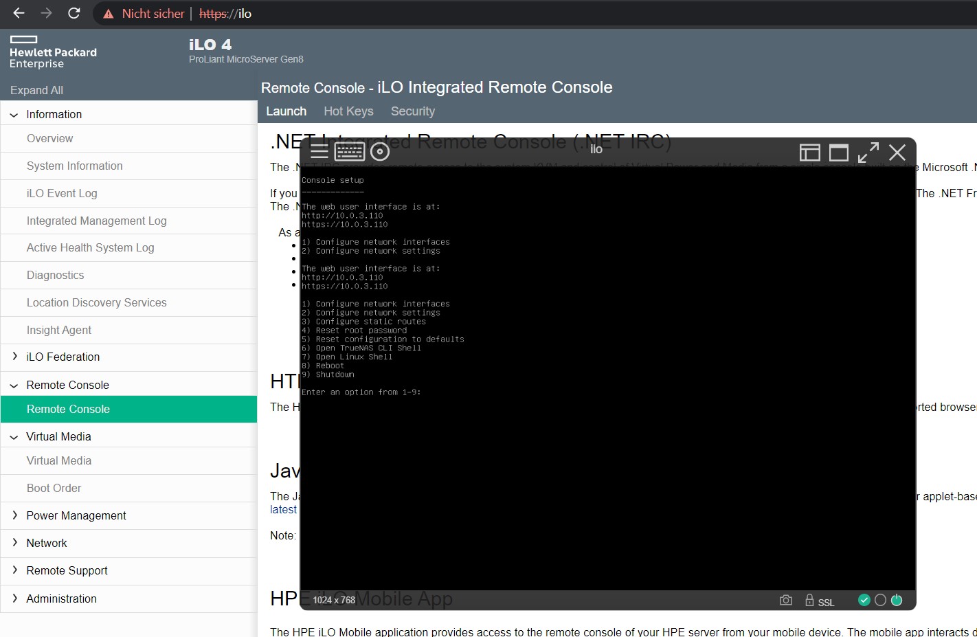

edit: The USB port is bootable. I've previously booted installation media from it. Now that I have iLO set-up I have been installing from remotely mounted media.
