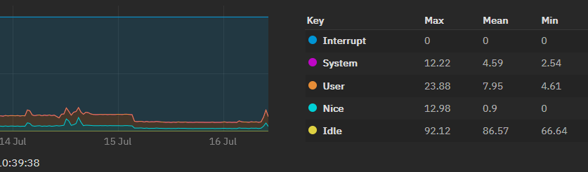

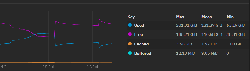

Nothing happening really that should be correlated, also I don't have any memory or CPU issues (2x E5-2680v3 (12C/24T) and 256GB DDR4-ECC RAM)
Something to track memory usage? Are the reporting graphs any use? Or do you need to find something like vmstat or iostat or some other stat to generate a time series.
Memory and CPU usage is in no way abnormal, the breaking points in the memory graph are the restarts at 3AM.

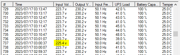

However, a second TrueNAS machine which was on the temporarily same UPS (only added 1 day before the issue started happening) also restarted around the same time (came back online at 3:02:25). So it seems to be power related.
I can see a tiny fluctuation in the -input- voltage of the UPS at that time, however output voltage stays the same. I've ran a UPS self-test.
I'm going to remove the second TrueNAS box from the UPS for now and see if the issue persists.
