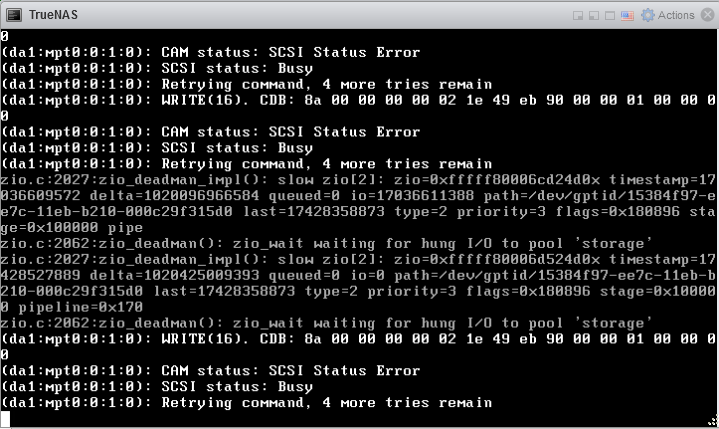

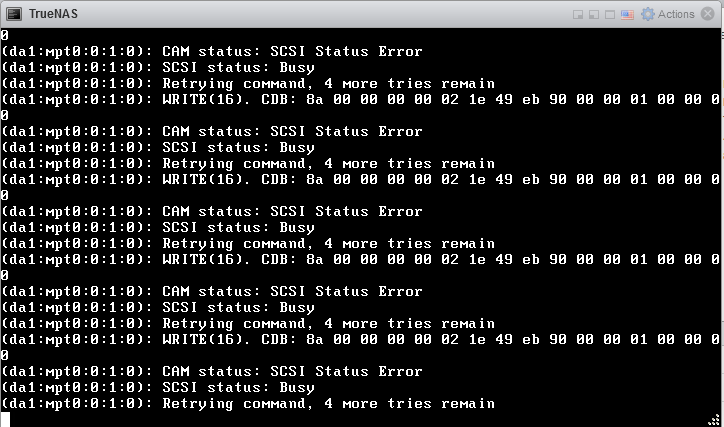

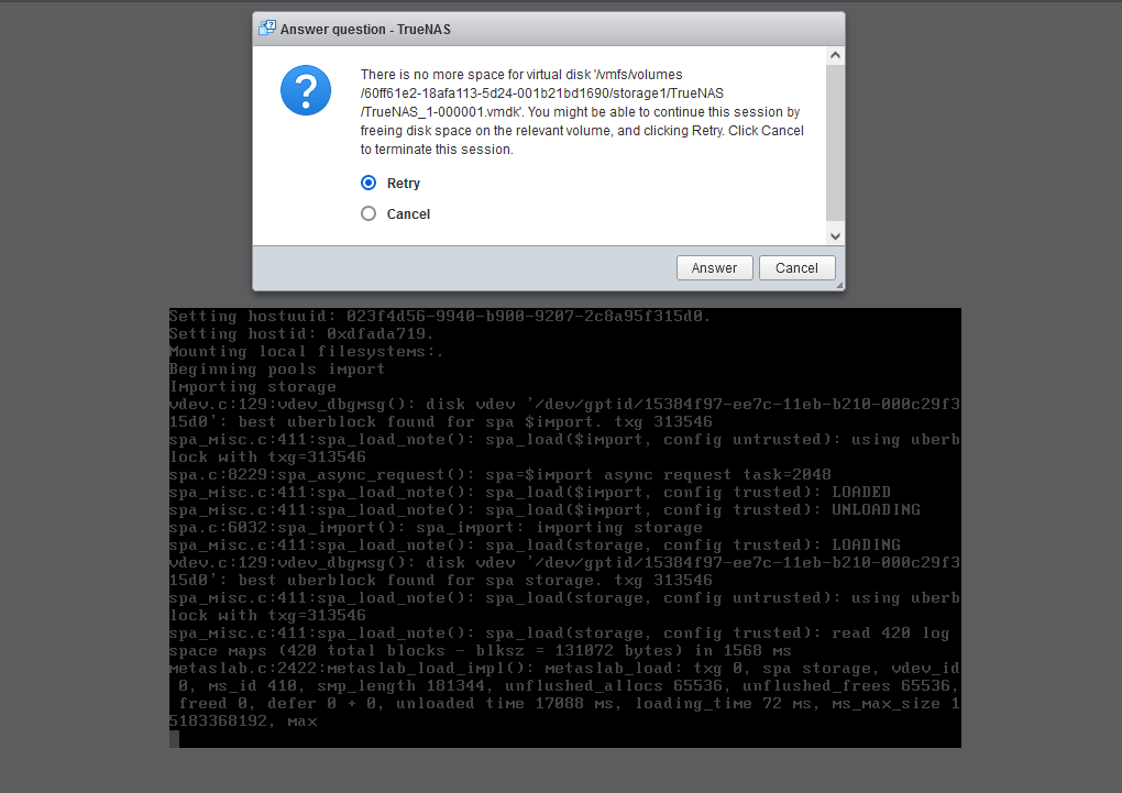

I am having trouble with my ESXi VM of TrueNAS running the latest release. I rebooted the TrueNAS VM and now it wont boot with the following errors. It seems that ESXi doesnt believe there is anymore space on the drives, but I know for a fact that they were at like 3-4TB of the 8TB drives. Its two 8TB drives in a mirrored setup. Before rebooting TrueNAS showed something like 4TB free in the pool. This server was running fine, today I tried installing ZoneMinder, it froze at MySQL installation 50%, tried the install again and nothing happened. So i rebooted the server and it failed to boot. This had been running fine for around 1 month prior.

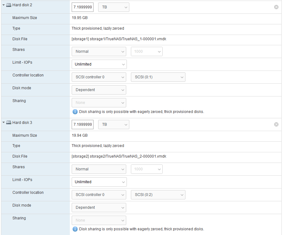

Well, you have it written right under your nose...
You have Hard Disk No 2 that is configured as 7.2 TB. In the same way, HD No3 is using the same space : 7.2 TB. Also, both of them are thick provisioned. That means that ESX will mark as used 100% of the space dedicated for these drives. Overall you asked ESX to provision 14.4 TB when yourself said that you have less than 8.
You will have to destroy that VM and re-create it with drives much smaller than that, small enough to fit in your ESX storage.
