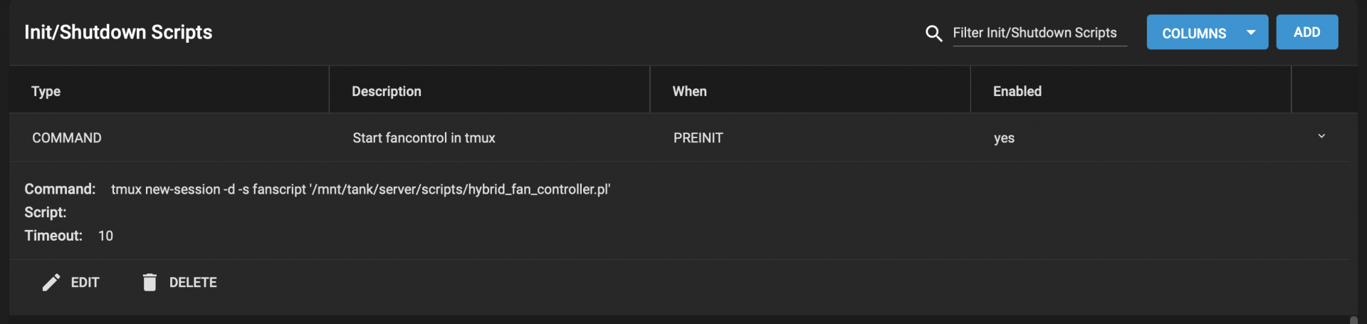

i find the best way is to launch it as a tmux session. This prevents it from being killed if middlewared crashes, and also allows you to tmux into it to view its output at anytime. Just remember to disconnect properly (ctrl-b d)
The command to start the script that I use is something like:
tmux new-session -d -s fanscript '/mnt/tank/server/scripts/hybrid_fan_controller.pl'
You can then connect to the "fanscript" session with:
tmux a -t fanscript
