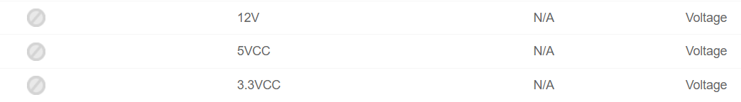

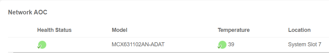

This is the reported wattage with the system powered off:
Not sure whats going on there. The system is OFF.

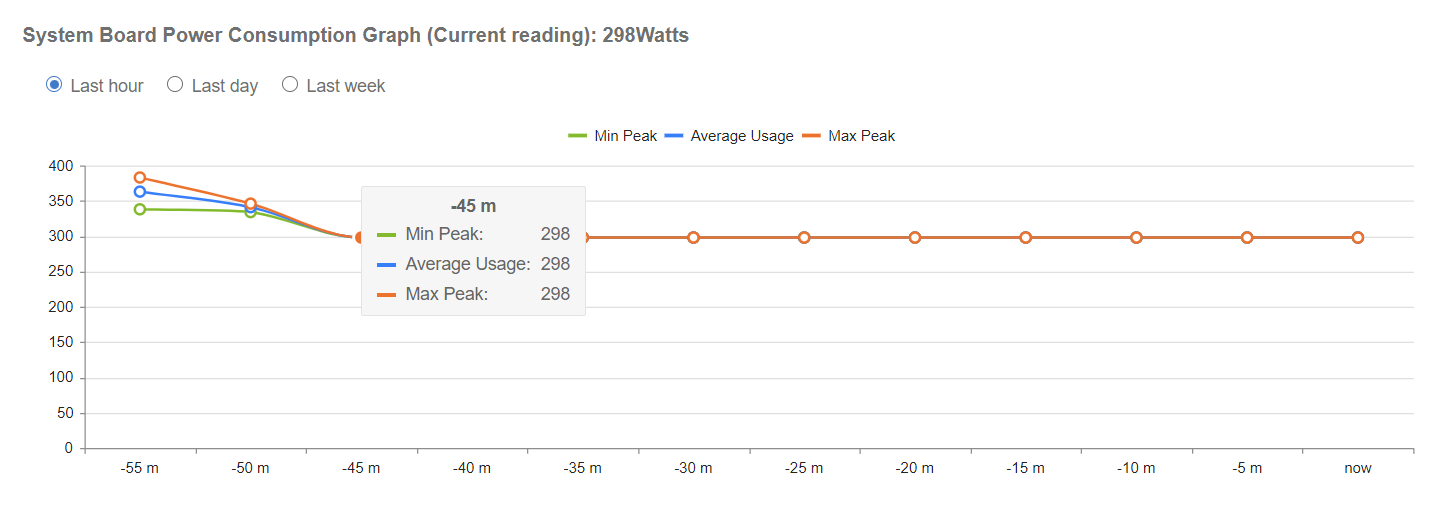

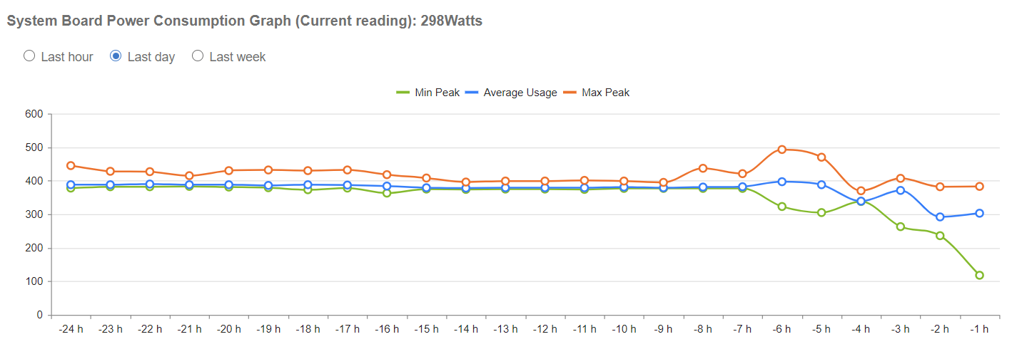

Looking at the power draw over the last 6 hours when this started, I actually pulled 48 SSDs out and while the average power draw decreated, the peak power draw doesn't look like it changed at all:

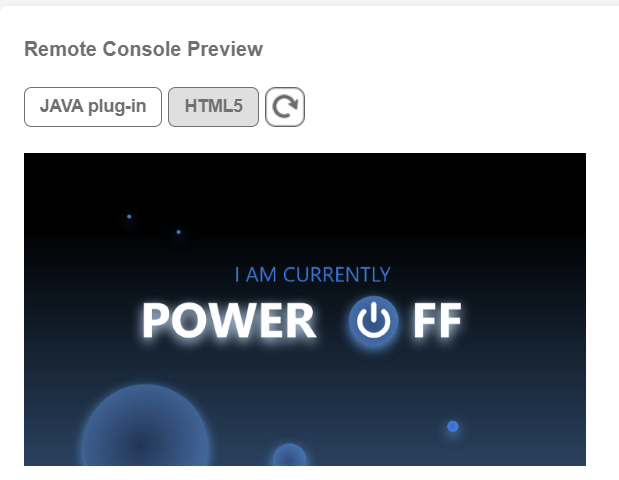

Just to be clear, the system really is powered off:

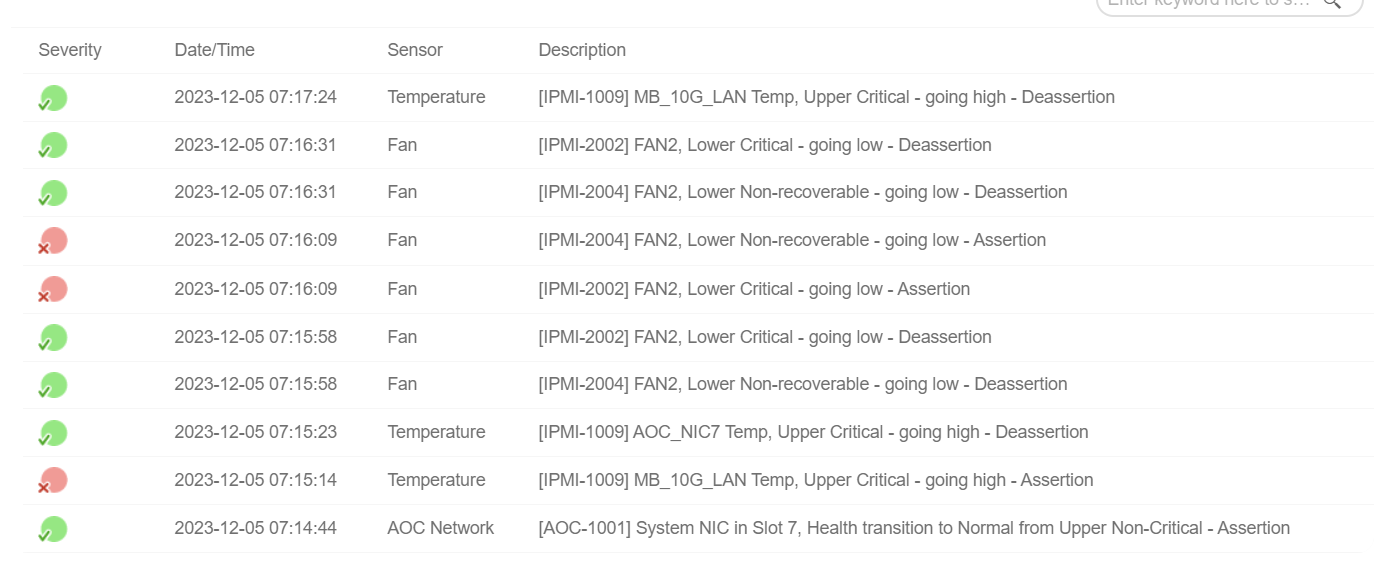

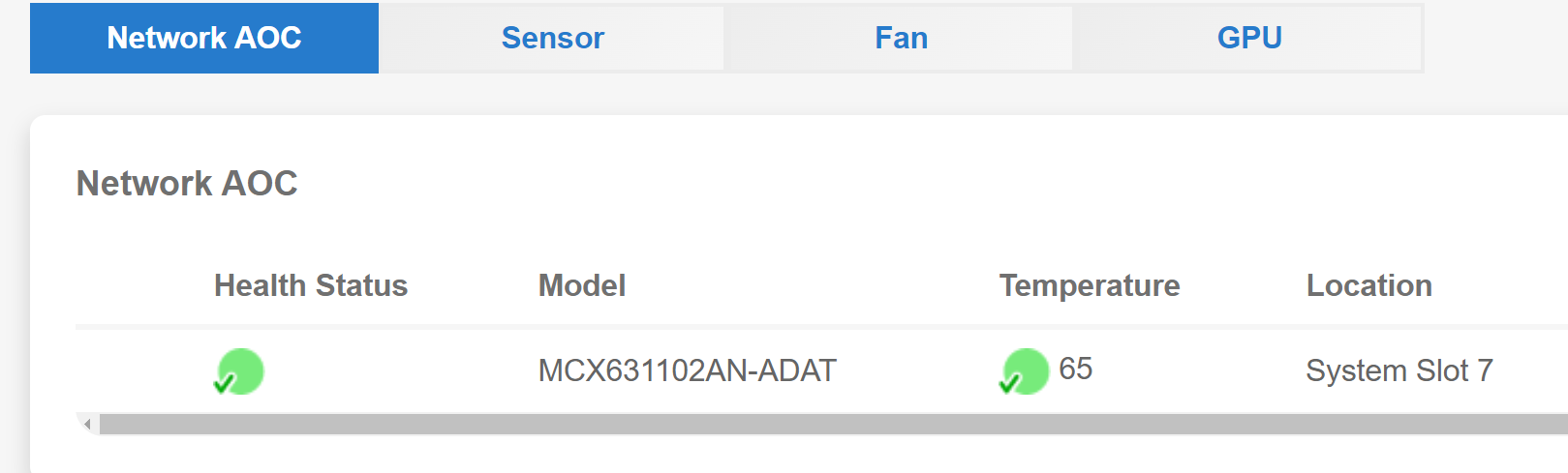

I also checked the temps on my CPU and other hardware from the motherboard's IPMI panel. Everything seems in order. Processor is at 60C idle, but it's a 16-core Epyc with a half-height cooler and a single 60mm Noctua fan. I don't think 60C would force a reboot considering processors tend to throttle around 90-100C.

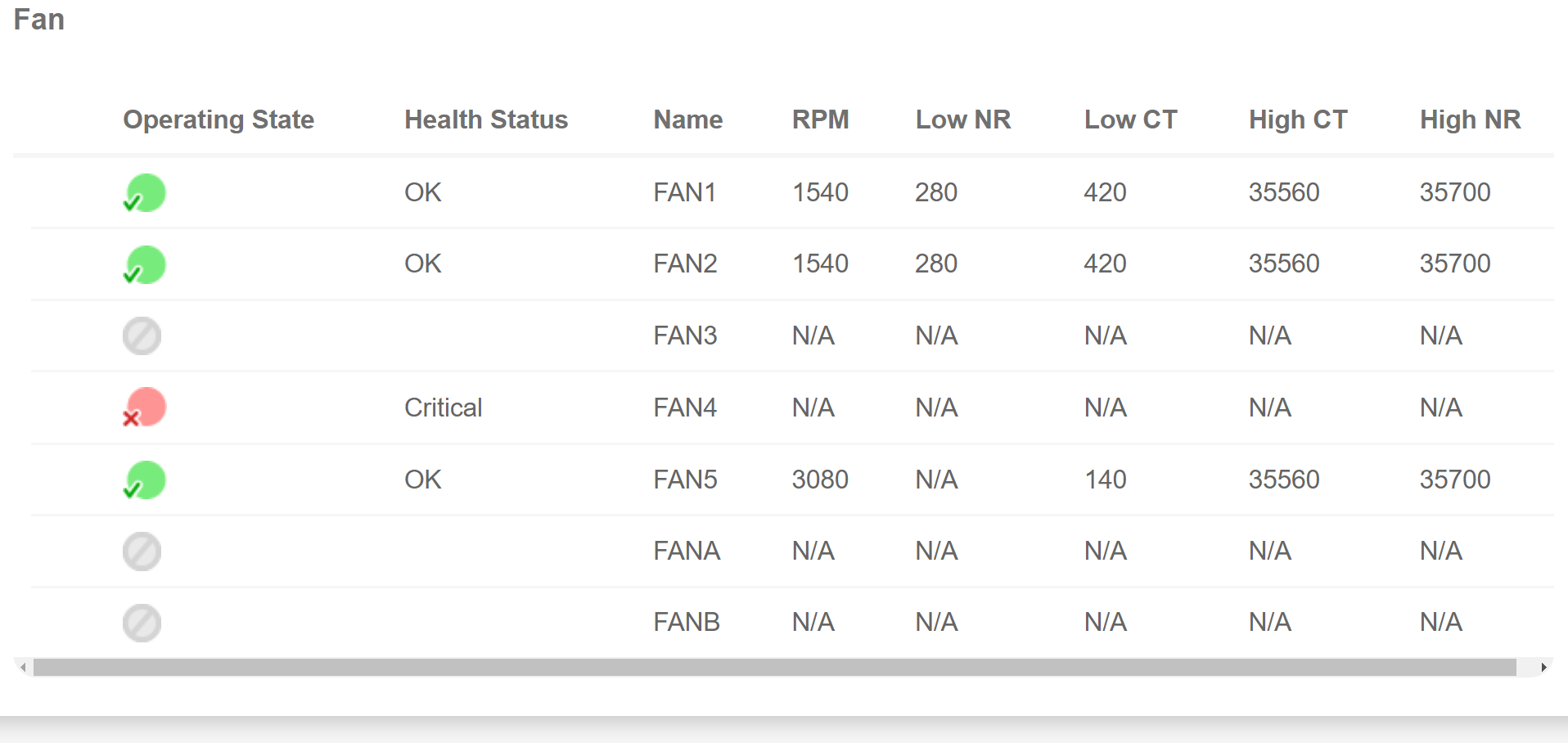

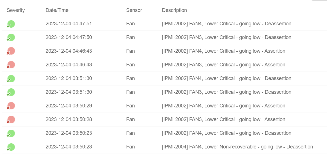

The IPMI web app also doesn't report any logs other than the fans spinning down, but those errors have shown for over a year even with an ASRock Rack motherboard.
