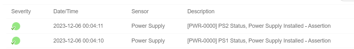

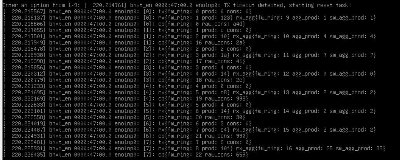

This was enough to cause it to reboot:
A few seconds after performing this task, that's when it rebooted. Is there something telling it "after writing a file, go ahead and force-reboot the system"?
An Optane metadata vdev with a SSD pool? That's borderline crazy.
You have not fully described your system and how everything is wired and powered. From the symptoms, it could be that there's enough power for reading but not for writing.

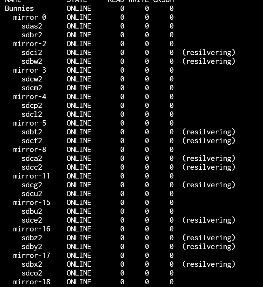

# zpool status -vL
pool: Bunnies
state: ONLINE
scan: scrub repaired 0B in 08:58:36 with 0 errors on Wed Dec 6 14:05:11 2023
remove: Removal of vdev 1 copied 1.79T in 1h37m, completed on Tue Oct 31 07:02:38 2023
955M memory used for removed device mappings
config:
NAME STATE READ WRITE CKSUM
Bunnies ONLINE 0 0 0
mirror-0 ONLINE 0 0 0
sdch2 ONLINE 0 0 0
sdcp2 ONLINE 0 0 0
mirror-2 ONLINE 0 0 0
sdfc2 ONLINE 0 0 0
sdw2 ONLINE 0 0 0
mirror-3 ONLINE 0 0 0
sdg2 ONLINE 0 0 0
sdi2 ONLINE 0 0 0
mirror-4 ONLINE 0 0 0
sdfj2 ONLINE 0 0 0
sde2 ONLINE 0 0 0
mirror-5 ONLINE 0 0 0
sdfo2 ONLINE 0 0 0
sdaa2 ONLINE 0 0 0
mirror-8 ONLINE 0 0 0
sdae2 ONLINE 0 0 0
sdff2 ONLINE 0 0 0
mirror-11 ONLINE 0 0 0
sdfi2 ONLINE 0 0 0
sdz2 ONLINE 0 0 0
mirror-15 ONLINE 0 0 0
sdfp2 ONLINE 0 0 0
sdfe2 ONLINE 0 0 0
mirror-16 ONLINE 0 0 0
sdh2 ONLINE 0 0 0
sdfr2 ONLINE 0 0 0
mirror-17 ONLINE 0 0 0
sdv2 ONLINE 0 0 0
sdfg2 ONLINE 0 0 0
mirror-18 ONLINE 0 0 0
sdfh2 ONLINE 0 0 0
sdfd2 ONLINE 0 0 0
mirror-20 ONLINE 0 0 0
sdf2 ONLINE 0 0 0
sdfq2 ONLINE 0 0 0
mirror-24 ONLINE 0 0 0
sdk2 ONLINE 0 0 0
sdcq2 ONLINE 0 0 0
mirror-26 ONLINE 0 0 0
sdad2 ONLINE 0 0 0
sdd2 ONLINE 0 0 0
mirror-27 ONLINE 0 0 0
sdco2 ONLINE 0 0 0
sdca2 ONLINE 0 0 0
mirror-28 ONLINE 0 0 0
sdcn2 ONLINE 0 0 0
sdal2 ONLINE 0 0 0
mirror-29 ONLINE 0 0 0
sdce2 ONLINE 0 0 0
sdn2 ONLINE 0 0 0
mirror-31 ONLINE 0 0 0
sdeh2 ONLINE 0 0 0
sdan2 ONLINE 0 0 0
mirror-32 ONLINE 0 0 0
sdcg2 ONLINE 0 0 0
sda2 ONLINE 0 0 0
mirror-33 ONLINE 0 0 0
sdc2 ONLINE 0 0 0
sdb2 ONLINE 0 0 0
mirror-34 ONLINE 0 0 0
sdcb2 ONLINE 0 0 0
sdp2 ONLINE 0 0 0
mirror-35 ONLINE 0 0 0
sdcf2 ONLINE 0 0 0
sdq2 ONLINE 0 0 0
mirror-36 ONLINE 0 0 0
sdfb2 ONLINE 0 0 0
sdao2 ONLINE 0 0 0
mirror-37 ONLINE 0 0 0
sdai2 ONLINE 0 0 0
sdcv2 ONLINE 0 0 0
mirror-38 ONLINE 0 0 0
sdcl2 ONLINE 0 0 0
sdaq2 ONLINE 0 0 0
mirror-39 ONLINE 0 0 0
sdap2 ONLINE 0 0 0
sdfk2 ONLINE 0 0 0
mirror-40 ONLINE 0 0 0
sdfn2 ONLINE 0 0 0
sdfl2 ONLINE 0 0 0
mirror-41 ONLINE 0 0 0
sdfm2 ONLINE 0 0 0
sdcj2 ONLINE 0 0 0
mirror-42 ONLINE 0 0 0
sdcm2 ONLINE 0 0 0
sdck2 ONLINE 0 0 0
mirror-43 ONLINE 0 0 0
sdj2 ONLINE 0 0 0
sdah2 ONLINE 0 0 0
mirror-44 ONLINE 0 0 0
sdde2 ONLINE 0 0 0
sdcu2 ONLINE 0 0 0
mirror-45 ONLINE 0 0 0
sdcs2 ONLINE 0 0 0
sdeo2 ONLINE 0 0 0
mirror-46 ONLINE 0 0 0
sdaj2 ONLINE 0 0 0
sdu2 ONLINE 0 0 0
mirror-47 ONLINE 0 0 0
sdt2 ONLINE 0 0 0
sdac2 ONLINE 0 0 0
mirror-48 ONLINE 0 0 0
sdaf2 ONLINE 0 0 0
sdcd2 ONLINE 0 0 0
mirror-49 ONLINE 0 0 0
sdci2 ONLINE 0 0 0
sdak2 ONLINE 0 0 0
mirror-50 ONLINE 0 0 0
sdam2 ONLINE 0 0 0
sdcc2 ONLINE 0 0 0
mirror-51 ONLINE 0 0 0
sdo2 ONLINE 0 0 0
sdep2 ONLINE 0 0 0
mirror-52 ONLINE 0 0 0
sdr2 ONLINE 0 0 0
sdag2 ONLINE 0 0 0
mirror-53 ONLINE 0 0 0
sdl2 ONLINE 0 0 0
sdm2 ONLINE 0 0 0
special
mirror-13 ONLINE 0 0 0
nvme1n1p1 ONLINE 0 0 0
nvme0n1p1 ONLINE 0 0 0
mirror-14 ONLINE 0 0 0
nvme3n1p1 ONLINE 0 0 0
nvme2n1p1 ONLINE 0 0 0
spares
sds2 AVAIL
errors: No known data errors

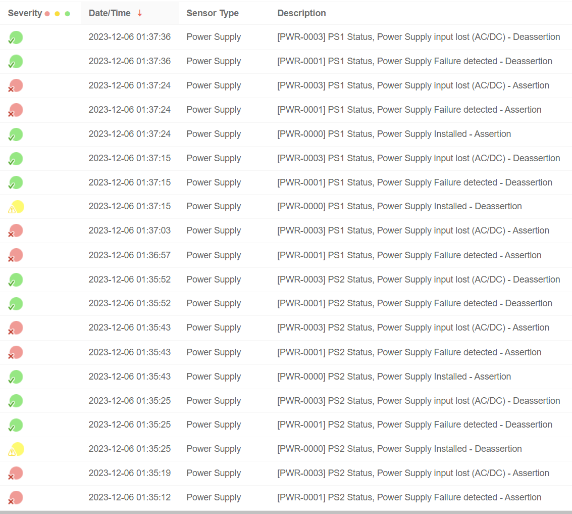

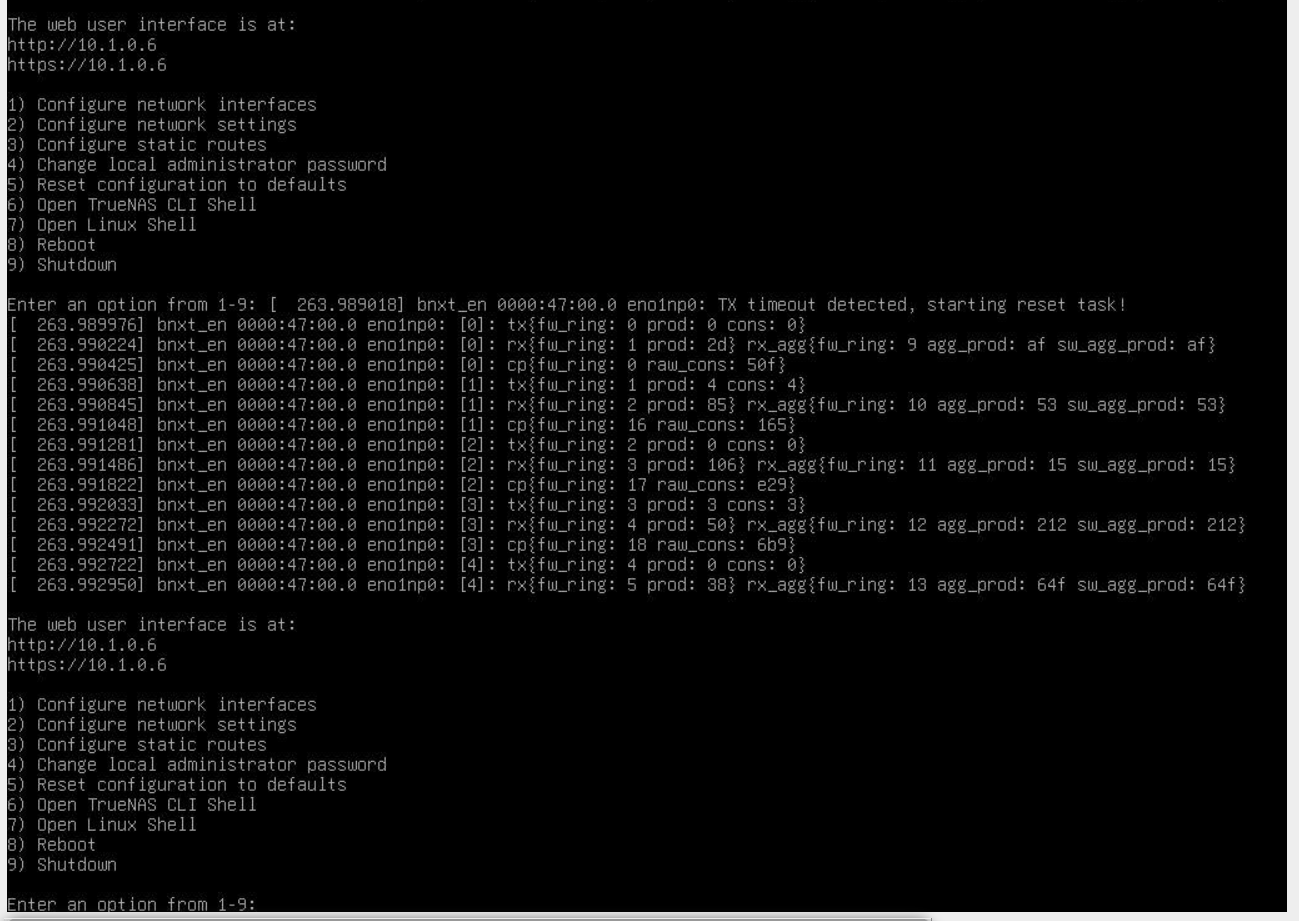

Summary of the reboot issue
Bunnies is the one that has the force-reboot issue when writing to it. This began happening 3, maybe 4 days ago now?
I thought it was a power issue
2 days before, I had already removed 15 SSDs that I currently wasn't using. After it started happening, I thought it was a power issue, so I removed 48 SSDs (of 85), but still had the problem.
I already planned to add 128 SSD bays in here for my 123 SSDs, so I completely redid the power wiring and removed every one of the 128 SSD slots from the +5V rail on the PSUs. Also note, I swapped the PSUs in this server with the one in the other Storinator XL60 chassis, again, thinking power was the issue.
I thought it was a heat issue
At some point, I noticed heat issues because I shifted all the fans to Noctua NF-12s during this 128 SSD bay transition. I put them all back to stock, and the heat issues went away. Still, I removed the ConnectX-6 card, and the reboots became less frequent.
I only recently found out why:
The
real problem occurs
when writing to Bunnies.
Because my PCs backup their data every 12 hours and on idle, when I stepped away from one, it would start writing data to Bunnies; forcing the reboot situation. When I removed the ConnectX-6 and switched to the onboard NICs, the DNS hostname didn't match, so I could only access my NAS by IP. Because of this, my Windows boxes stopped backing up, lengthening the time between reboots to whenever my snapshots ran.

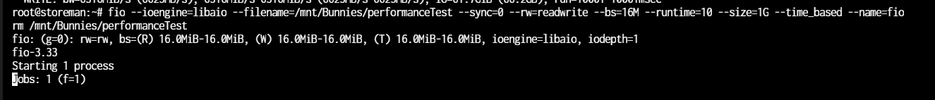

It was the writes
Based on the fact that reboots started occurring about every hour, it was pretty clear those were causing forced reboots since
I take hourly snapshots.

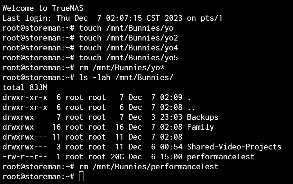

After disabling all snapshots and backup tasks, and now since Windows can't access the NAS, it was able to successfully stay on for over 10 hours doing a `zpool scrub`. I'm 100% certain now that writes are the issue and only to the Bunnies pool.
I'm not yet certain if the issue is physical (NVMe or SATA SSDs) or TrueNAS.
How to figure out what's wrong?
Is there a zdb way I can check this out? If it's just a corrupt pool, I already planned to nix it and convert it to dRAID, but I need to first move off some more recent snapshots. That requires manually running `zfs send` to Wolves.
