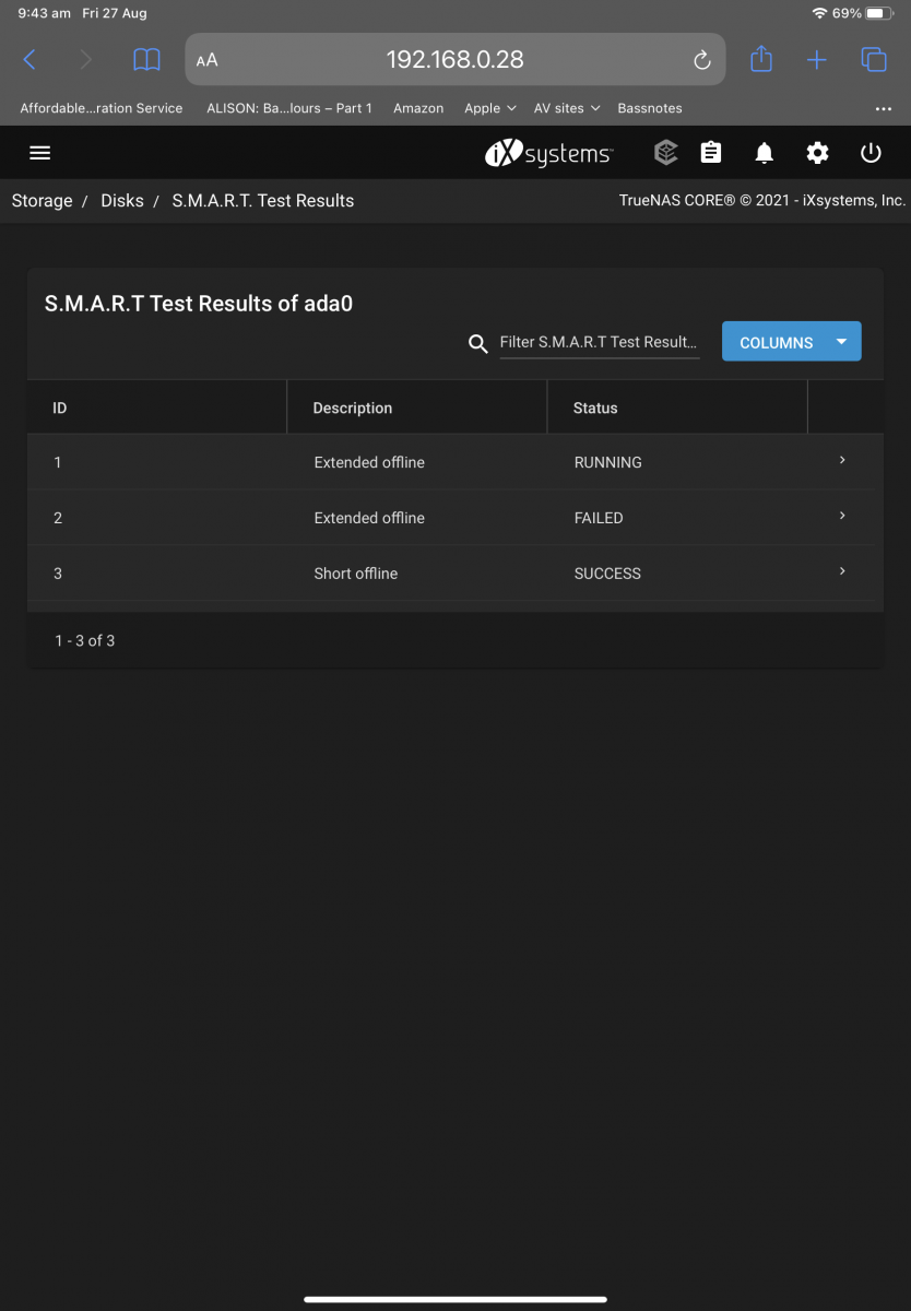

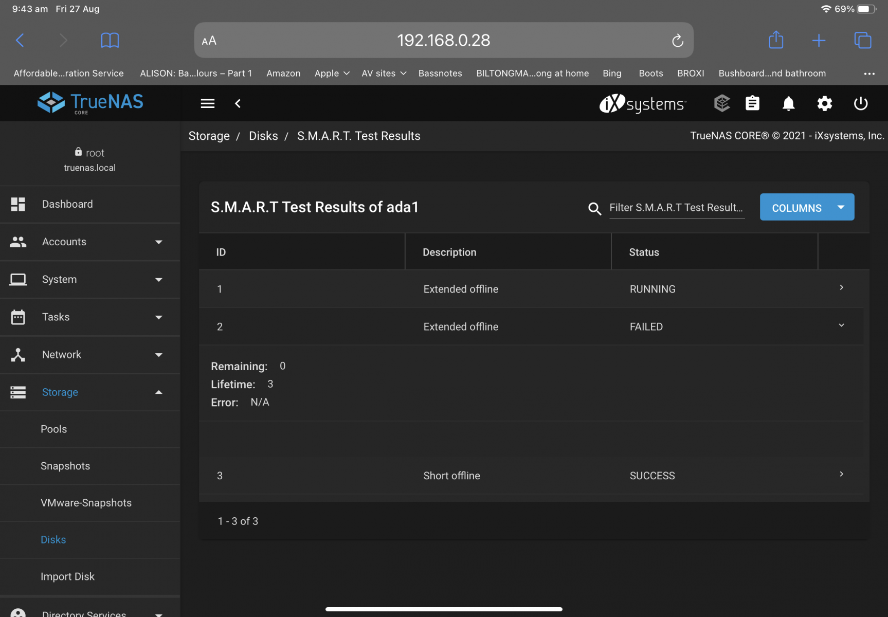

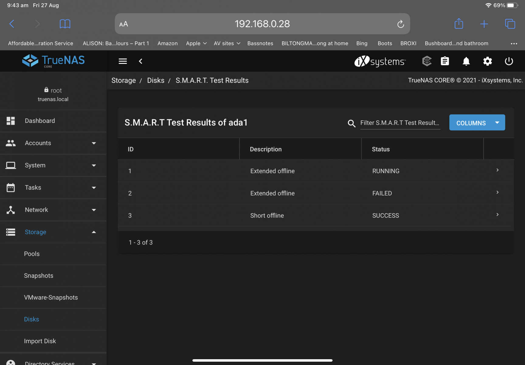

Truenas keeps reporting smart errors
Robti
Aug 2, 2021
58
Had a couple of drives from my whs 2011 that worked ok with no errors so wiped them and did a full smart scan with no errors so fitted to my self build truenas and right away getting smart errors, so pulled them and fitted a couple of new ironwolfs which I smart scanned before fitting and they came out error free, so set up and set the smart task to scan them overnight and this morning errors, so does truenas scan differently from Windows or what, any help please .
Thanks

So every drive you have has failed a long test. Please post full output for each drive of
smartctl -a /dev/adaX where X= 0, 1, 2
Thanks will do as you ask, I should also say I did a chkdsk /f/r/x on them when the first errors appeared with passes
