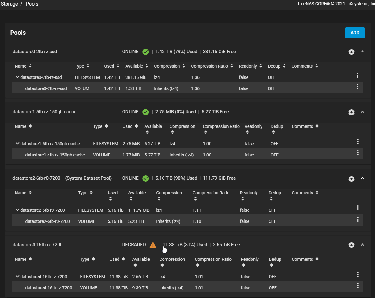

I recently moved from FreeNas to TrueNas and went to build a new pool to pass to my vmware cluster but something about the new pool isn't working as expected. I have 3 other ISCSI mounts from the same TrueNas Server that have no problems.
I created a new Pool/zvol: https://i.imgur.com/1roJscH.png
I added it to my existing portal/target/extents to match my 3 other ISCSI volumes
The device shows up in the ISCSI vmhba after a refresh, but shows 0 capacity and I have no idea why: https://i.imgur.com/eXzma3q.png

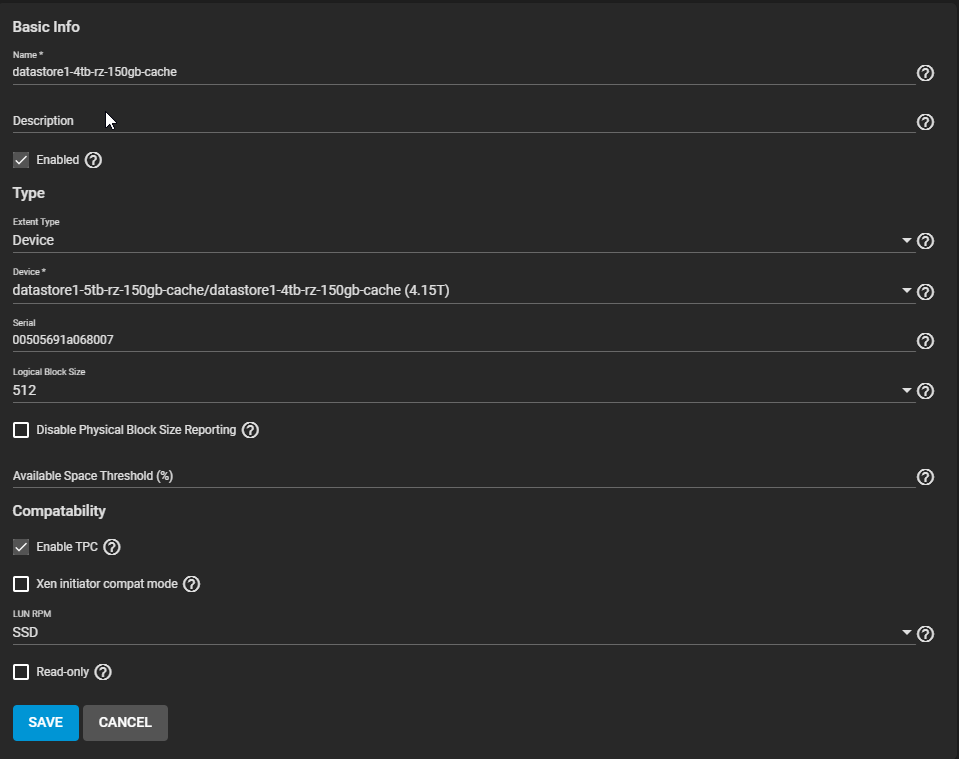

Can you post your iSCSI target and detailed ZVOL information? Embeds are preferable to links, because imgur mutilates images on mobile (webp compression to 640 wide)
My offhand guess is to check the "hide physical block size" option.

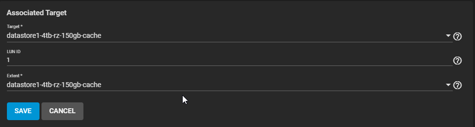

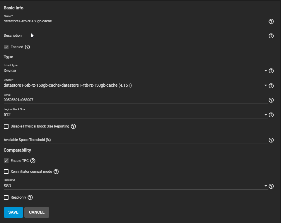

Well I've run into a new issue where any time I try and edit a zvol to look at the settings it always opens a different zvol...
Datastore settings:
Extent:
target:

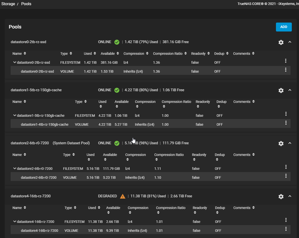

So I did some more testing.
Passed a non-pool/non-zvol via iscsi. Worked as expected
I connected to the truenas from a windows computer and was able to mount the cached drive I'm having trouble with but could not initialize it, showed an unknown amount of storage.
I demolished the pool and recreated it with the same mirrored cache and ran into the same problem.
I demolished the pool and recreated it without the mirrored cache, just 3 disks and didn't have any problems.
dacheat
Jun 8, 2021
4
Doesn't seem like I can edit my previous post.
I demolished the pool and recreated it with a single striped cached drive, ignoring the warnings about data loss and that seemed to work as expected as well. Seems like there's actually a problem with one of the drives I'm passing into the mirrored write cache, if I try and mount that as it's own iscsi target it has the same 0 space problem.
