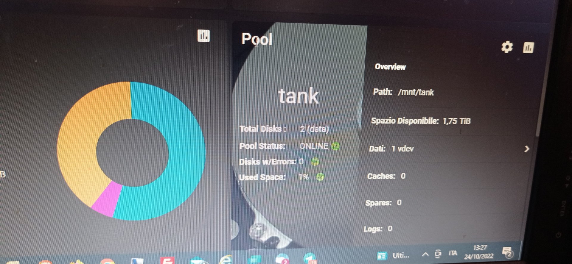

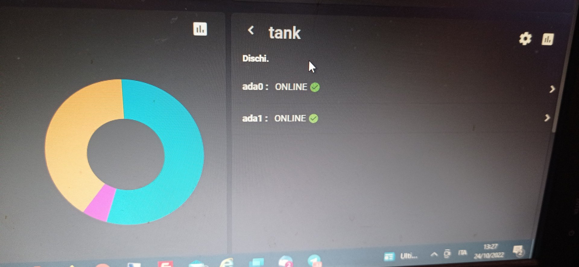

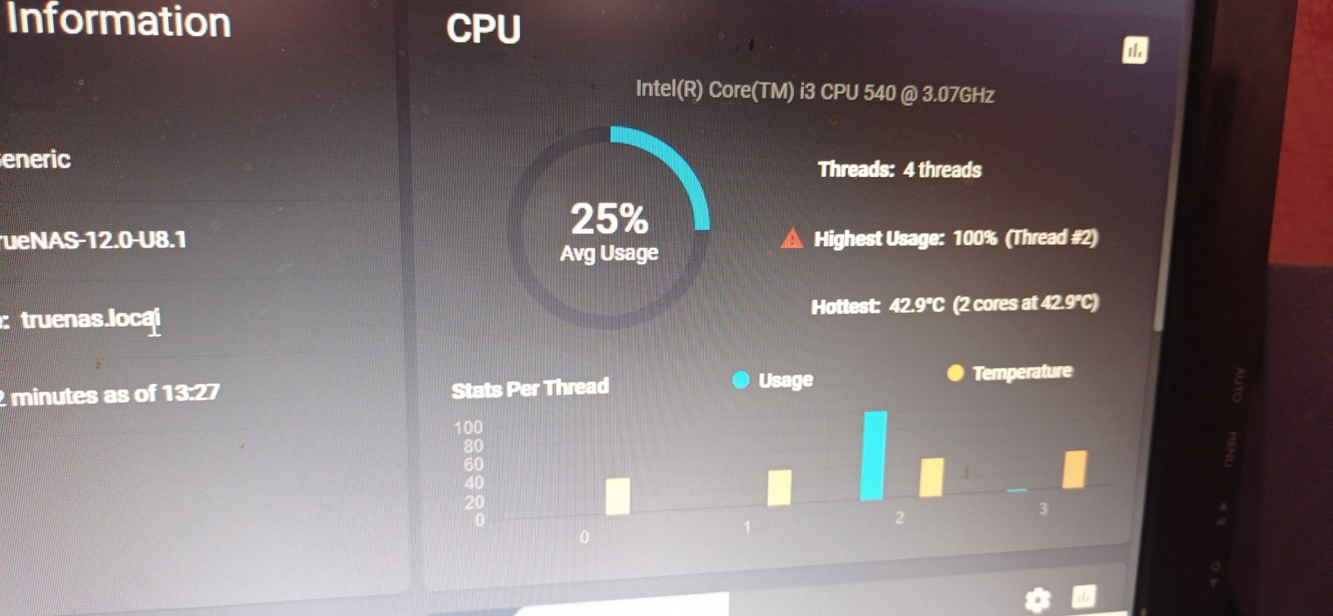

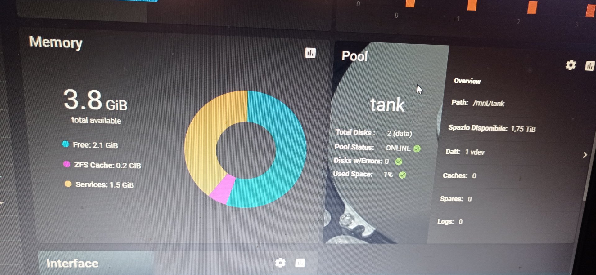

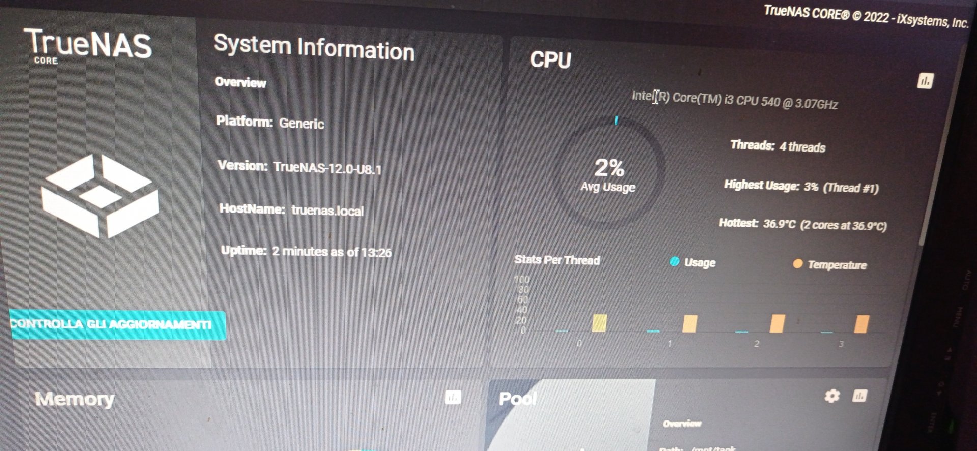

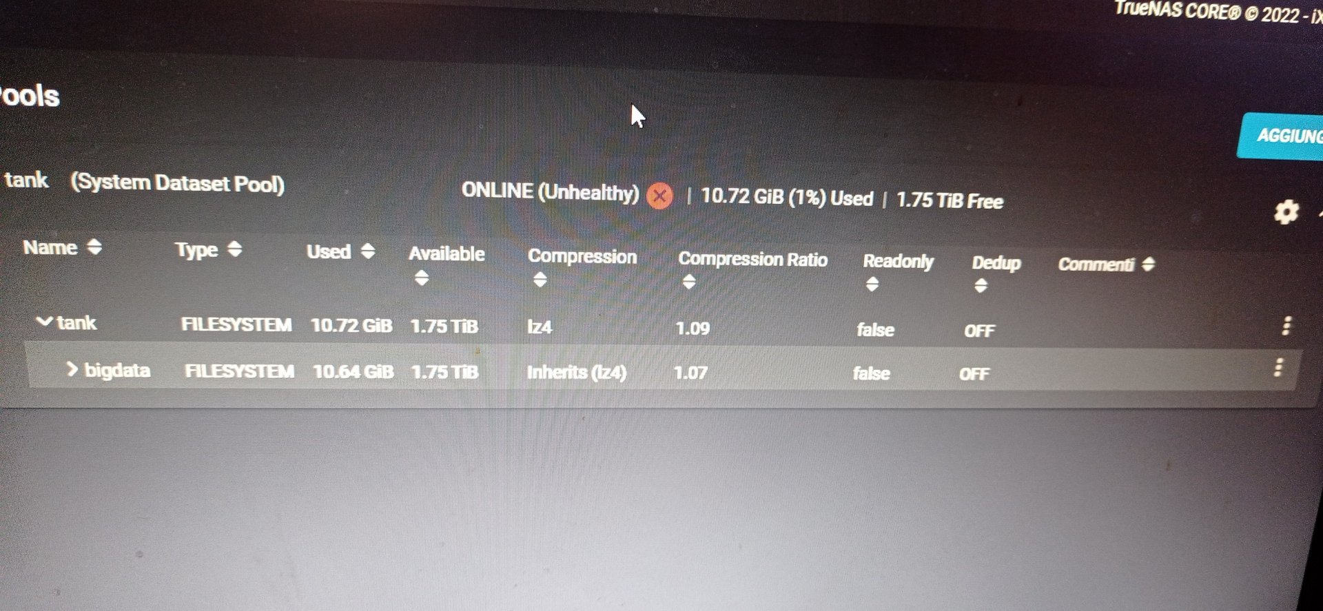

Hello everybody, i've got a truenas that Is freezing After about 2-3 minutes from when It Is online. After 2-3 minutes, the cpu star working hard and the Nas stop replying! The administration Page remain stuck and reply no more. I watched the notifications and It talked about a disk with 8 errors.
In the Nas there are 3 disks: 1 Is for the OS, and 2 disks are in mirroring.
It's strange because now in the notifications i can't find again the messages about the 8 errors on dev ada0.
You can see all the datas of the computer (processor, RAM and truenas version), in the attached pictures that i tooked in the 2-3 minutes the Nas Is Active and working.
I've got the urgent problem to recover the data now, they are important and i have no fresh backups.
Thank you for your attention and help! (If it's possible or course).

Hello jgreco, thank you for your reply. Actually i can't understand how i can see the other details about the hardware. It Is a normal computer with a i3 540 processor and 4 gigabytes of RAM. Maybe i can disassemble It and see what motherboard model It has, if it can help.

Are you sure this Is the problem?
No, I'm not *sure* it is the problem, but the middleware itself has been known to consume 4-6GB of memory at times. Usually if the system goes semi-catatonic, it is a sign that something critical has run into some sort of major roadblock. Without actually seeing your system and poking around on it, it is difficult to know for certain what that is. The most reliable debugging strategy here on the forums has been to look for things that are out of wack, and then fix them, until the system works as expected.
Usually when you have too Little RAM, the computer become more slow but without freezing.
That's highly dependent on what is actually happening. Userland processes may start getting swapped out, which could result in the "more slow" you're expecting, but kernel resource starvation can lead to all sorts of weird problems, including the NAS going catatonic (pingable but otherwise frozen) or completely frozen.
Considering that It seems that there Is a problem with One of the two hard disks, is there a method to save the datas contained in the healthy One?
Attaching the disks to a different system, you should be able to import the pool (do NOT try to create a new pool!!!) and your data should still be fine. You have a mirror vdev setup and it is designed for this exact circumstance.
Oh I must've missed this over the years. I've always thought it was 8 GB min, and 16 GB recommended.
You're correct. It was probably about a decade ago now that I raised the documented minimum memory requirement to 8GB. At that time, dipping below 8GB was hazardous and sometimes resulted in damaged pools, etc. It isn't entirely clear to me why this was raised to 16GB, though it is safe to say that the middleware has gotten fatter and with RAM being fairly cheap, it's certainly a good idea to have more. I suspect that on a small system with no services, jails, VM's, etc., that one might still be able to get away with 8GB. But not 4GB.

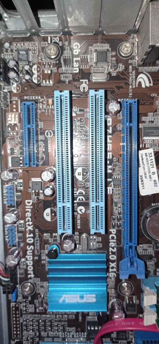

In the meantime i disassembled the computer. The motherboard Is an Asus p7h55-m/le .
I read in some posts that there are Also things in the BIOS that maybe i must to activate or deactivate?
Perhaps. However, since you're not using anything that resembles recommended hardware, this puts everyone at a disadvantage. What I can tell you is that, as an older 2010-era board, there are some things that might not work correctly.
Asus seems convinced that the unit will only accept 8GB of RAM, and Crucial's memory configurator agrees.
Further, as it is a desktop board, it has a Realtek ethernet chipset that is certain not to work at peak performance. I suspect you can get basic functionality out of it by putting the 8GB RAM in, but even with that, it isn't going to be awesome.
If it were mine and here in the shop, I would try some 8GB sticks in it just to see if you could make it work on 16GB.

Since you are running a system that is 10+ years old that has worked well so far, chances are that some piece of hardware has finally given up. The PSU would be my prime suspect, probably together with the motherboard. A freeze is usually an indicator of a hardware issue, especially if the setup has worked so far.
